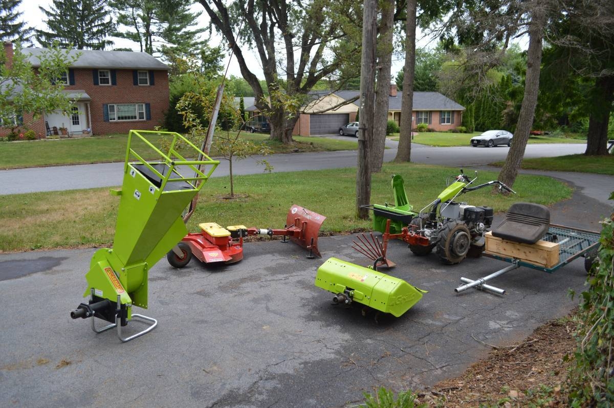

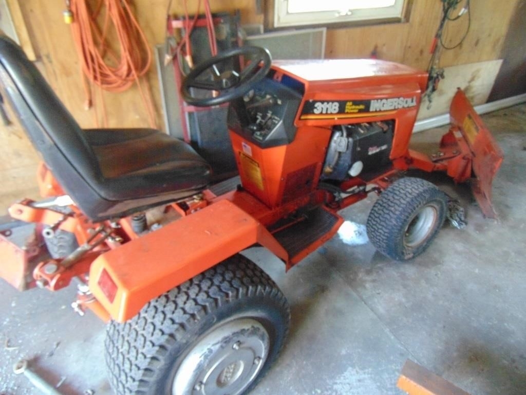

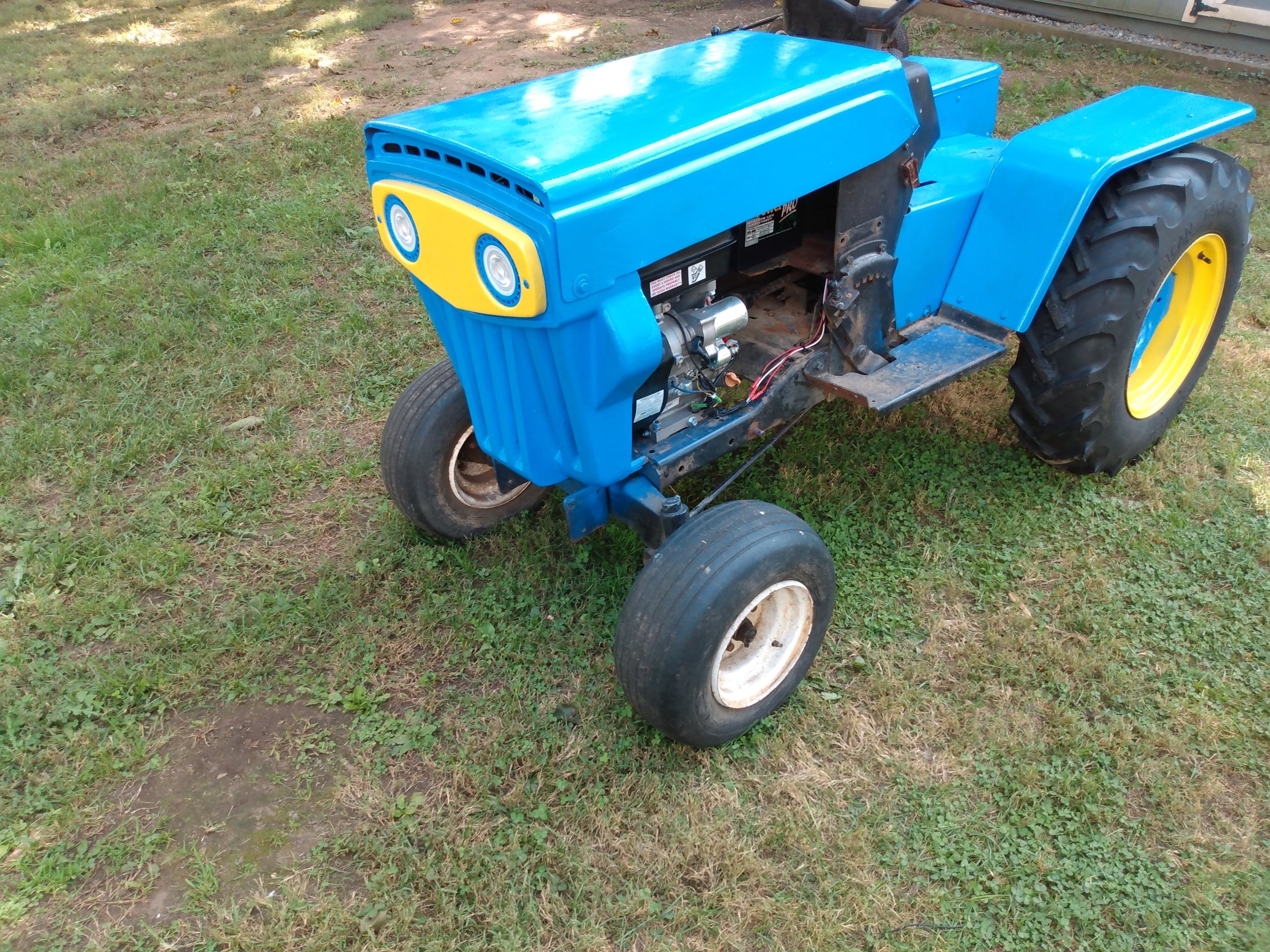

For everyone else, I am sorry, you do not need a 2000lb+ machine for a 5000 sq ft kitchen garden. I owned a 25 HP diesel SCUT with a cat 1 hitch, a loader and backhoe when I had 5 acres. I used it for maintaining the property, but even then I only had a kitchen garden, and it sucked to maneuver it in there, so I kept a garden tractor for that. Now that I have only 1.25 acres, I sold the SCUT but still have a garden tractor. I used to own an 11 hp two wheeled tractor (Grillo 107D) that pulled a potato plow without a problem. It has a lot of implements available for it (I only sold it because an old shoulder injury made it hard to use as I got older). I have an 800lb 1972 MTD 990 that I threw a 13hp Predator into, just to pull cat 0 implements through the garden (moldboard plow, discs and a tollbar with tines or hilling discs.) I used it for a few years until a few months ago a part of the lift wore out that I cannot find a replacement for. It will still pull implements, just not lift them very well. I just got a smaller 725lb Ingersoll 3018 with an 18hp Onan, because parts are still available for it.

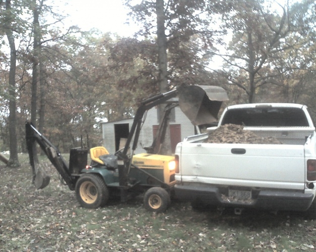

Another garden tractor I used to own was a 1994 Yardman 998. It was 18hp and had a loader and a backhoe from Kwik-Way. Someone offered to buy the tractor for way more than I had in it, so I said yes and got the SCUT. I also had a matching White GT1855 (same thing just grey). I used it for mowing, working the garden and I had a cat 0 48" box blade for it that I used to maintain about a 1/4 mile dirt driveway. It worked well so I never got a box blade for the SCUT. At the time, a Cat 1 Box blade would have cost more than I paid for the tractor. I sold it when I moved and got the Grillo.

For the pics or it didn't happen crowd, here are some of the machines I have owned. The yardman, I took the picture because someone asked me the lift height on the loader. The Grillo, I made the cart for it out of a Tractor Supply wagon. The 990 (blue tractor) I took the picture after painting it (backyard rattle can job), before putting the seat and new front tires on it. The Ingersoll is where I bought it before bringing it home.

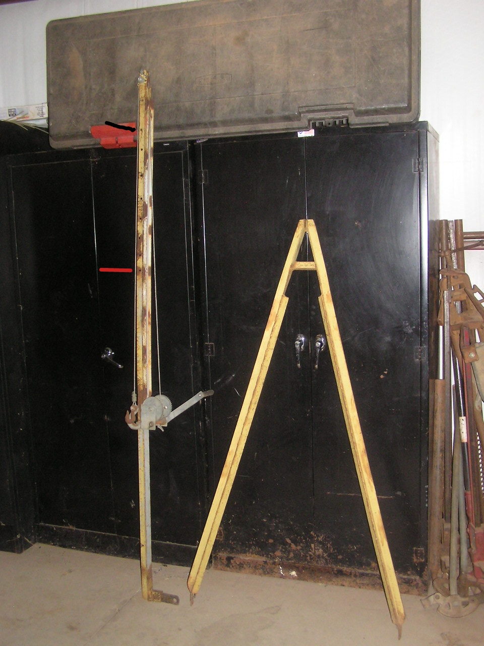

A boom pole maybe 4' long with a 100 or 200 lb capacity would be nice.
I made an A frame adjustable lift pole with a hand crank for my Craftsman Garden Tractor:
The pole is 82 inches long with holes to change the angle.
Yes, see? Small capacity things like this can be really useful, and might be all that somebody needs.
In a similar vein, I've wished for a small hand powered winch with a capacity somewhere in the neighborhood of 50 lbs, for jobs like lifts that are too awkward for a human, like lifting things at arm's length, or lifting things in awkward spaces, or adjusting the height of subassemblies that are not high precision. I had a subassembly that weighed about 30 lbs, needing to be gently raised and lowered and tweaked into place in the middle of a complicated setup and there was just no right way to do it.
