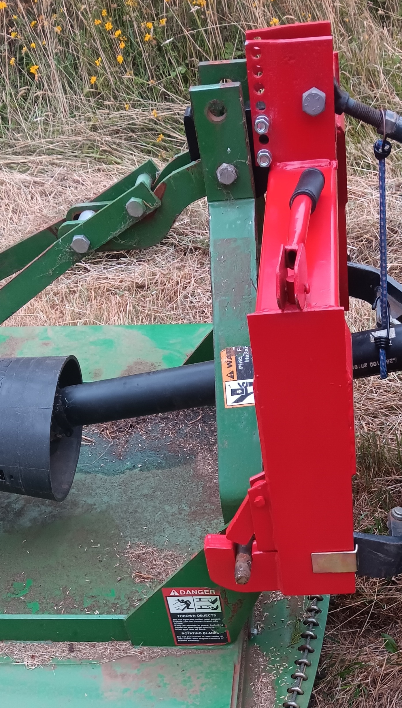

so I am considering a quick hitch, looking through the comments it appears I need bushings per attachment? people are saying they are cheap, but quick hitch bushing can be upwards of 40 dollars, people in the threads are mentioning 1 dollar per bushing I am not seeing, that can someone shed some light?
This is the hitch I am looking at.
I found it was a lot easier to just get a Cat 1 quick hitch. I got mine from Good Works Tractor and it works well. No need to keep moving bushing from one implement to another and no need to buy tons of bushings.

I had the bushings on my implements when I owned a JD subcompact. When I traded up to a L5460 Kubota, my choice was the hitch that did or did not need the bushings. I stuck with the bushings because the end lips of the bushing limits side slide of the implement. The hitch was also cheaper as Kubota has mostly moved on from the larger lower.
   / cat 1 quick hitch bushings needed #29
I have a similar quick hitch but I had to modify the top link attach point on most of my implements to make it work.

I installed this "cat 1 E" (no bushings) QH today on my Massive Ferguson GC2300 SCUT. I only have the Frontier 2048 and a box blade, both with the small pins. $200 at Trac Sup. On the box blade I have to clearance the pin nuts a little, and add a larger spacer on top, or make a thinner hook. Apparently not QH compatible, yet. https://www.tractorsupply.com/tsc/product/tooltuff-direct-cat-1-e-quick-hitch-25-040
   / cat 1 quick hitch bushings needed #31
I installed this true cat 1 (no bushings) QH today on my Massive Ferguson GC2300 SCUT. I only have the Frontier 2048 and a box blade, both with the small pins. $200 at Trac Sup. On the box blade I have to clearance the pin nuts a little, and add a larger spacer on top, or make a thinner hook. Apparently not QH compatible, yet. https://www.tractorsupply.com/tsc/product/tooltuff-direct-cat-1-e-quick-hitch-25-040
JUST so people know it goes against industry standard for QH...
