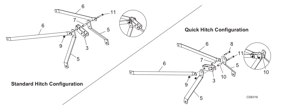

IMHO the RK cutter with 3 pt centerlink attaching hinged bracket hanging down in photo below will not allow correct utilization of a quick hitch that has centerlink cutter attaching connection. QH utilization will stop or limit rear tail wheel from raising when a hump or berm is crossed by tail whee because hinge linkage on cutter can't hinge with HF QH attached. I think Pat's QH is a better choice than HF QH because I've owned both but now strictly utilize Pat's QH. I think one can mount 3 pt Cat l (7/8'' dia.)pins aimed inside of brackets for correct Cat l lower pin spacing.
This is one way to fix the flex problem with a quick hitch.

If you look at pic real close the right hand side pin probably can be reversed, on left hand side the gusset on vertical arm blocks pin from being reversed, I would cut the gusset out and move it to back side of arm and then you can expose pin of left hand side.... Note, they used same bracket on both left and right side of "A" frame, so on one side pin location is exposed (right side) and then bracket on other side (left) is reversed blocking pin hole access..... I would also consider removing the top link and consider using chain as top link...

It’s just the way the pic is, both pins are blocked on the inside, same upright brace on each.

Ok, I moved the verticals back to the holes further in like the one gentleman suggested ( #5 in pic ) - This allowed the pins to be extracted and installed inwards. This absolutely lines up with the quick hitch now.
Now for the top link/ The HF QH is a cat 1. The top link hook is about 10" too low to attach to this KK cat 2 top, even with the hook moved all the way up. So today I cut the HF original top line plates off with a slicer, ground smooth, and made two new plates out of 1/2" plate, with holes that run up to 14", about double what was there. welded these back into place with 7018 1/8" 4 passes in and out. Put the top link hole back where it belongs. Put the top hook back on at the level is needs to be at, and will try to fit tomorrow and see what happens. If it works, ill send some pics.
