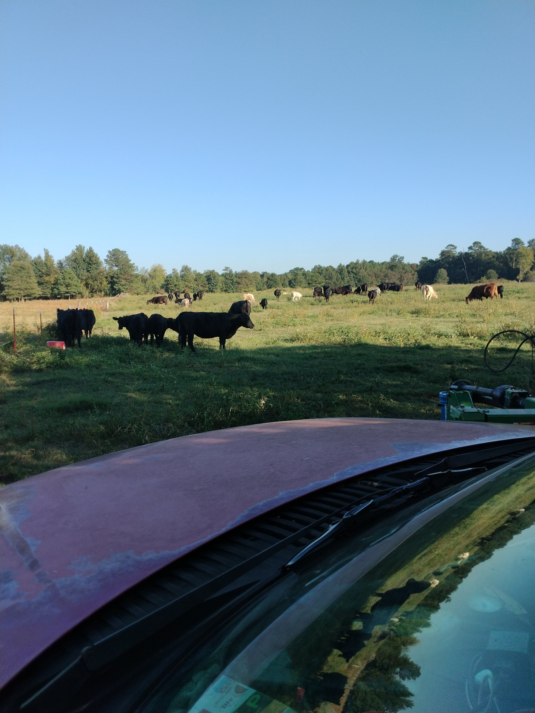

Big track hoe can clear land fast. Raise that bucket, push trees over, stack out of the way. I know you just have stumps, and they are quick work on them. Sweep dirt back in hole, on to the next. You want to sweep dirt back in so it'll be smoother for the tractor. Picture is 100 acres done with track hoe and tractor with offset disc.
