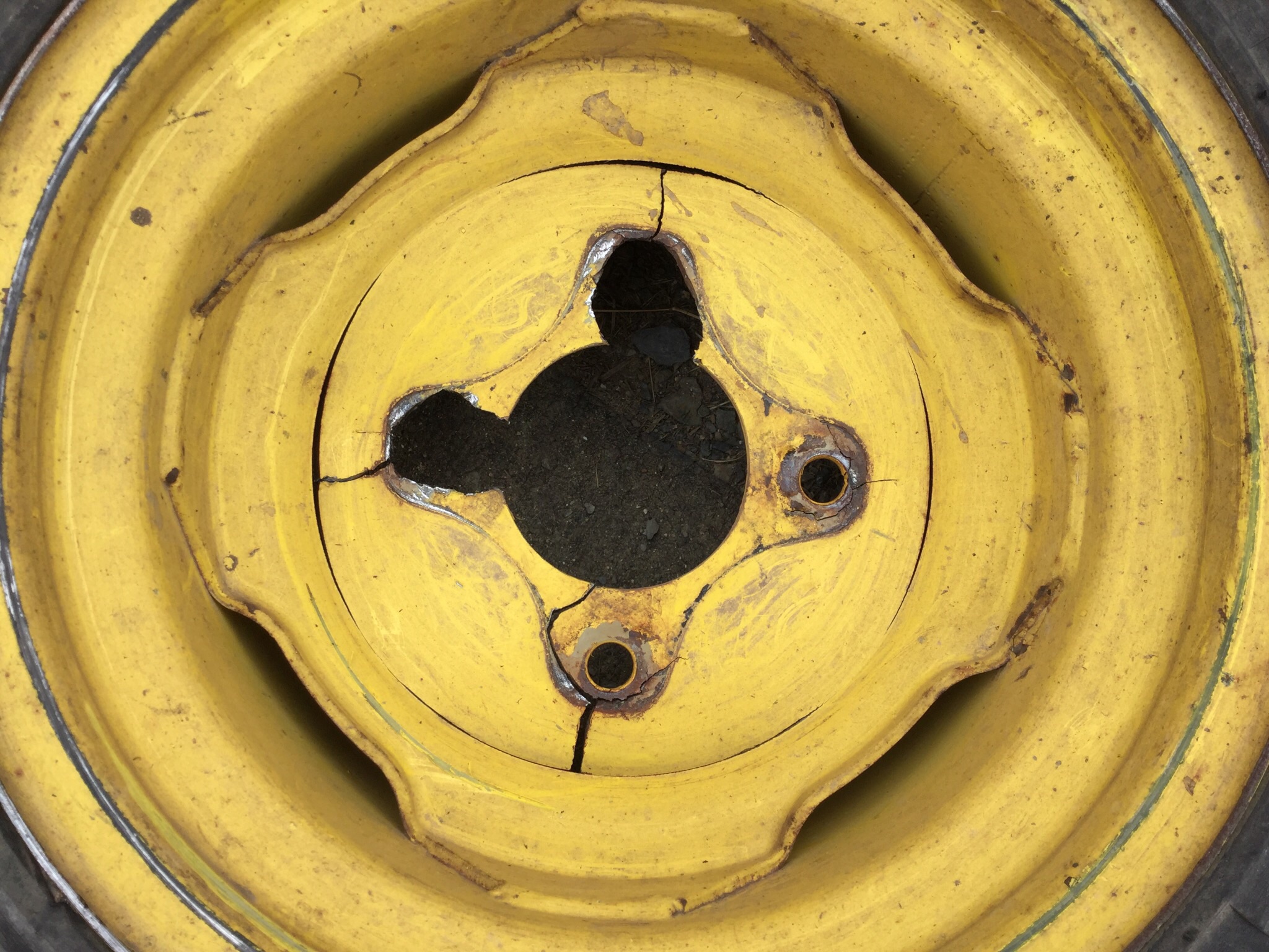

My 2010 JD 2720 had a new twist yesterday that I have never seen the likes of.
I was working a small pile of dirt from one spot to another when I notices a wobble
on my left front wheel. Stopped and set the load down to inspect, and could not
believe what I was looking at. The rim had split in several places fronm the lug nuts
outwards, and around the outer edges if the inner rim plate. Has anyone seen this before ?
And, what could be the cause of such a failure???

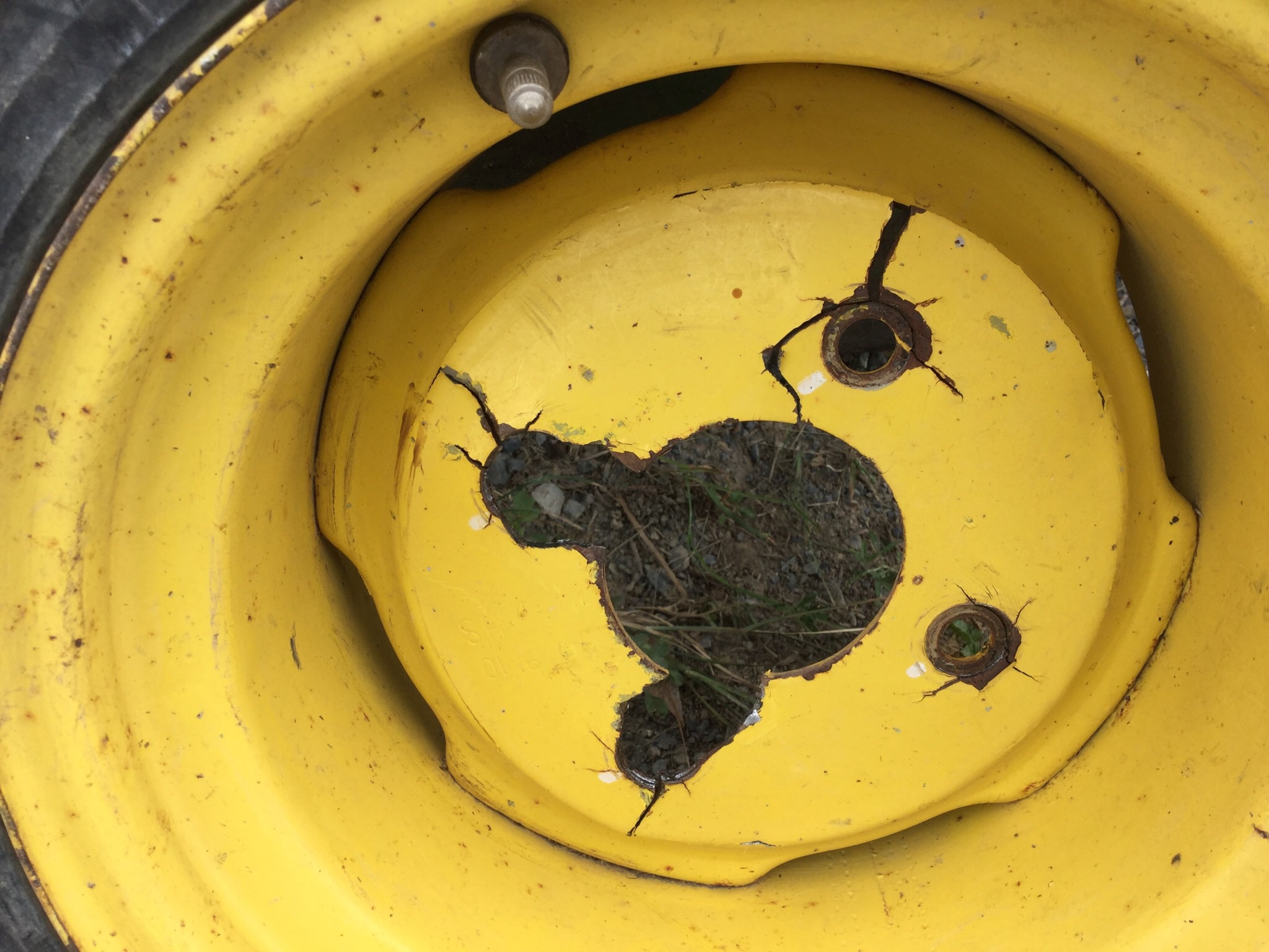

From your second picture which shows the circular break at the junction of the pressed bend to offset the rim, I think the design/fabrication of the rim is also at fault. The sharp bend creates a stress riser in the metal that fatigues more easily than a rounded bend area.
If you have the inclination, take those rims, cut out the inner circle and replace with much thicker metal that you would then weld back to the outer rim. If you have a machine shop that could press a dish pattern into the thicker metal to match the required offset that would be great.

Even with the lugs tight, that rim broke due to flexing, which fatigued the rim to failure over time.
Maybe the rim just wasnt built heavy enough for this application.
Good thing is no one hurt and it sounds like no property damage.
Agreed, junk rim was flexing under load, work hardened and cracked. You can see some rusty spots of prior cracking/older damage. More it cracked the weaker it got till it cascade failed.

...And, what could be the cause of such a failure???
There is a sure clue that something is going wrong in your pictures.
There is a witness mark in white paint on the heads of the lug bolts. This was placed when the lugs were originally torqued.
Now look at the wheel. The white paint is carried over onto the wheel, but the witness marks do not line up. This means that the lugs have rotated out.
If you know to look for this, you can determine whether the lugs are tight just from a casual inspection -- no tools required.
My 110 TLB has these witness marks on many of the bolt heads all over the machine.

Good points Kthompson, and all worth looking back at
However , these wheels were off a year ago for new tires and well inspected before re installing them. Now I did have a load in the loader when it failed, but I can see that this took some time to happen. maybe it was just bad steel?? WTC steel back from China?? who knows, but I am seeing what looks like hair line cracks on the right side and those lug bolts are tight. I will take them off and inspect the inside of the wheel tomorrow just to be sure!
