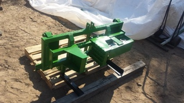

   / Category 2 implement on a category 1 tractor #13
Have you looked at one of these yet?
If I recall correctly it ended up being the implement used in the project in this thread:
...which may be something of a similar task to what you're looking to do?
Otherwise a SSQA-mounted puller combined with a 3pt to SSQA adapter (like this one by ATI: Change your 3 point hitch to universal quick attach) may be another option..

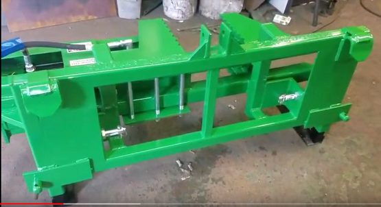

   / Category 2 implement on a category 1 tractor #14
I couldn't find any 3 point mounted tree pullers in my size range that looked at all capable. Do you guys have any suggestions?
Galen Koeckeritz makes them to fit either end, or in your case the rear end:
Website: Custom built Skid Steer attachments to fit almost any need you may have.<br />
