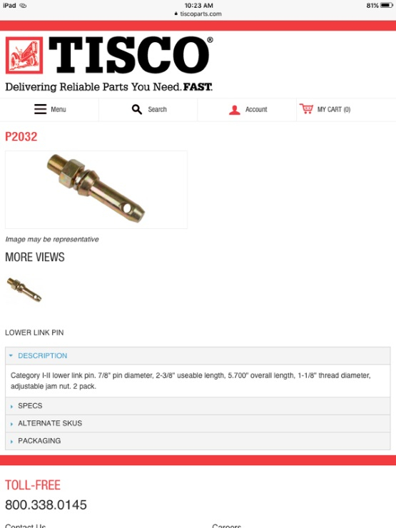

Thanks for the replies. I do have heavy suitcase weights up front so I think I'm fine on the weight. In terms of the horsepower, I do appreciate I'm at the bottom end of the recommended range. I do have a heavy brush hog already and it's just not quite up to what I'd like to do. I'm trying to clear an overgrown field (mostly coyote brush) and it's just to heavy to do with my brush hog. This machine seemed good because with the open back I thought I could get to the brush without having to drive over it.
In terms of making the pins fit; is there a bushing that goes in the holes of the attachment to reduce the slop? Or is there another way I could make it fit? I'm not totally sold on this particular attachment but I am looking for some piece of heavy equipment to clear this area.
Yes, get two Cat2 to Cat1 Pins. The thread diameter is 1-1/8", the pin is 7/8":
