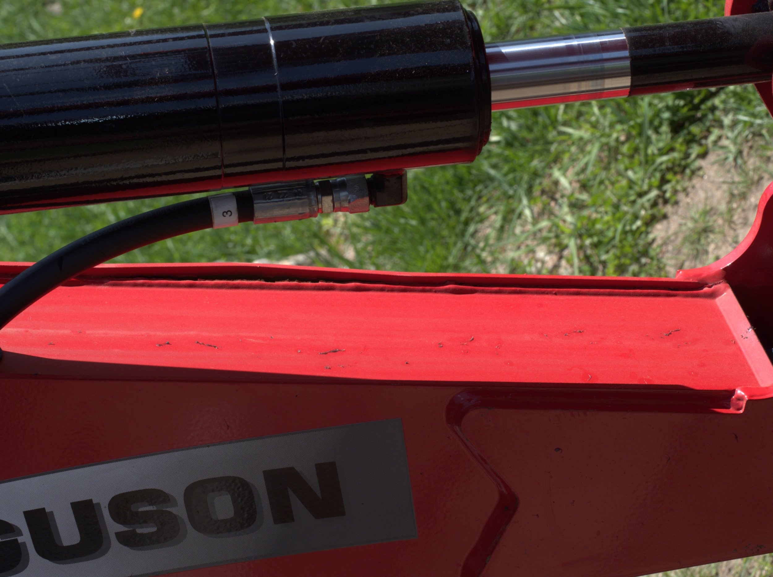

Just wanted to post an issue I had with my CB85 backhoe from Massey Ferguson, and get some thoughts on where to go with it. And maybe help someone else who might find themselves with a cracked hoe.
This backhoe has something like 100 hours on it. Bought it new with my tractor (MF 2850E) in July 2021. The backhoe was backordered a bit, so took delivery in mid-September of that year. It hasn't been flawless, but overall pretty happy with how it works, and really like the quick attachment/detachment.
Working away with it yesterday, when I heard a loud pop from what sounded like underneath the backhoe. I took a few minutes to look all around the backhoe and the subframe, trying to see where the noise had come from. Couldn't see anything loose or out of place, so went back to digging. On one of my next lifts, a dark spot on the edge of the boom arm caught my eye. The side plate had separated from the top plate and buckled out about 1/4 inch. Further inspection revealed the entire weld had separated on that side of the boom, about 16-18", right from the lower pivot up to where the boom arm starts to curve. I assume that the weld separated when I heard the pop, and the now completely unsupported side plate started buckling under the stress of the following lifts.
After a couple of minutes of wondering how the hell did that just happen, I got down and took a really close look. The short answer is an absolutely garbage weld. The side plate had almost zero penetration. The rust all over everything and under the paint, makes me suspicious whether any surface preparation at all was done prior to welding. Overall, not a good feeling looking at it.
I've attached pics for anyone interested in taking a look and weighing in. The backhoe is currently loaded on the trailer and waiting to go to the dealer Monday.
   / CB85 Backhoe boom arm split #2

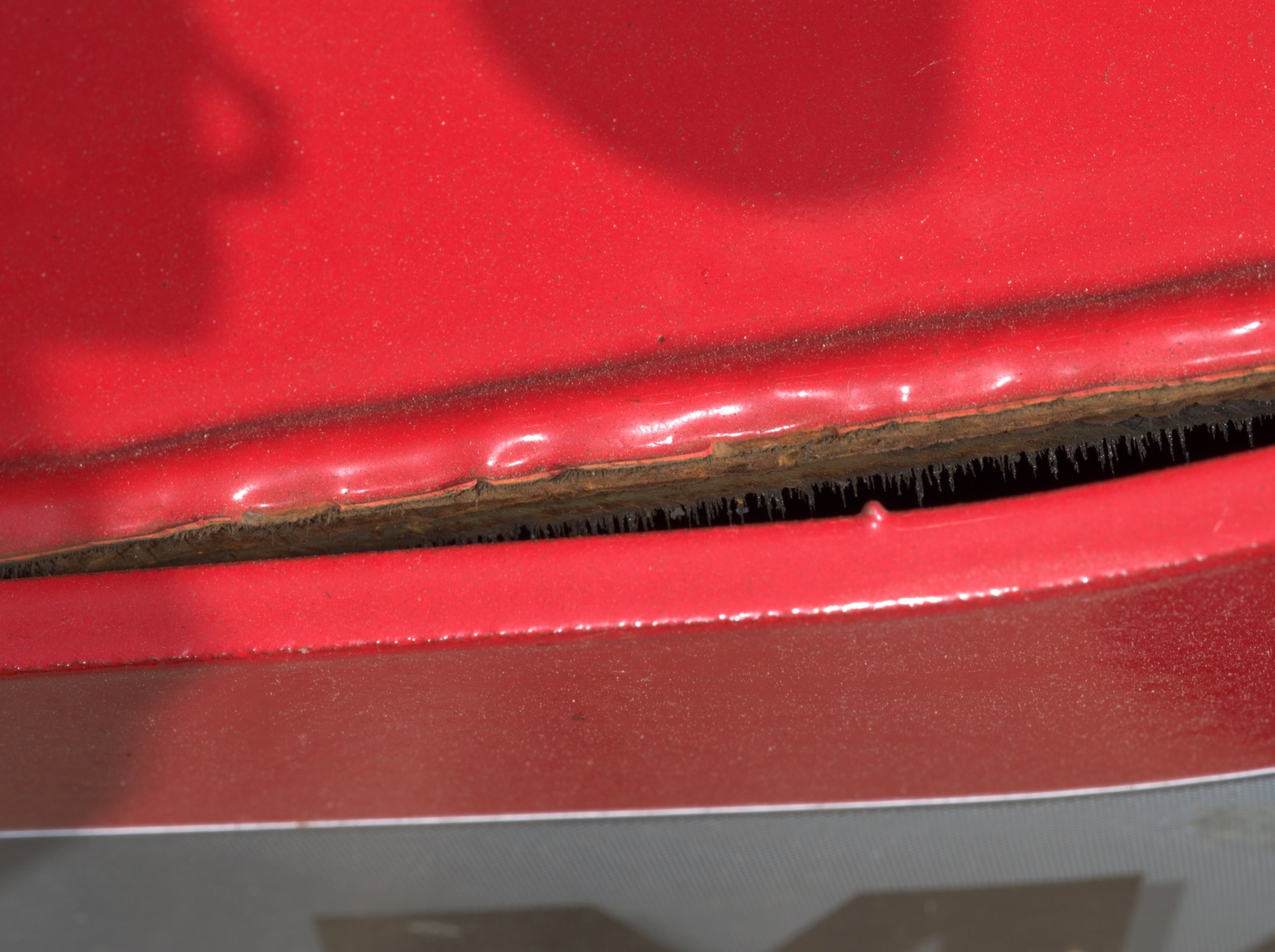

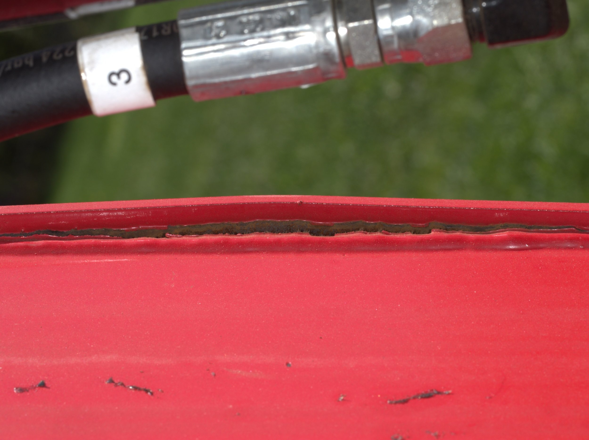

Sorry that happened. As you noted, no penetration.
That's not simply a matter of not being clean enough. You get it hot enough, it's still going to melt the metal.
That has most likely been broken loose to some extent during previous uses, so there has been exposed bare metal there with capilary action causing the rust.
Clearly, either the welding machine was not set up incorrectly, if it was automated, or the weldor didn't pass their welding test. either way it should have been caught by the inspector.
Hopefully it's isolated to that area.
I would look with a magnifying glass, for any cracks or rust stains, on other parts.

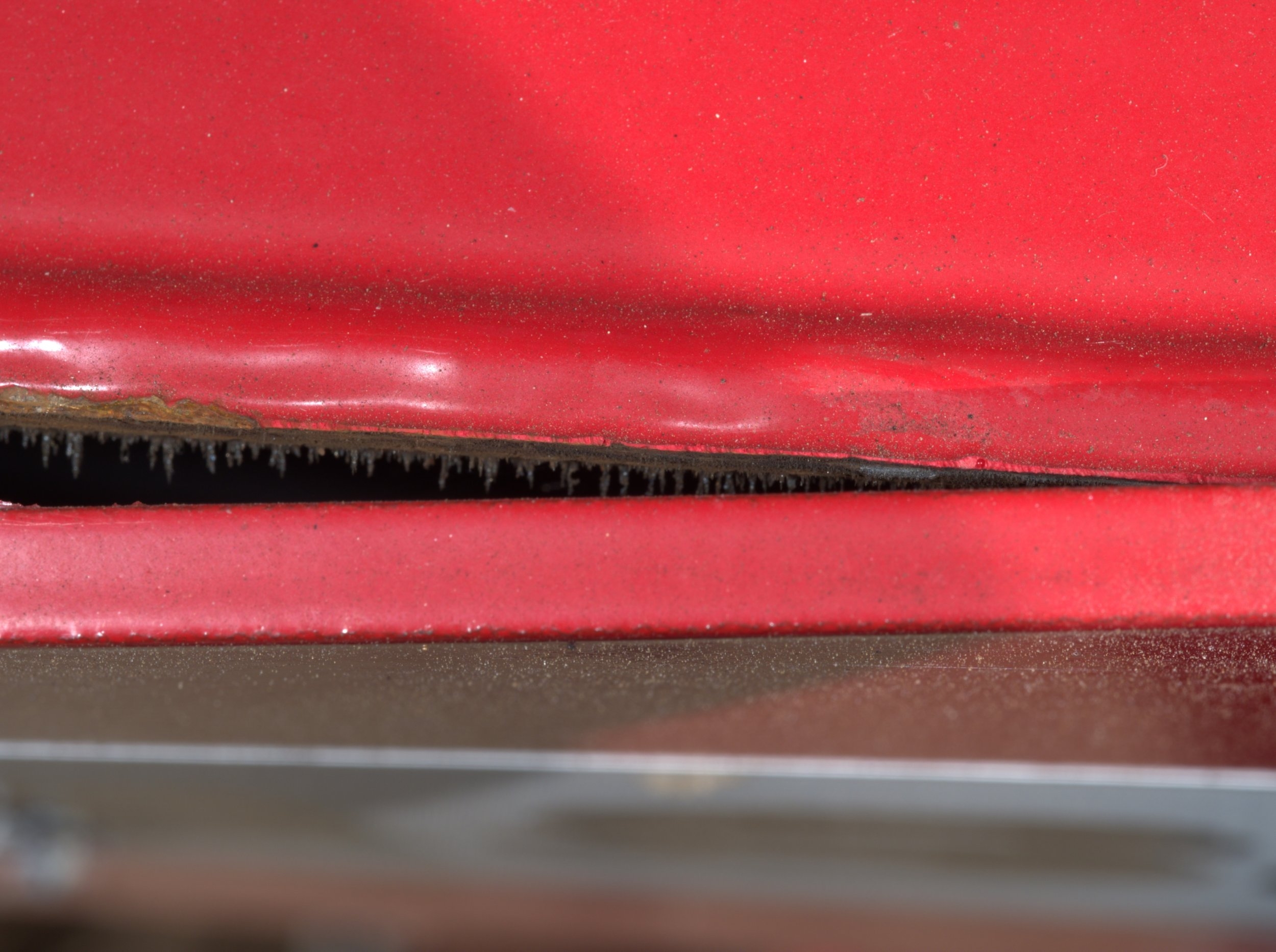

Thanks. I agree about the welding machine or robot not being set up correctly, since the weld fillet centerline is very consistent in how far it is from the side plate. Like maybe the workpiece wasn't set in the jig correctly. Incorrect weld placement is why this connection failed, I believe.
You may also be right that the rust is just from hairline cracks in the paint over that area, but something tells me the piece was never cleaned and prepped properly. You can see metal filings in the pics, like the type you get from the cutting/grinding process.
The rest of the welds look good, and no sign of any other paint cracks or rust stains, but I'm still going to push for a replacement boom arm. A repair weld might be better than new, but the paint won't be. And that buckling of the side plate is going to mean it's never really the same again. For what I paid for this backhoe, it doesn't seem right of AGCO to expect me to accept a compromised main boom arm.
