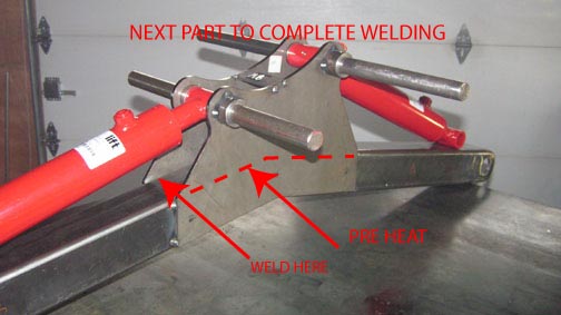

So dfkrug are you saying that when welding for example 2 plates which sandwich a rectangular tube which are to be welded on the inside ( only ) as the next part I will be completing ( see pic ) that it would be a good idea to pre heat the backside prior to welding.:confused: I do understand that welding for great part is heat management. I understand that when I weld the inside of the plates that they will pull in towards each other, other than supporting with braces and say alternating my welds, will preheating assist to control the warpage? If so does the pre-heat have to be red hot?
Do the inside only or the outside only to give the side plates some freedom
to expand. Preheating helps, too, and it does not have to be red hot. If
you weld the outside seam all the way (stitched), you will get considerable
heat into the plates. Clamping will be necessary as the unsecured side of
plate will try to move away from the tube. Allow for some distortion of the
side plates by leaving clearance for your cyl cross tubes.
Of more concern is your bushings. I describe how to keep them aligned in
my 4-in-1 thread. Don't tack them in until the side plates are welded. Then
weld them while the side plates are hot. Use guide pins that fit very tightly
inside the bushings. You will not be able to remove them until the steel
cools. I have not had to ream out bushings in a long time. I wish that
Mikulas at CADPlans had been more knowledgeable about heat management.
   / CDP BACKHOE BUILD #50
In the picture, if you are welding on the inside at the top of the 4 in box tubing, The side your welding on will expand and probably tilt the top of the bracket outward. You could also use a 1 in bolt to tighten the assembly down For a little more insurance, , I would put some 1/64 washers on either side of the cylinder end , before welding. If you are welding with cored wire, wrap the cylinder shaft to prevent any weld spatters. You don't need the cylinders in place if you substitute a tube for the shaft of equal dimensions. However if you want to keep the alignment, then the cyl is necessary. I tried to align some of my tabs with a square only, and I was off a little bit.
In theory, if you heat one side of say, a metal plate , it will tend to expand on that side, and if you heat the other side the same, it will try and bend back. It may also twist. So it might be possible to manipulate the metal somewhat to the desired effect. Meaning, to make it work for you.
