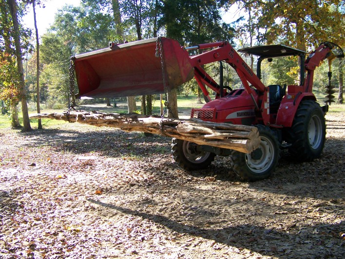

I finally started putting some fence posts up. This is one of the Mountain Juniper posts I cut down at Welding is Fun's place 2 years ago. I didn't pressure wash it, but took the bark off with a screwdriver. The outer stringy bark fell right off, but termites got under it and the smooth brown bark. This even with the posts a foot off the ground. The eastern red cedar post I had shed all it's bark by itself, but not these mountain junipers. The termites would not burrow past the white cedar, but you can see the trails them made on top of it.

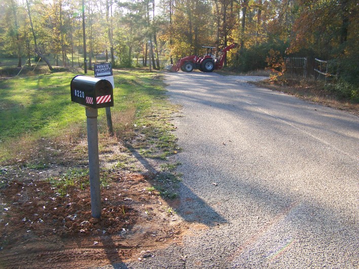

I started the fence from the end of my driveway up to my new mailbox. The mailbox got flattened a few weeks ago and I replaced the wooden post with a 4 inch diameter, 1/4" thick galvanized pipe and augered a hole almost 5 feet deep and concreted it all in place. Let them flatten this mailbox and post! This fence will be 3 feet from the pavement that goes past the cul-de-sac and that will make it 12 foot from my property line, which runs down the middle of the pavement.

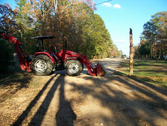

I topped the post at 10 feet, and plan on a 16 or 20 foot gate with a support wire from the top of this post.

righteous post. You will also want a wire running from the top of this post to the bottom of a brace post along the fence line....to counter the weight of the gate you are going to hang on the post.
   / Cedar post fence
#23
Huh.............the gate will be about 90 degrees to the fence. Grandpa had wheels under his 20 foot gates. Anyways, wire and cross braced cedar will be on the end runs. We use barbed wire twisted with a stick.
Joy is going shopping for the tools you need.
hugs, Brandi
   / Cedar post fence #24
hugs, Brandi
That is what we try to do on gates,wheels on the end.Seen them done both ways,I never liked the looks of wire strung down to the end of the gate. LUTT
   / Cedar post fence
#25
Oh Lutt,
What's the fun in no wire. You need somewhere to hang stuff on.
hugs, Brandi
   / Cedar post fence #26
Wheels work. I've got a neighbor who has a wheel on a gate with a concrete runway for the wheel to follow. Don't know why...never rains here so wheel never gets in the mud:thumbsup: I gave up on twisted sticks some years ago...use a fence ratchet from Tractor Supply (about $3) to tighten brace wires. Leave in fence, come back later and tighten as needed as slack develops. And, why use a stick when you can go shopping:D
hugs, Brandi
   / Cedar post fence
#27
Thanks John. I get the wire reatchets at TSC. Twisted sticks were from my Dad's day.
hugs, Brandi
   / Cedar post fence #28
I'm late to the discussion of little end or big end in the ground. If I'm digging a hole for a post with either hand diggers or PTO auger, I always put the big end in the hole. Seems like you can tamp in the the dirt better and get a more solid post that way. If I'm driving them with my 953 Cat track loader, I sharpen the small end and put it in the ground. Since there is no tamping when driven, the posts are solid immediately and they drive much easier. I also didn't worry about bark on the driven posts, but I did de bark the hand tamped ones. They just seemed to be more solid that way.
For a test, I drove a gate post and hand dug and tamped one then hung a 14' gate on both and did not use wire on either. The driven post has not moved in 3 years, but the hand dug one has moved enough that I had to adjust the hinges since it was no longer level.
I should also note that I'm using locust posts with a few cedar thrown in. There are still some 30 year old cedar posts on the back of the property that are still pretty solid, so yours should last a long time.
   / Cedar post fence #29
Logic would suggest that the big end would be in the ground as rotting process would take longer as well as considering laws of leverage, the closer to the fulcrum point the thickest would be best.
   / Cedar post fence #30
New question, I was always told that cedar posts from a field grown cedar was not worth putting in the ground. The idea was that they had more sap wood and not as much heart. anyone else heard that?
