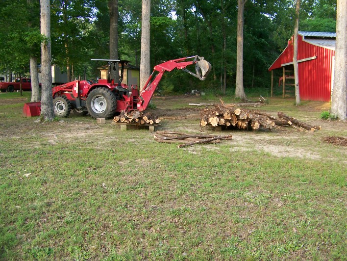

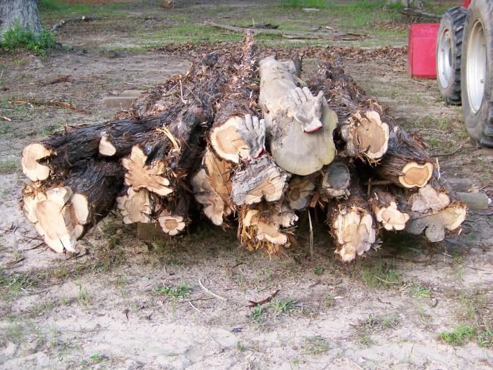

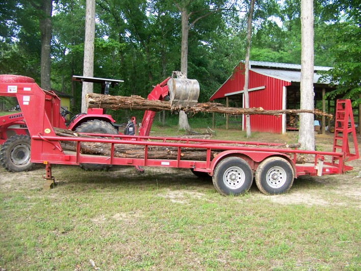

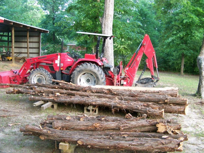

A couple of months ago, I asked (in the South forum) where I could get cedar posts cheap. Lee (Weldingisfun) offered to let me take all I could cut down and trim.:thumbsup: I will be using these cedars for a fence from my barn along my driveway and curving past the pond. Back on April 10th I was at his Goat Ranch and we worked hard. I cut the trees down and he drove his tractor and we both trimmed. Hard thing about it was we had to chain and pull the trees off a draw over a stream. We would have had a lot harder time loading my trailer if it was not for Lee's Mahindra 4500 and loader. We sat the loader bucket over a bunch of logs and wrapped a chain around them and the bucket to sling the logs to my trailer. Here are a few photos from unloading the trailer this afternoon and stacking the cedar. I counted 45 posts anywhere in size from 12 inches down to 4 inches and about a dozen braceing posts. I used the Big RED Beast to unload without breaking a sweat.
