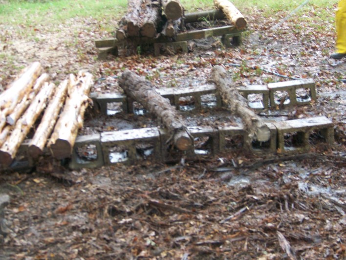

A friend loaned me a high dollar pressure washer and I made a lot of cedar bark mulch this weekend. Saturday I blasted a dozen 7 foot posts and one 14 foot gate post. I stated with only rubber boots on, but after my soaks got wet, I went in and changed and put on a rain suit.

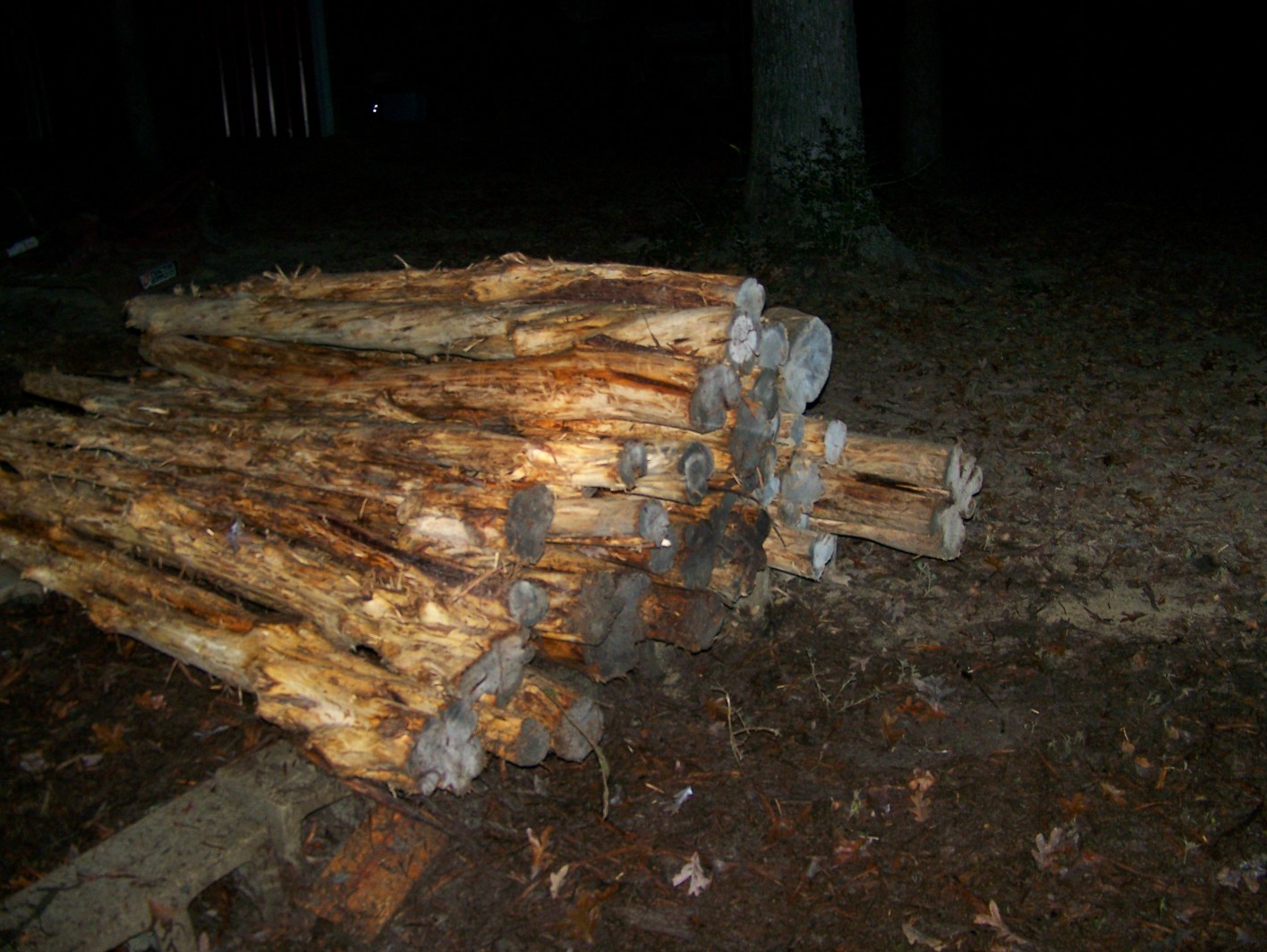

Here is a stack of pressure washed cedar posts. 12-2-12 Stack of debarked Cedar Posts.jpg I used a zero degree nozzle and it worked great. Pressure washing leaves a huge mess around the area and you need two baths to get clean. I tried the 15 degree nozzle first, but the zero degree nozzle worked better. The smaller posts debark fast. But the big (10-14 inch diameter) post have numerous large and small crevices that seems to grow over the bark and these took a while to debark. Next posts I do will just be what goes into the ground. I will leave the exposed (not in the ground) on and let if sluff off itself.
It really is a toss up on debarking by hand or pressure washing. Each has it's positives and negatives. Wash it the same spot too long and the white wood will start fraying. One will wear your hands out and the other just plumb wears you out.

Brandi, have you ever tried those rotary/turbo nozzles? They are 0 degree but spin around so you cover a bigger area, doesnt sit on a single spot and are lot easier on your hand and they work great. We use one on our pressure washer for 1 to 3 hours a day every day we salmon fish to keep the nets clean, my daughter calls it the "cone of clean".
