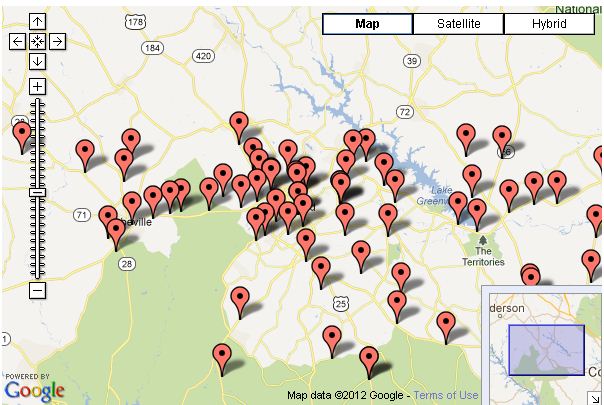

A cell phone signal booster can do wonders if you have the right equipment and can get a directional antennae pointed at the tower and there is enough of a signal to boost. There is some science to installing one. Just sticking up an antennae and hoping it works will most like yield unsatisfactory results. Go to CellReception.com and key in your city or zip code. The map will be populated with known cell towers in your area. You can try a different phone, but if there is not sufficient signal you have just wasted your money. The Wilson web site has a tab to find certified installers in your area. A certified installer can help you determine if a booster will actually do you good. A good booster will amplify signals from all services. Nextel is going away so don't include that service. Then it becomes which tower is sending the strongest signal in your area. I have saved a number of marriages in my area by doing a good install. At least read up from the Wilson web site. The attached thumbnail shows Verizon towers near Greene, NY.

Icould be getting signal from any of those three towers. Is there a way of knowing which one I'm connecting with or is that just trial and error? Surprised anyone gets signal from Verizon!! Maybe I should work on convincing them to put a tower on my "hill"

I would say the one with the strongest signal (obviously). Some phones can be put into "test mode" where you see a number indicating signal strength. Using that walk around the property and see if the strongest signal is coming from one of the displayed towers. A -65db is a great signal, -100db and you might be able to send text messages. The solution I have been working with is specifically for buildings, however there are booster packs for cell phones.

I went to the site, put in my town and see nothing, well thought it was cause regardless of carrier there is no signal at the house. So i clicked on your picture,... where are the towers adn coverage in the area posted i see nothing but a map?
