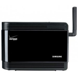

We bought the Verizon booster when they first introduced it and I think they charged me $99.00, now they are like $189 dollars.
Amazon also sells this item.
Amazon.com: Verizon Wireless Samsung Network Extender SCS-26UC4: Cell Phones & Accessories
We have all gone to 3g phones and our signals at home is much better. They have also added the verizon network to the cell tower in town so this item isn稚 really needed any longer here at home.
