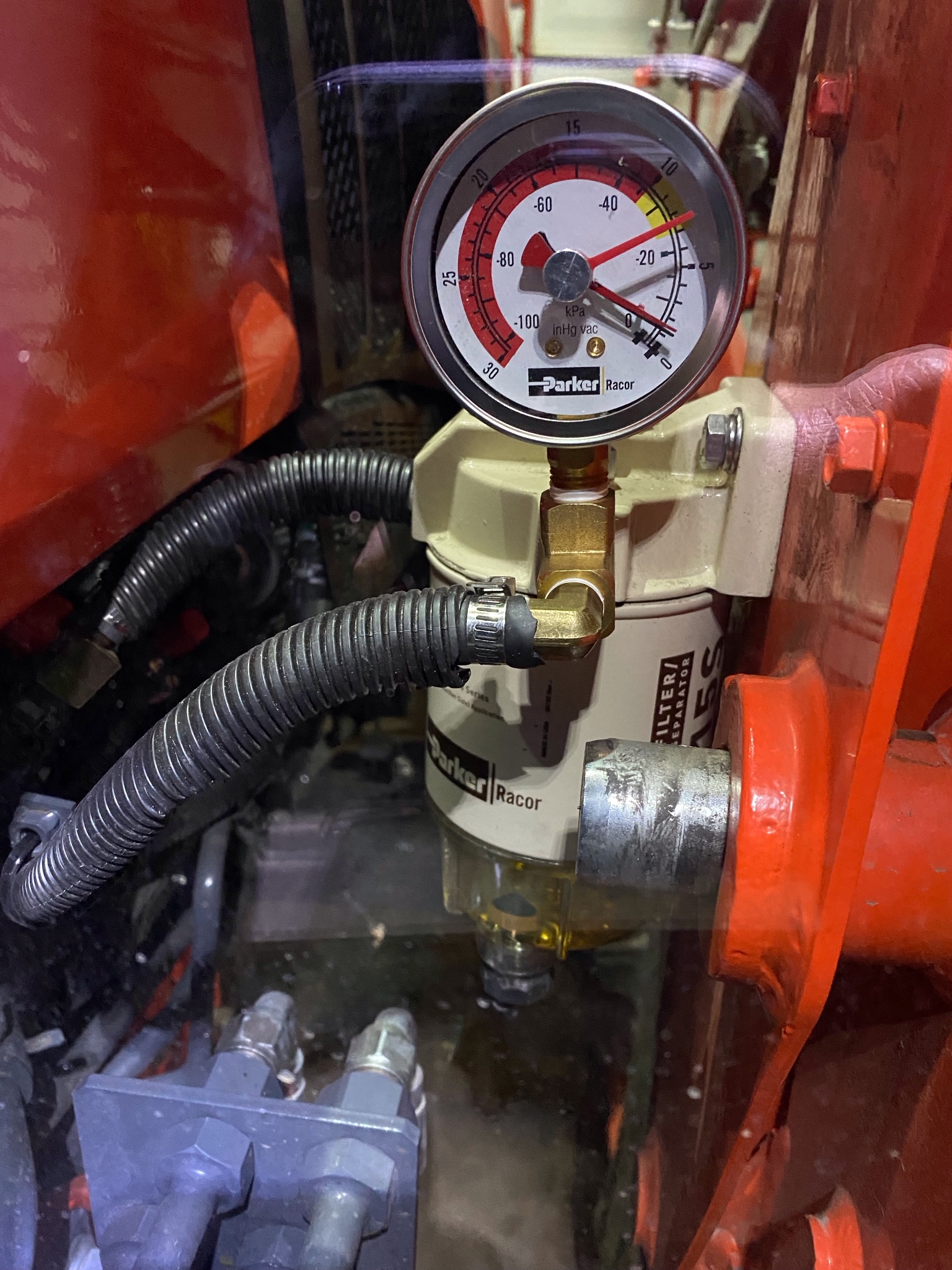

I know you already bought a filter, but you can't beat Racor separator filters. You may want to take a look at them.
I put one on my (not BX) tractor several years ago. There are several threads here on TBN about installing them on the BX tractors.
The easiest method I have found to remove the bowl is to use a rubber strap wrench

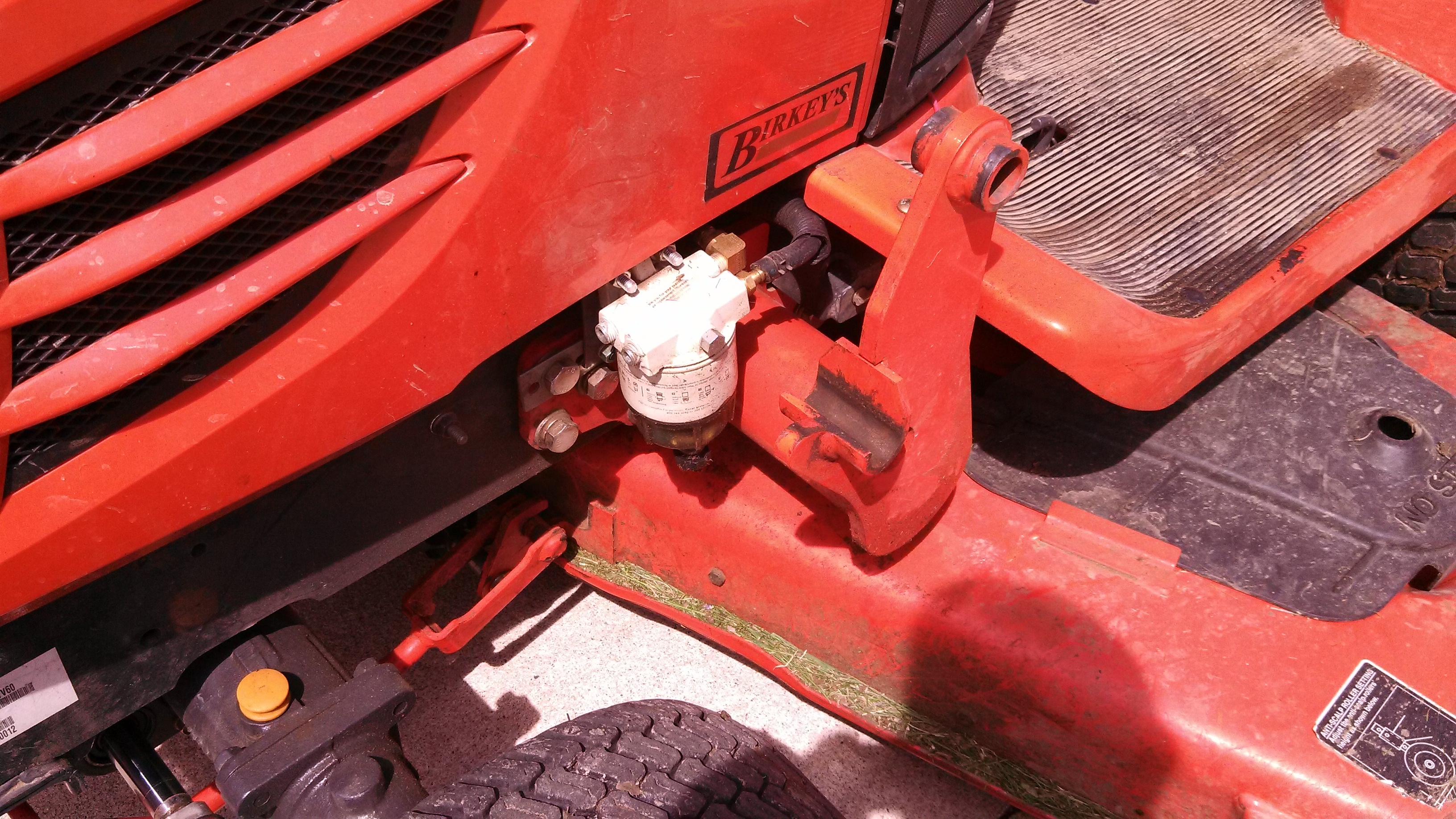

This is how I mounted mine. I spent a bunch of time trying different places and this is about the only place that works. It replaced the rear filter, so you have to run a fuel line up to this location, then back again to the back where the little fuel pump is. Not near as bad as it sounds. Then the little filter up by the engine stayed in place. This is a Racor filter setup but it doesn’t have to be that brand.
I no longer own the tractor and the JD I own now still has one of those little filters but then the second one is a decent one in a filter bowl. Those little one are pretty crappy.

Rj sir where do you get that Racor filter. Do they come big enough for a bulldozer
I bought (2) 215r Racors at "The Racor Store" I believe. They come in all sizes, at least up to 250 gallons per hour. The 215r series is 15 gallons per hour, as is the smaller sized 120 series (I think).
