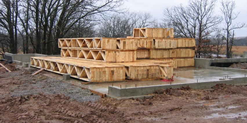

When I had narrowed my search down to the Century/Branson line, it was the strength of the C-50hl loader that made my decision for me. The controls for the C-50hl loader are right by your right hip on the fender.
I have a set of forks that attach to your bucket so they stick out even further. According to the paperwork that came with the forks this will decrease your loader capacity by 17%.
Attached is a picture of when I loaded all the trusses into my garage after the semi dumped them on the ground in the mud. This set of trusses are 26' long 16" deep and each truss weighs 130 lbs. There are 10 of them on the forks here for about 1300 lbs. It was muddy and slimy but the loader did a good job.
   / century C50HL loader specs #6
This picture is of the trusses in the garage. The last stack was a bundle of 12, 26 foot trusses. This was the max for the lift capacity of the loader. The weight was way in front of the pivot point on the loader and I had to play with the loader to get it to lift it up over the stemwall for the garage. The forks did not reach the last 3 trusses so the band was carrying the weight of those, which made it bounce a little more and made the back end of the tractor really light.
I actually did not think it would lift it but am so glad it did. I really did not want to move those trusses in the rain and mud by hand. /forums/images/graemlins/frown.gif
