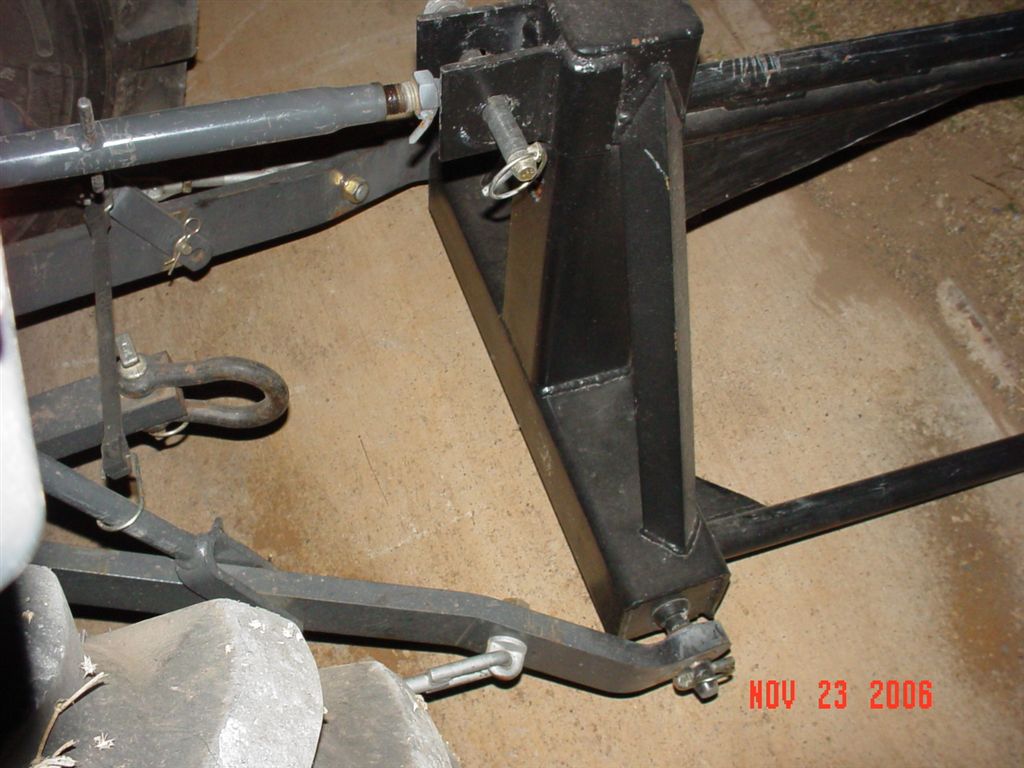

dont have a 7510 but my L3400 sounds similar when finding a place on the back. i use a 3/4" clevis in the drawbar then run the chain through the clevis. Here is the clevis mounted to the drawbar.

Looked for a clevis that is large enough for the drawbar (1 5/16 thick w/a 3/4 hole) nothing local. Even went to a tractor/trailer retailer. Some catalogs are showing some but no dimensions. I did find a 1/2 separate link and wasn't sure if its as sturdy as a clevis. has anyone tried this?? Thanks
i get mine at Tractor supply
