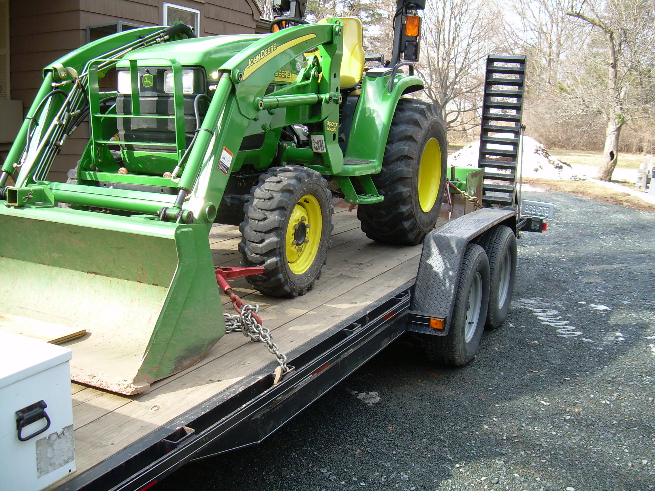

I'm getting a B3200 TLB with thumb and loaded tires. Roughing it out and allowing for the subframe and loaded tires I'm figuring it will weigh around 4000 to 4500 lbs., (1500 tractor, 1000 BH & subframe, 1000 FEL and frame = 3500 plus loaded tires and thumb).. close to 4500 lbs I'm thinking.
I'm used to hauling ATV and Harley's with straps, so chains and binders are new to me. I looked on the internet and also at Home Depot for chains. I'm in Arizona so salt and corrosion aren't a problem. I won't be hauling it much but if I do the nearest service is about 70 miles away with a couple of 7 mile 6% grade hills in between (4 lane divided freeway).
I read the Federal Tie Down laws. I don't mind overkill so I'm safe but I don't want to be stupid about it. I haven't checked my AZ DOT regs but I will before I haul it. My main question is about chain grades and binders.
Trailer will be a flatbed 7000 lb with electric brakes and I have a 2WD Ford Expedition EL with a tow capacity of just under 9000 lbs, with all tow equipment and load leveling shocks.
So.. my question is, what would be the best grade chain to get. From my research I see that 3/8 inch grade 43 has a WLL of 5400 lbs. and 5/16 grade 43 has a WLL of 3900 lbs or 5/16 inch grade 70 has a WLL of 4700 lbs.
My thinking is to get the stronger grade 70 chain but thinner 5/16 because it would be easier to work with than the heavier 3/8 inch grade 43.
Does this make any sense or am I looking at it totally wrong. From the Federal DOT regulations any one of these will hold a 5000 lb load from forward movement, the heavier grade only requiring one chain on the rear, but I would use one on each corner, so I would definitely be in the safe range with any one of the grades.
Even dropping to grade 30 would only require 2 chains (one on each corner) to keep a 5000 lb load from moving forward per Fed DOT. Or moving up to 70 grade I would be safe with 1/4 inch chain which has a WLL of 3150 lbs so two would suffice even with 1/4 inch chain since it would have 4 tie down points, one on each of the 4 corners.
I have plenty of straps, heavy ones, but I don't want to use them, I would feel much safer with chains and binders. A strap over the bucket or across the BH is fine but all corners would be chain.

This is only my opinion but I say you can use grade 43 3/8" chain or grade 70 5/16" chain. You'll probably get a lot of responses not to use grade 43 but it does exceed the WLL of your load. A lot of people use it. Some will tell you you have to have grade 70 or better. I disagree and say as long as The chain WLL exceeds your load you meet the requirement for load securement. This info is according to the local DOT in my state who have inspected my grade 43 chain on at least two occasions. I have both grade 43 and 70 chain and use both depending on the equipment I'm hauling. Please check with your state dept. of transportation for equipment securement rules.
You are also correct that your load only requires two chains as does mine but I always use 4 chains (one each corner with ratchet binders). Some would call that overkill but I'd rather use four chains over two any day.

I use 4-10' pieces of 5/16" G70 chain and ratchet binders for a load similar to yours, that 3/8" chain is a bear to work with!

Chris you only need chain with a WLL of 1125 ft lbs rigged on all four corners of a 4500 pound load to be compliant with any engineering standard and that kind of weight under 10,000 pounds the DOT could care less. Think about it if you put 1125 pounds of brute force on any one part of the B3200 ( Except axles and weldments greater then 1/4" thick) you would distort them or pull them apart enough to wish you hadn't tied it down that way to trailer.
The important thing often not discussed is the tie down points on the trailer. Make sure your fasterners are rated for the pull and if using D-rings fastened to a wood deck make sure the D-rings meet or exceed single line pull of your WLL and that the wood is sound and the backing plate distributes the stress through a section modulus large enough to not pull through the wood decking. Chocking the wheels in place on the tailer with four point binding is a safe secure load. Don't exceed any limits and built in safety factors will protect your investment for years to come....

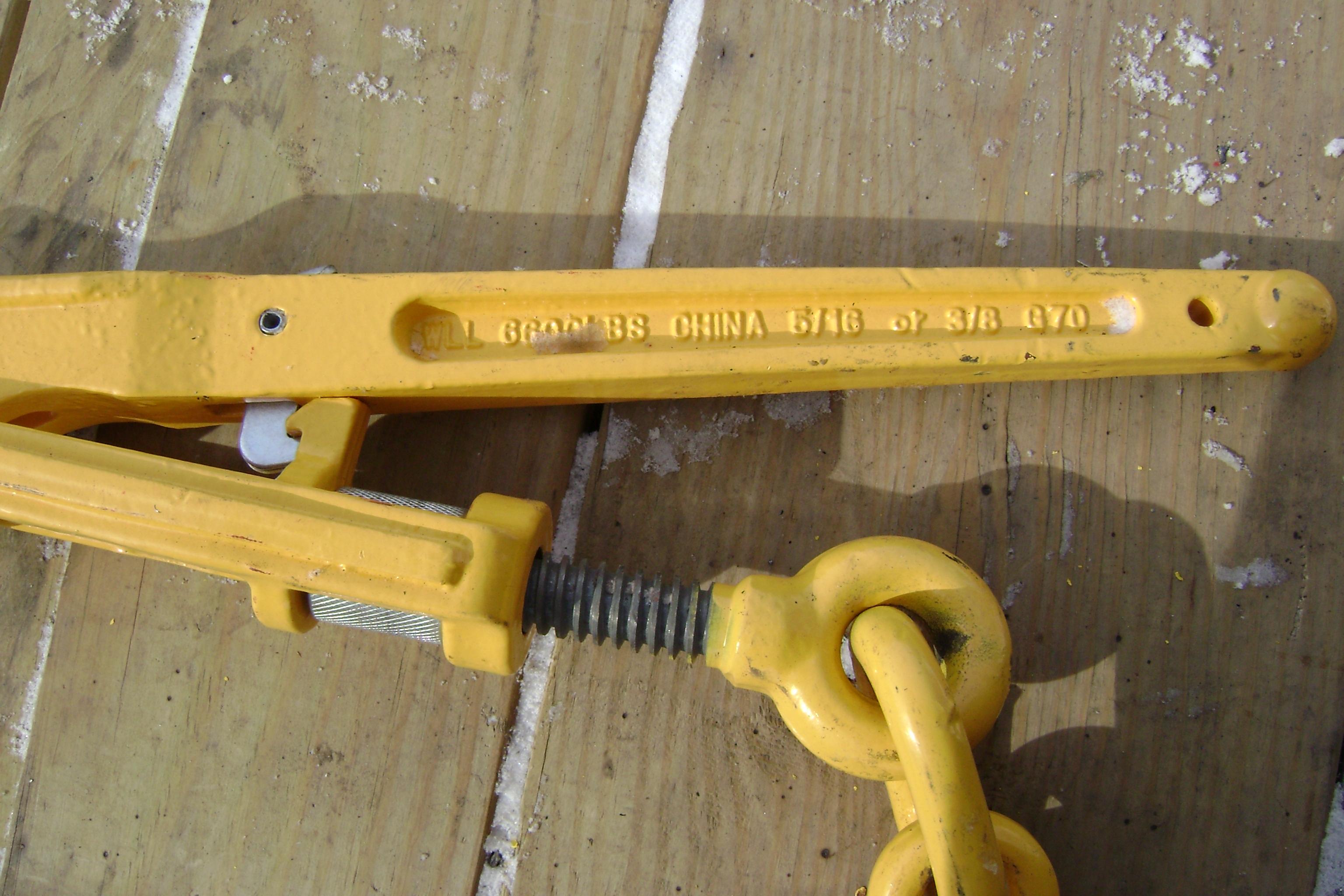

G70 has a stamp on the chain but doesnt say G70, its usually a little raised mark.

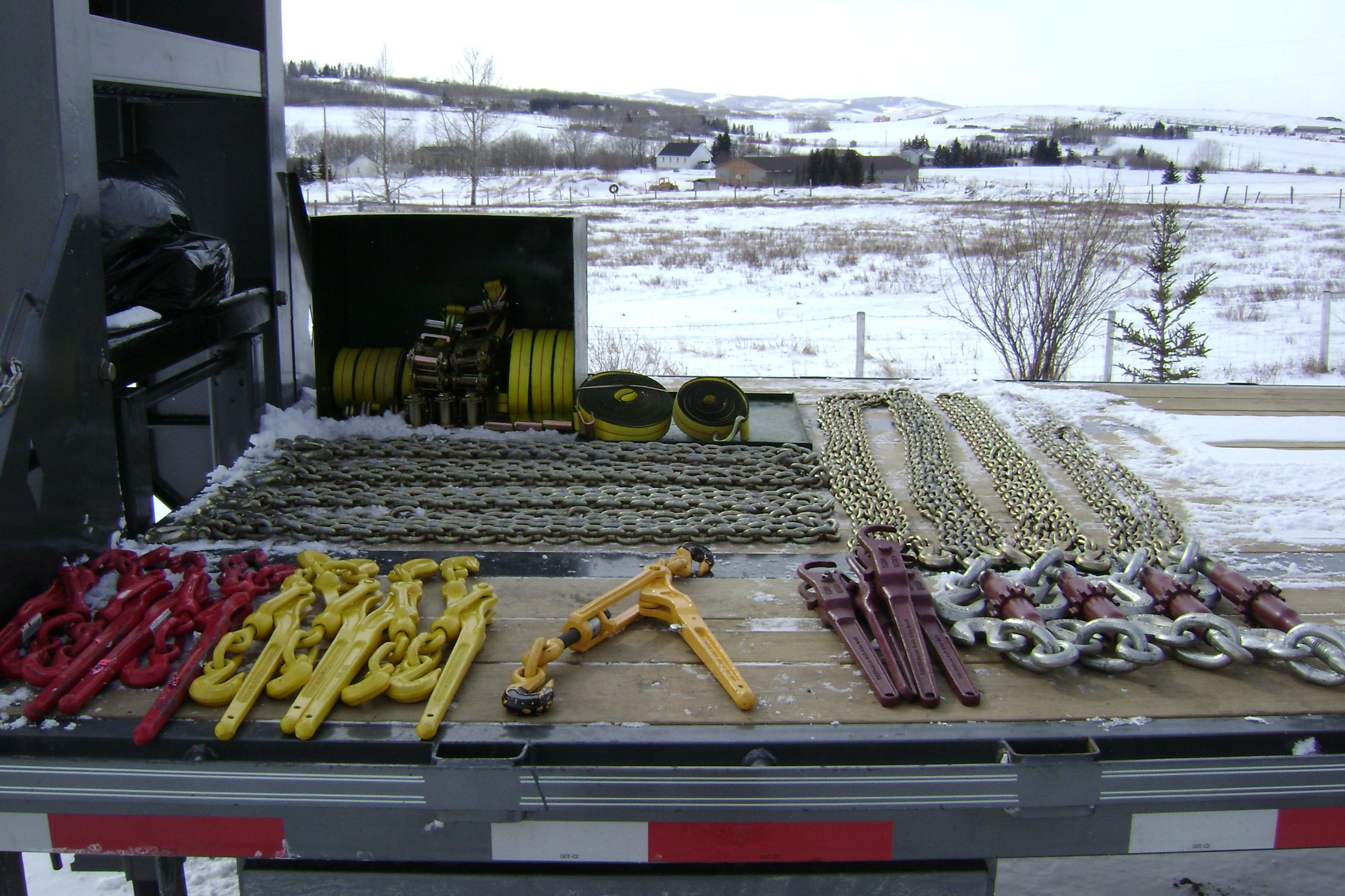

I needed to get to this list done for the trailer insurance purpose anyway so thanks for the motivation guys.:)
This is what I carry on the trailer, (and some pics) and what ive learned is:
-regarding securing the load, I can hold down anything.
-Carrying all this stuff means I have enough remaining GVW to haul a bike.
-Not to mention the Winch, mount, extra spare tire and saddle box that were not present at final weigh in.

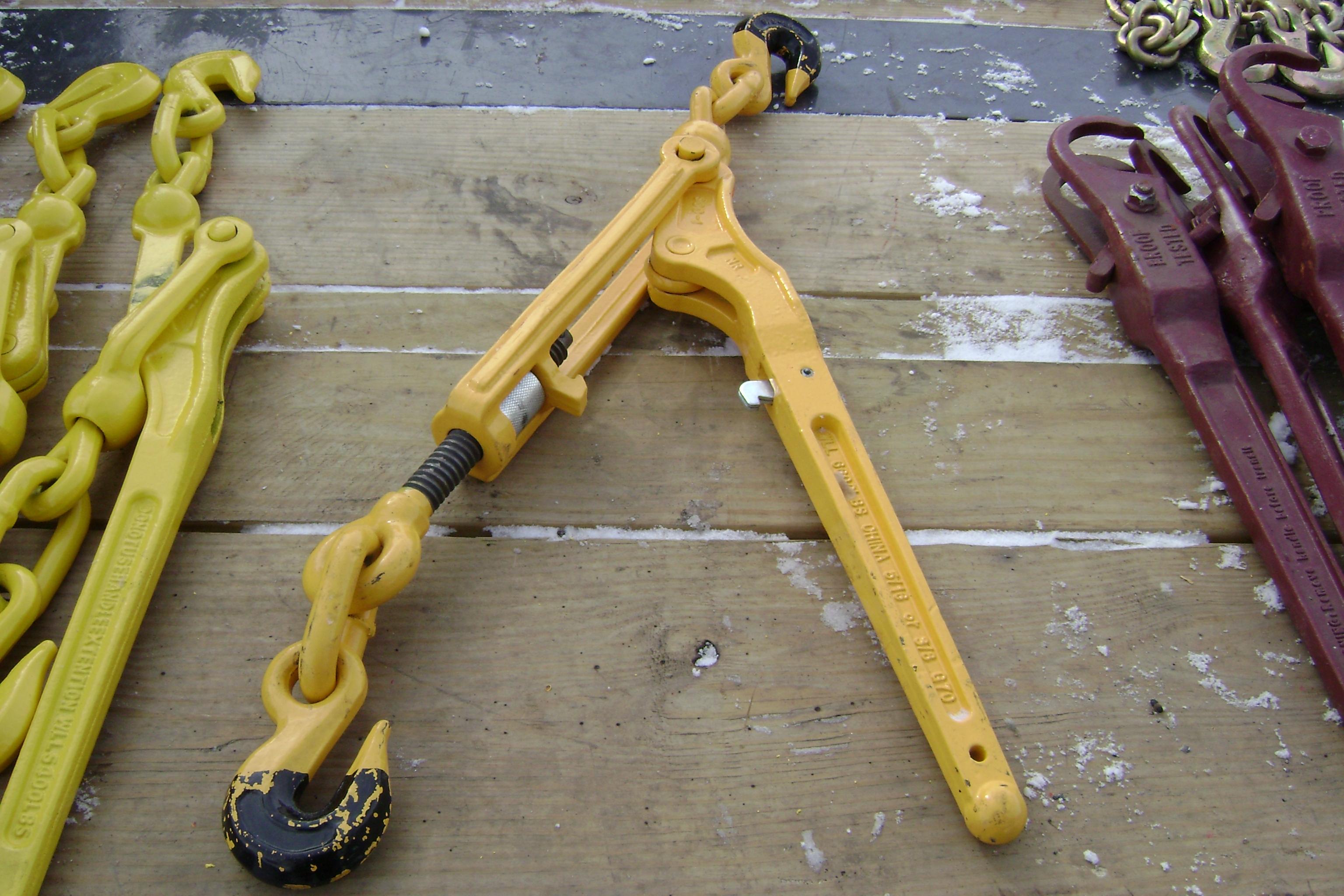

The yellow binder in the center is really slick, the salesman was a friend of my FIL and thru it in as a "promotion" when I bought the chains. It is adjustable by the thumbscrew to 3 inchs and it has a locking feature to save mousing. 6600#WLL 3/8 or 5/16 Price tag said $55can.
------Load Binders: Total Weight: 159#
-1/2" Ratcheting (2pc.> removable handle)
WLL: 15000#
Number of item: 4
Single Weight: 17#(2pc)
Total Weight: 68#
-5/16 or 3/8 Locking (yellow)
WLL: 6600#
Number of item :1
Single Weight: 11#
Total Weight: 11#
-5/16 or 3/8 Lever (yellow)
WLL: 5400#
Number of item : 4
Single Weight: 10#
Total Weight: 40#
-5/16 or 3/8 Lever (red)
WLL: 5400#
Number of item: 4
Single Weight: 10#
Total Weight: 40#
-----Chain: Total Weight: 208#
-3/8" X 15' Gr70 Transport + 2 G70 hooks
WLL: 6600#
Number of item: 4
Single Weight: 27#
Total Weight: 108#
-5/16" X 20' Gr70 Transport + 2 G70 hooks
WLL: 4700#
Number of item: 4
Single Weight: 25#
Total Weight: 100#
----Straps: Total Weight: 80#
- 2" X 45' Ratchet Strap (2pc)
WLL: 3300#
Number of item: 4
Single Weight: 10#
Total Weight: 40#
- 2" X 20' Ratchet Strap (2pc)
WLL: 3300#
Number of item: 4
Single Weight: 10#
Total Weight: 40#
Total Items: 29
Total Weight:447#
