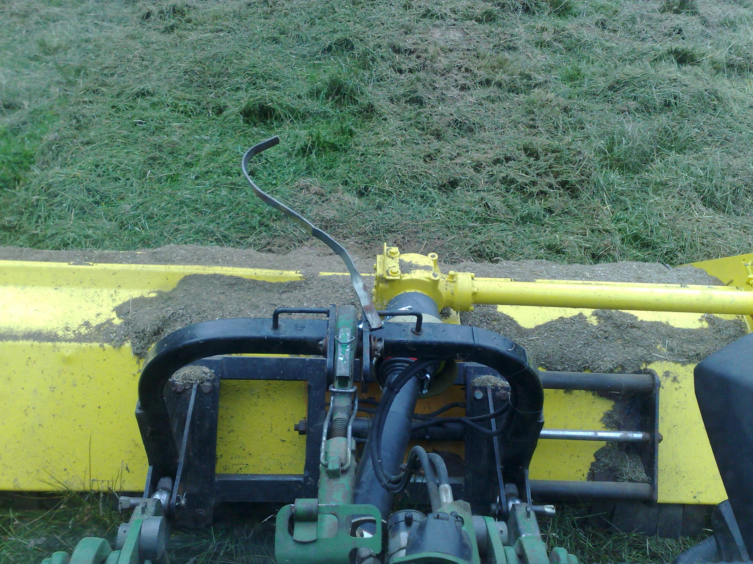

I think most flails are similarly designed - big heavy roller on the back, some sort of skids on teh sides to prevent it digging in too deeply accidently.
The way we always run ours is to place the flail on the ground, and remove the toplink.
You then start to lift the three point linkage a small amount and that will pick up the front of the flail, but the roller will stay on the ground.
You continue to lift the linkage until the front of the flail is at the correct height you want to leave the grass.
We then put the top link back on. However, teh top link has a threaded slot rather than a hole on the flail mower, so as it can float. We start off with it in the middle of this slot, then it can move both ways.
The top link is only really needed to pick the flail up. The rest of the time it is un needed. You could achieve the same with a chain or floating top link. The lower link arms should take the weight of the front half of the flail.
I cannot see how 'floating' the link arms would be the right way to use one at all. There would be a lot of stress going through the top link to push it back off the ground, and it would not be very good on hills. The top link wants to have no stress in it at all or you will bend / break them.
This machine cuts about 2000 acres a year:

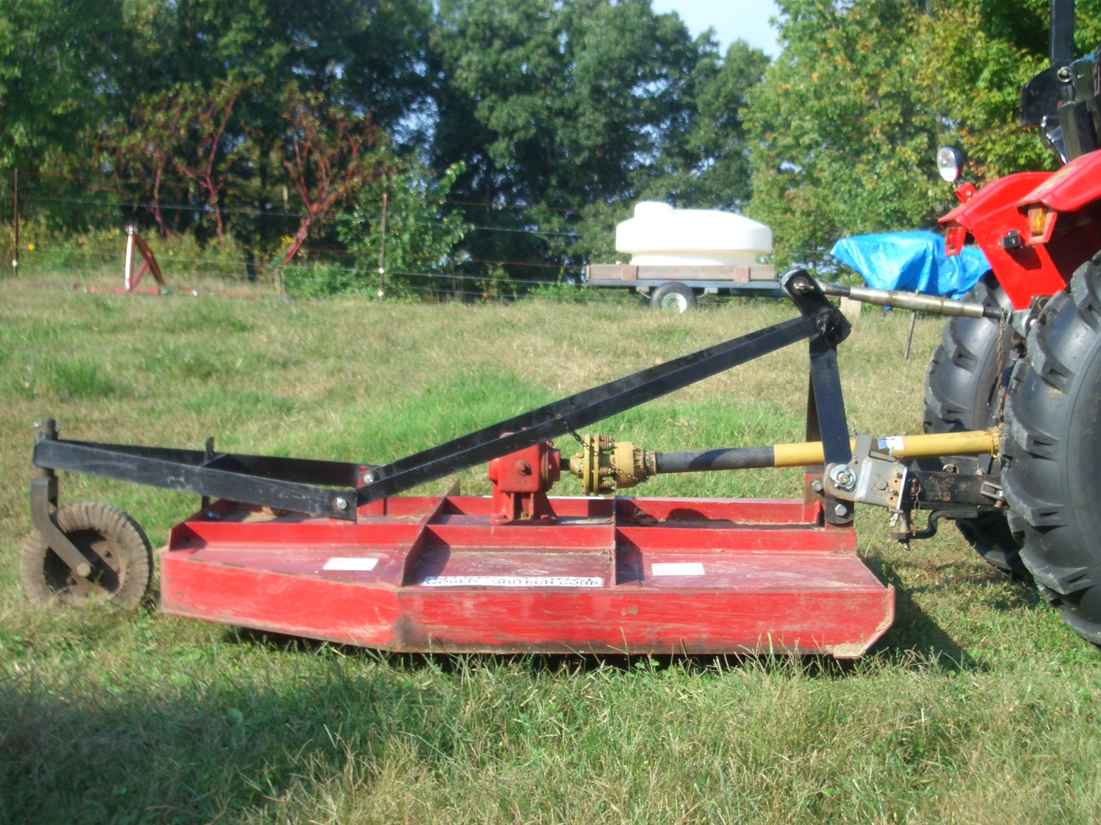

Look at the photos below. This particular style of flexible toplink bracket locks in the upright position. The left photo shows the transport position with the toplink shortened until the bracket hits its stop. At that point, the implement is picked up for transport. Now look at the right photo, which depicts the mowing position. Note that the toplink is lengthened, rotating the bracket back to the 45 degree position. Now when the front of the tractor is lower than the rear, the toplink pulls the bracket forward. But it's pivoting on a pin, so the mower deck never moves. Then when the front of the tractor is higher than the rear, the toplink pivots the bracket rearward. But it's only the bracket that moves, not the mower deck. That floating bracket will pivot through a full 90 degree arc, moving back and forth as the tractor goes up and down. Yet the mower deck stays parallel with the ground.
Same principle applies to the floating toplink bracket on my flail mower. I just didn't have any photos handy. The flail bracket is the U-type , and it pivots inside the A-frame instead of above it. Whereas the RC bracket has a 90 degree arc, the flail bracket will pivot nearly 180 degrees. And now that I have a hydraulic toplink, I don't even have to get off the tractor like I did in the past - to adjust the rigid toplink between transport length and mowing length.

Yes. It will. Perhaps you don't understand the principle of "floating". The more you lengthen the distance between the upper and lower lift arms, the more the TPH will float. Short version; get your lower lift arms as close to the dirt as possible - low enough where you have to LIFT THEM UP to attach to the implement. This is done with the adjustable vertical links and/or moving them between/among the various pin holes on the lower lift arms. The more the implement is permitted to float, the less it gets picked up off the ground when cresting hills, and vice versa
