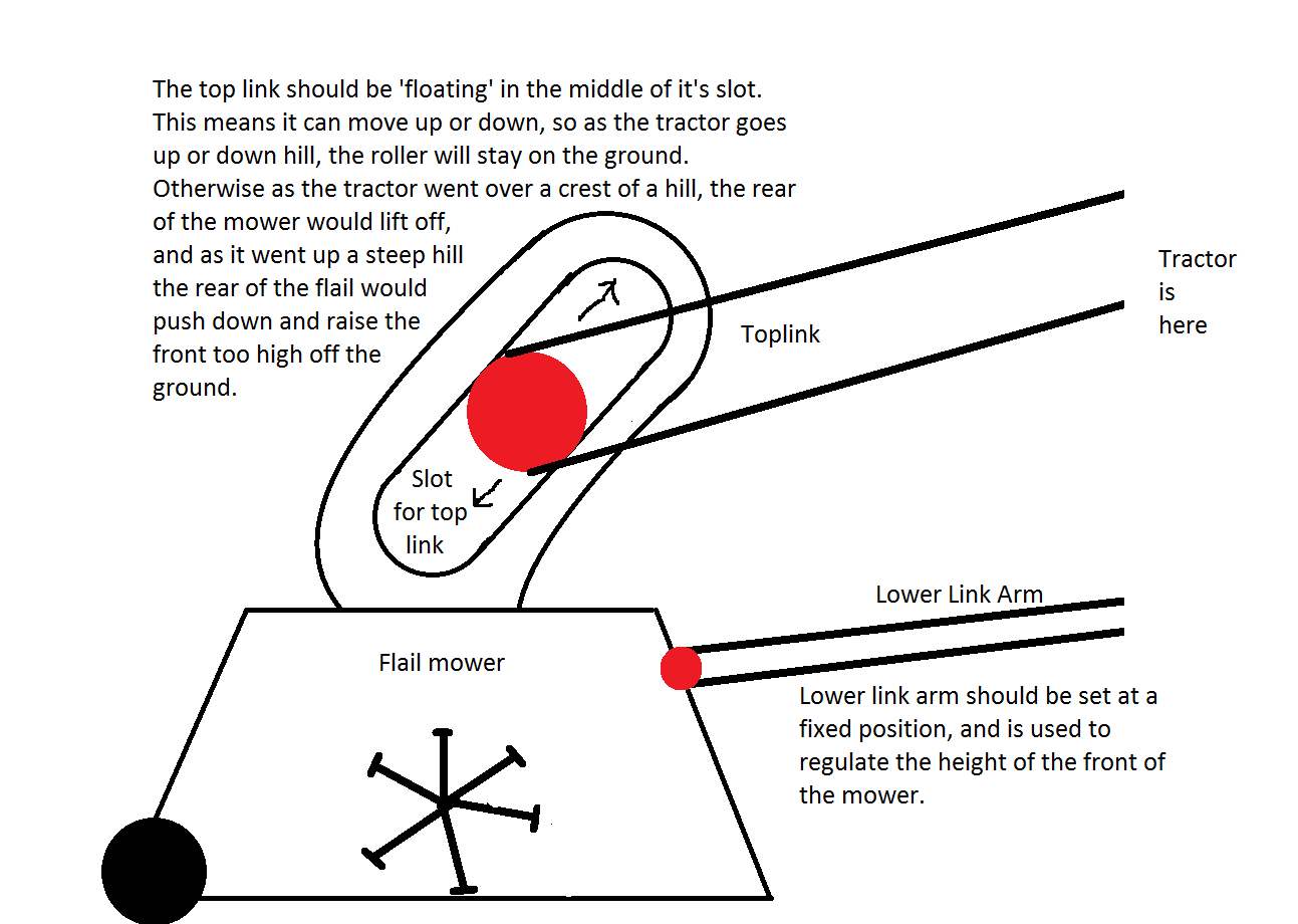

I have attached a picture showing how I would suggest a flail mower is set on the tractor.
The top link is not designed to take any weight or much strain. It is a levelling, and supporting device. On smaller tractors they may seem pretty strong, but trust me, if you saw how quickly a wrongly set top link on a 200HP gets pretzled, and the cost to replace it, you would make sure there was as little stress as possible!
That flail mower in my picture weighs nearly 2 tonnes. It is a great lump and nearly 3.5 metres wide.
There should also be no need to adjust the top link between work and travel. In work, the float should be in the middle of it's travel when on flat ground. Then when you pick the implement up, the top link will 'float' to it's extreme position and the rear of the flail will then lift off the ground.
As for the problem of the roller scuffing when turning - that is simply cured - drive in straight lines, and lift it up at the headlands to turn, do a 180 and go back again.

Greg G, reading your post again, this is exactly what I am suggesting is the right way to do it. Your bracked works in a very similar way to the slot I speak of.
What confused me, is that you said you put the lift arms into float as well (meaning you lower them to the very lowest position, and they can still ride up).
You can't put the lift arms into float, and have the top link floating, as the front of the mower would just hit the ground and scalp it!

Greg G, reading your post again, this is exactly what I am suggesting is the right way to do it. Your bracked works in a very similar way to the slot I speak of. What confused me, is that you said you put the lift arms into float as well (meaning you lower them to the very lowest position, and they can still ride up).
Yes, you understood and interpreted as I had intended. Thank you
Well, I can. And I think if you look at it again, you can too. In my case it's taken into consideration when adjusting the toplink from the travel length to the mowing length. In the case of a 90 degree floating arc, you adjust the toplink at the 45 degree point. 45 degrees forward of that the assembly becomes rigid - the transport position. 45 degrees aft of that the assembly becomes rigid again. At that point, the mower will stop tilting forward. Same principle applies to the U-type brackets, except they pivot through a 180 degree arc. 0 degrees is transport, 90 degrees is mowing, 180 degrees is the stop lock.
Your diagram looks like an Italian design, but the principle applies there too. Toplink is shortened to the front of the slot for transport, lengthened to the middle of the slot for mowing. During mowing the toplink will move back and forth in the slow relative to slope. Hitting the back of the slot prevents the mower from tipping forward.
All this of course assumes that the floating toplink bracket is factory (or a correctly sized aftermarket) and that the toplink itself is correctly sized to the implement. Again, a hydraulic toplink enables you to do all this without even leaving the tractor seat.

No this is not possible! Seriously!
Something has to keep the front of the mower off the ground, or it will cut far too low.
If the top link is floating, the somethign else has to keep the front of the flail off the ground. Since there are no depth wheels, the lift arms are what set the height.
They may be floating in the sense that they can always lift up, but they cannot be dropped to the bottom of their travel and left there (what 99% of people would consider floating). It is impossible.
I also do not see why you need to adjust the length of the top link at all. Set it for the mowing position. When you lift up, it will go to the extreme of it's travel and then stop there. Why do you need to adjust it between mowing and travel? The only difference may be that the rear of the flail hangs down a bit when lifted up.

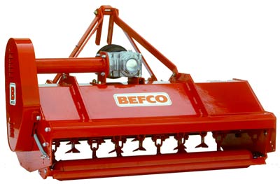

You're limiting your analysis to the geometry of your Italian style floating bracket. They're much less common in this country, compared to the 90 degree parallel bar type and the 180 degree U-type. I don't know what the exact arc-equivalent of your sliding style might be, but I'll speculate it equates to no more than 45 degrees. So I don't doubt what you say is applicable to your machine.
90 and 180 degree pivoting styles on the other hand, require a shortened toplink for transport and a lengthened toplink for mowing. Again, I refer to the earlier photos as evidence. They depict the 90 degree type. The arc on a 180 degree is even more radical. Depending upon how low you've set the lower lift arms, lifting the flail into the transport position may not even get the roller off the ground. Or at least cause it to hit the ground if/when the tractor rears go through a dip.
The factory photo below depicts a flail with a 180 degree pivoting U-type bracket
//greg//
