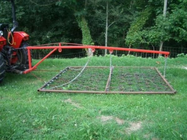

I don't think it penetrates far enough to be considered a competent aerator - in my sandrock and clay Kentucky hillsides anyway. I use mine for pasture and road maintenance. It's great for "tuning up" wet gravel roads. I've always hated that "hump" in the middle of so many farm roads. Running the chain harrow over mine a couple of times a year - after a good soaking spring/fall rain - keeps "the hump" from ever getting started. It's also useful for spreading the rotting hay that's collected over winter around the feeders. One fall I had a bumper crop of that useless brome sage. After cutting all the seed heads with my rotary cutter, I raked it into a burn pile with the harrow. The otherwise natural tendency of the teeth to clog works to your advantage in situations like that.
Of course, you can't do jobs this unless without the ability to lift the harrow with your TPH. Most importantly, I use it to "scratch in" fresh seed/fertilizer/lime. For this job, I put the PTO spreader on the TPH, and just drag the harrow with the drawbar. As the material hits the ground, the harrow scratches shallow grooves in the soil. When done parallel to hillsides, this also keeps a lot of what you spread from washing downhill during the next rain.
After the big increase in steel prices a while back, chain harrows look rather expensive on the surface. But considering all the things I use it for, I think they're well worth the money. Having said that, I wouldn't have (a big) one that you couldn't lift with a TPH though. Mine's 8'x8' without the frame - weighs probably 400# with the frame - and is lifted with a modified light duty boom pole.

thanks for the pic, and great description. I haven't had any luck picking mine up with the boom pole, so your pic is a huge help!
   / Chain harrow in thick grass #7
If you're interested - and are willing to continue this via email - I have more photos, materials, measurements, et cetera.
