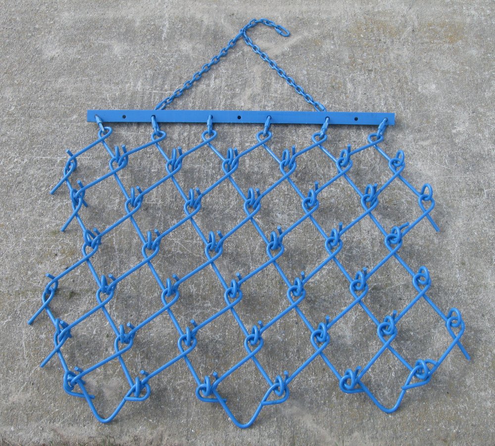

These look SO SIMPLE that I have to believe someone has worked it out (-:
Just looking at the links and how they hook together, almost like stitches from something knitted.
Anyone figure out how to chop re-bar into short lengths, wrap them around say 2 or 3 different diameter steel pipes to bend them into shape for a harrow and hook 'em up ?
It might take 30 or 50 of them, but once the geometry is figured and the jig built I bet it would be quick.
Heck, it might even be worth buying a cheap hydraulic pipe bender from HF (-:

I used to make chain armor. What you want to do is wrap a whole length of round rod around a mandrel (it'll look like a garage door spring) and cut the links off with an angle grinder as you slide them off the end.
   / Chain harrows
Thanks for your reply.
That would help me if I wanted coils or simple round links.
Chain harrow links are bent around in 3 directions and (at a guess) could probably be made by bending re-bar around a pair of pipes that are criss-crossed, perhaps it takes three pipes and maybe not at 90 degrees to each other, maybe different diameter pipes.
Again, my guess, but one could then slide the pipes out to release the completed link, which would have it's two ends as the "teeth".
I was just asking if anyone here had figured it out and could post some details.
My ability to imagine in 3D is very limited (-:
BTW, I am NOT an English teacher, or even an English major, though it is my primary language.
My initial post did not indicate that there would be pictures for the reading (of English) challenged, sorry to disappoint.

Most good chain harrows are built out of high grade 5/8 inch 1060 steel because you want long life from your machine, I believe after a few uses, rebar would wear down pretty quickly. Just my humble opinion. Ken Sweet

A couple of years ago, when I was shopping for a chain harrow, I ran across a video on a manufacturer's web site which showed the manufacturing process. It was pretty involved...especially assembly of the finished harrow. Sad to say, I can't find that link again (I tried, really!). I finally found a used 12-footer for a couple of hundred dollars. I'd never have been able to build one for that, even if my time was free.

Sorry Reg.. but here ya go..

Not sure if this link will work;
http://www.williamhackett.co.uk/agriculture/media/tine_action.gif
This looks like two very simple parts that could be sprung together.
The loops on the right hand end of the horizontal piece hook to the bottom of the V of the next horizontal piece, AFTER that piece has a vertical piece attached to it - repeat until long enough.
To make it "by hand" one would probably hammer the loops shut after assembly.
Thanks for the reminder Ken, every time I think through things like this you step in and remind me - or the nagging little voice wakes me up and says - "but soil is ABRASIVE !"
