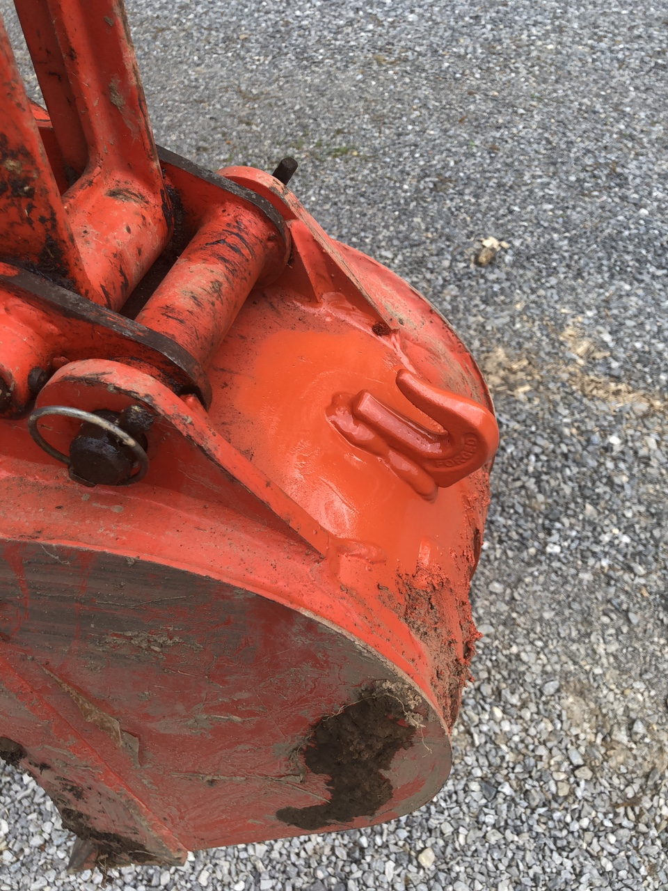

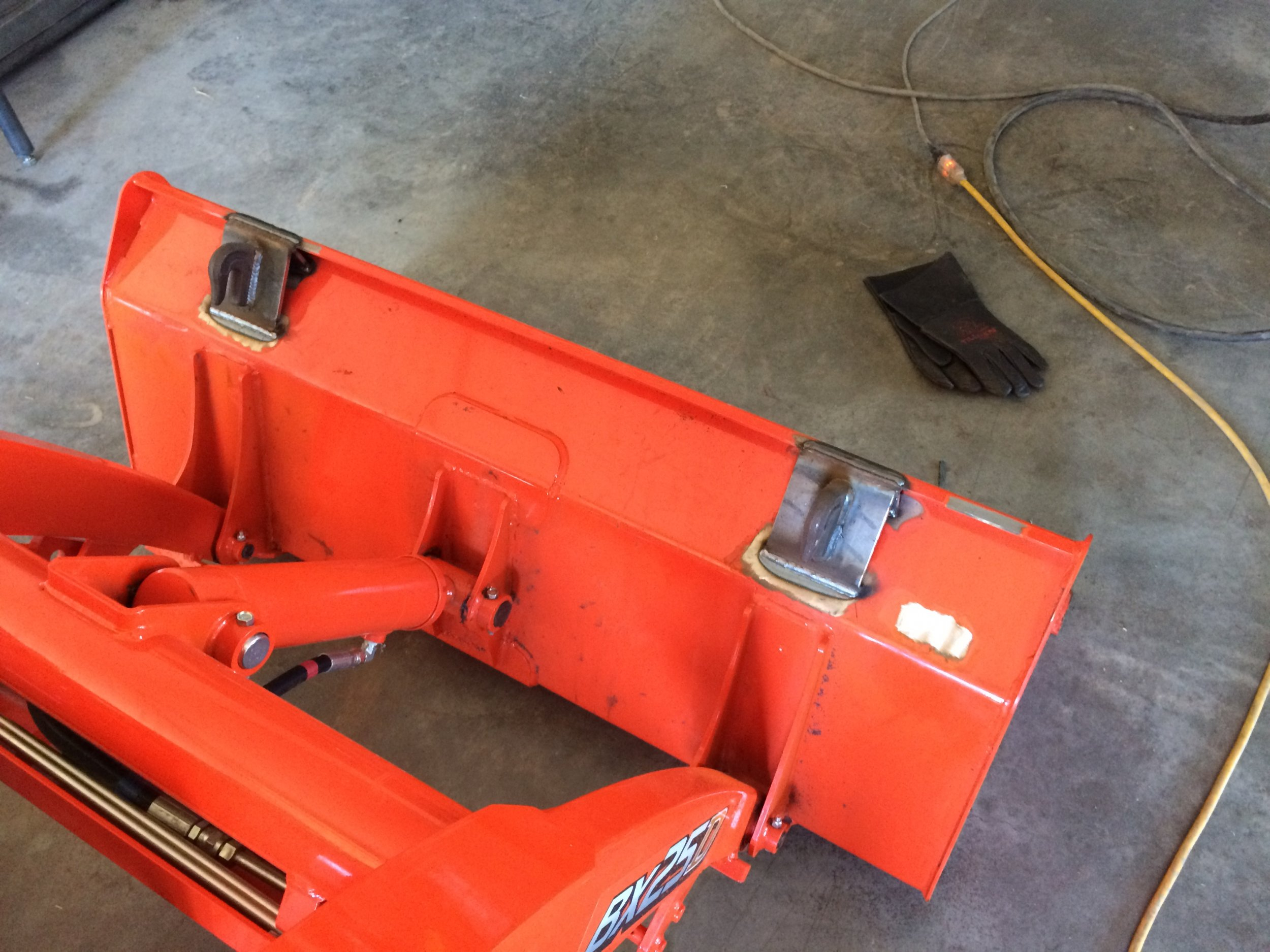

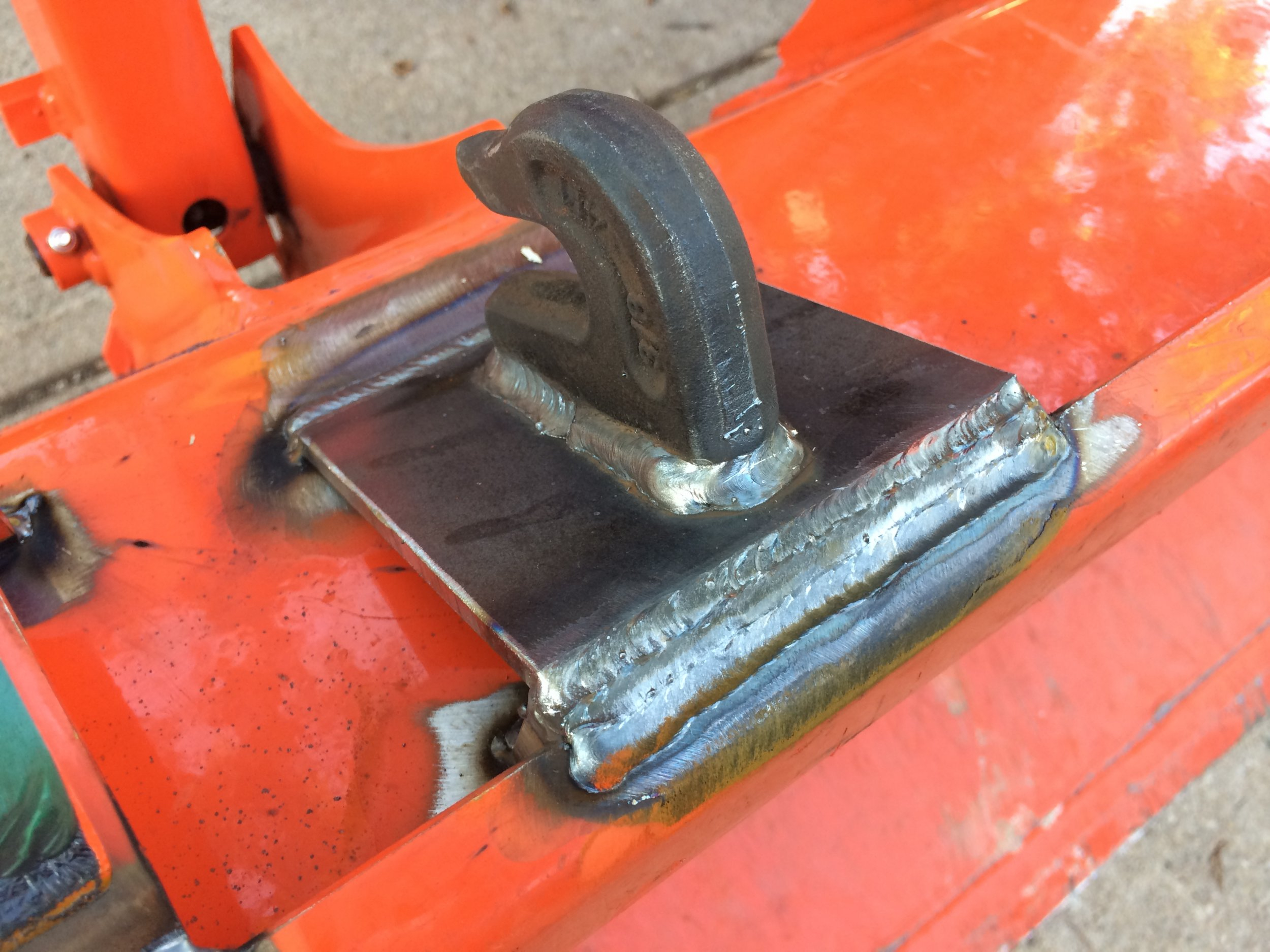

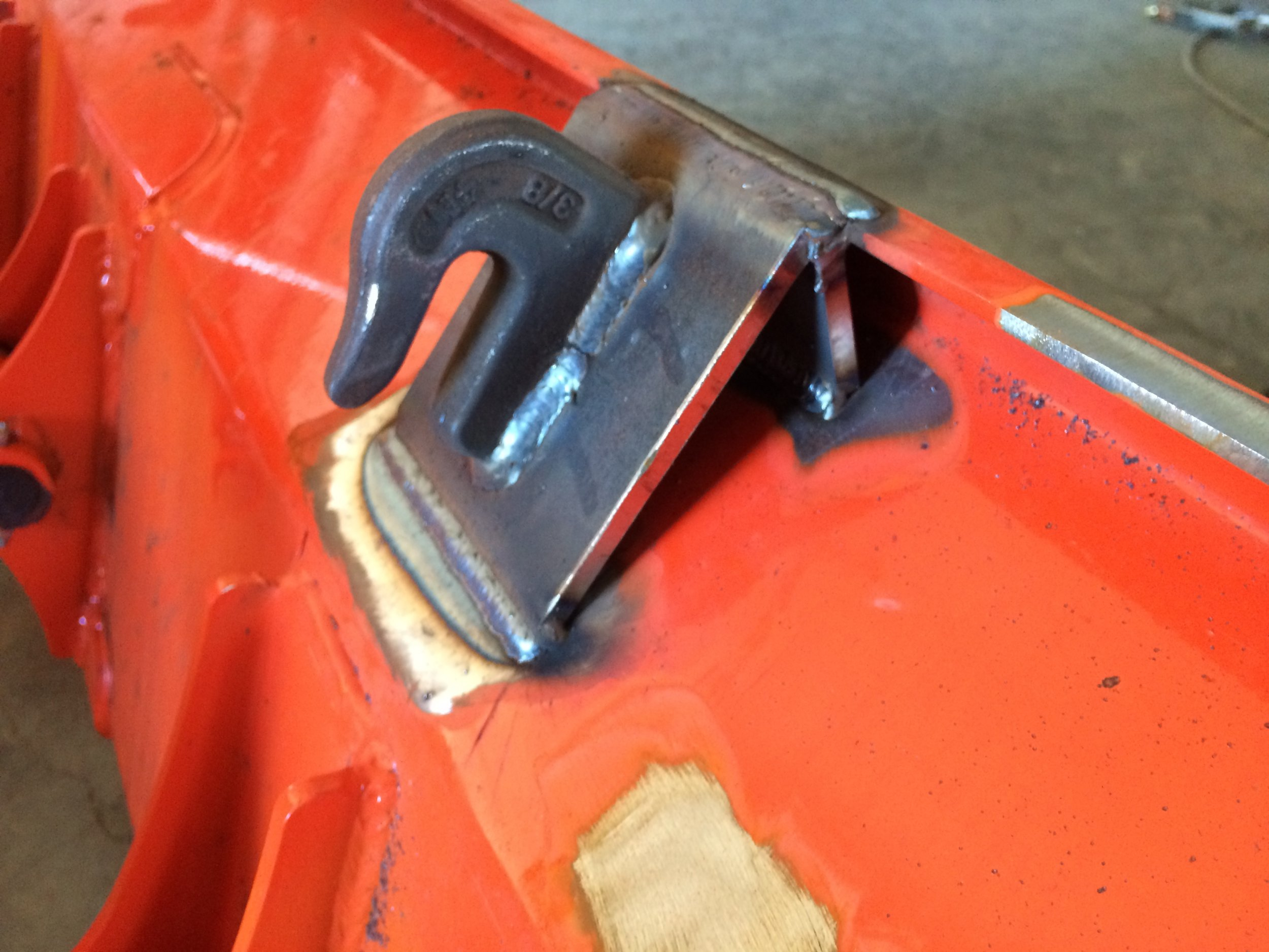

I've never been big on hooking over forks due to the risk of slipping off. Also not thrilled about the hooks on the bucket since it limits you to a chain (risk of damage depending what you are lifting, and the chains most people use technically aren't rated for lifting)
On my loader buckets I have a couple of holes drilled (or torch) into the bucket. One in the middle of the cutting edge, and a couple along the top edge of the bucket. Easy to shackle through, and attach chains, wire rope, or synthetic slings as required.
