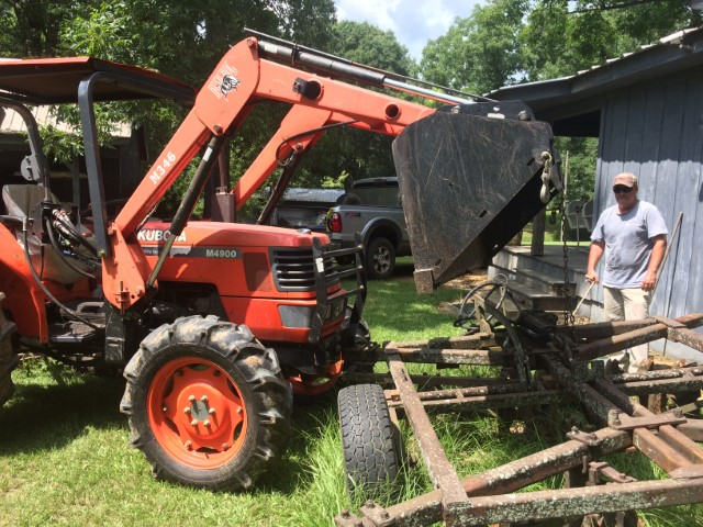

I did not read all the previous comments, so this may have been mentioned before. I have a 2" Trailer Receiver Tube welded to the middle of the top lip of my bucket. Allows the use of 2" receiver with chain hook welded on. Also allows use of 2" Receiver with ball size as required. Handy for moving boat / trailer etc. Quick change.
Also have pallet forks, which I find invaluable. One instance where chain on pallet forks could be used (so far I have just used rope) is for planting trees. Spread forks apart and tie rope / chain to each side of large root ball, one rope to each fork & it is very easy to lift the root ball / tree and set in prepared hole.
The Boom in the pic is more elaborate and stronger, but something similar can be made by inserting the upper tube for a boom in the receiver tube and running supports to the lower lip of the bucket.

I am well pleased with having my hooks on three links of grade 8 chain and bolted to the top corners of the bucket.
The chain allows them to swivel as needed.

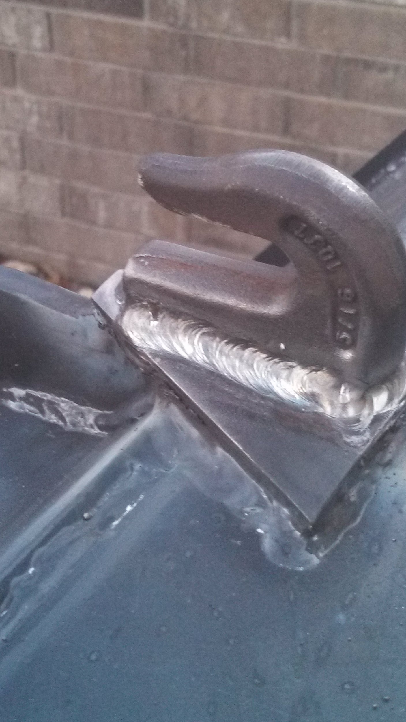

I weld stuff so it never occurred to me to bolt them on. I can find a handful of 1/8th some wire or the other on the welding trailer. I would have to sift through a bunch of homer buckets to find the right size hardware to bolt stuff to the bucket.

Yeah, but my stick welds are pretty and strong. :)
Note how crummy of a job the Korean with his MIG welder did with the original pad.

Chains slide on forks. Weld 3 hooks on the bucket. Cheapest thing you can do to the tractor.
