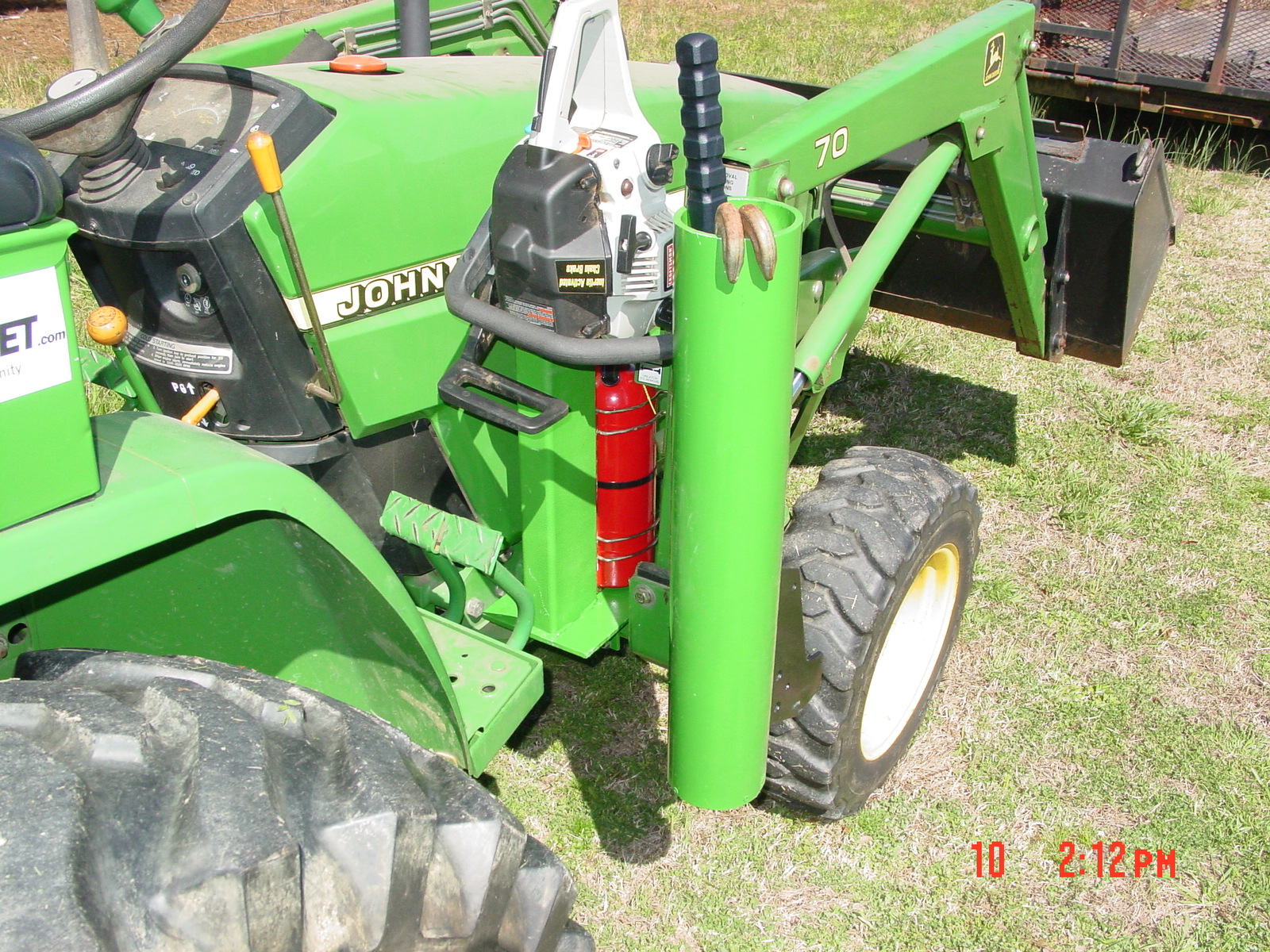

Really nice looking job. My logging winch came with a chainsaw mount but I have been thinking about relocating it to a better spot. I may move it to a similar spot under the loader control but it still won't look as nice as yours.
/ Chain Saw Holder #32
Nice work. Not many guys would have the vision to build a chainsaw holder that approaches being artwork.
It is nice!! My chainsaw holder is close to the same location, it's inboard of the FEL mast on the right side. But, sadly, mine has no artwork on it, it's just green. :( I still like it, though. :p
