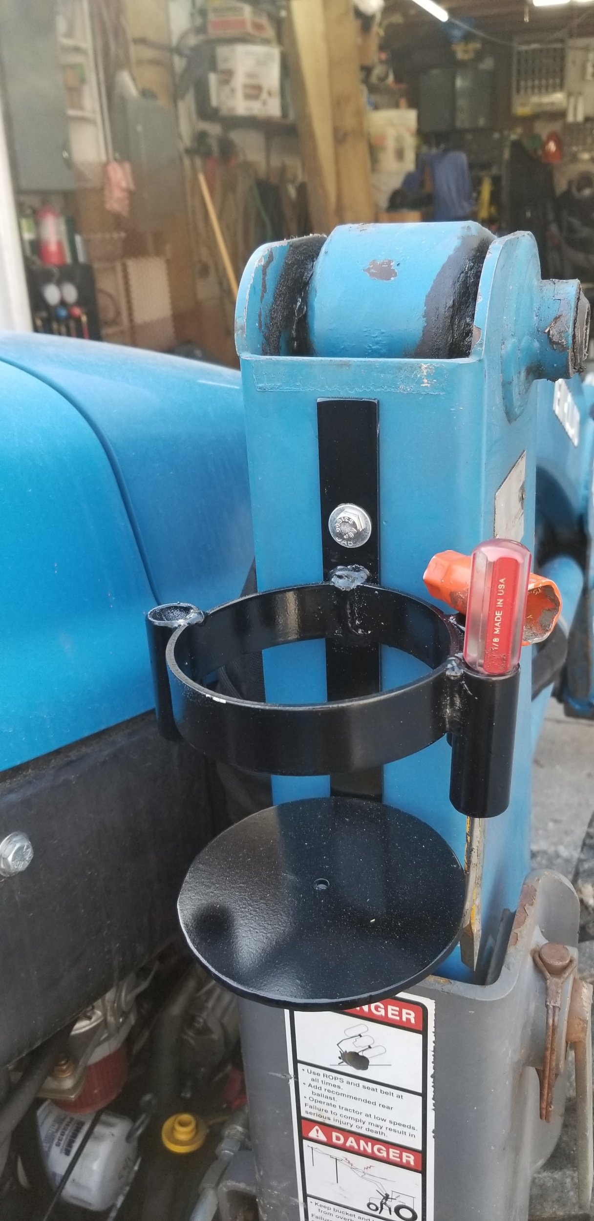

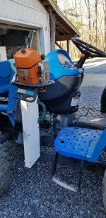

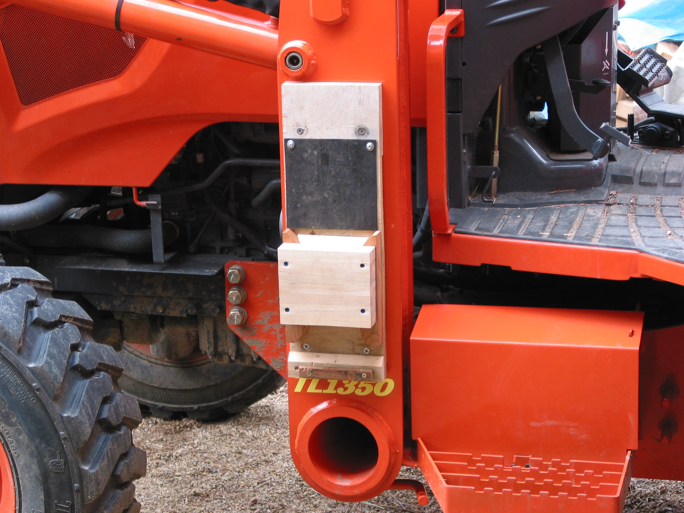

/ CHAIN SAW HOLDER? #5
Make the saw holder out of something other than steel. Steel on your chain dulls it. This one was plastic I had laying around..complete with child handle to help my little one get on/off the machine.

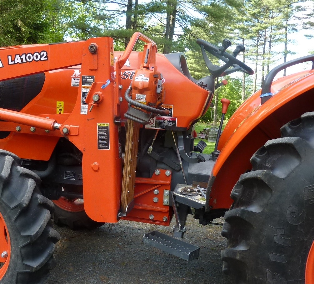

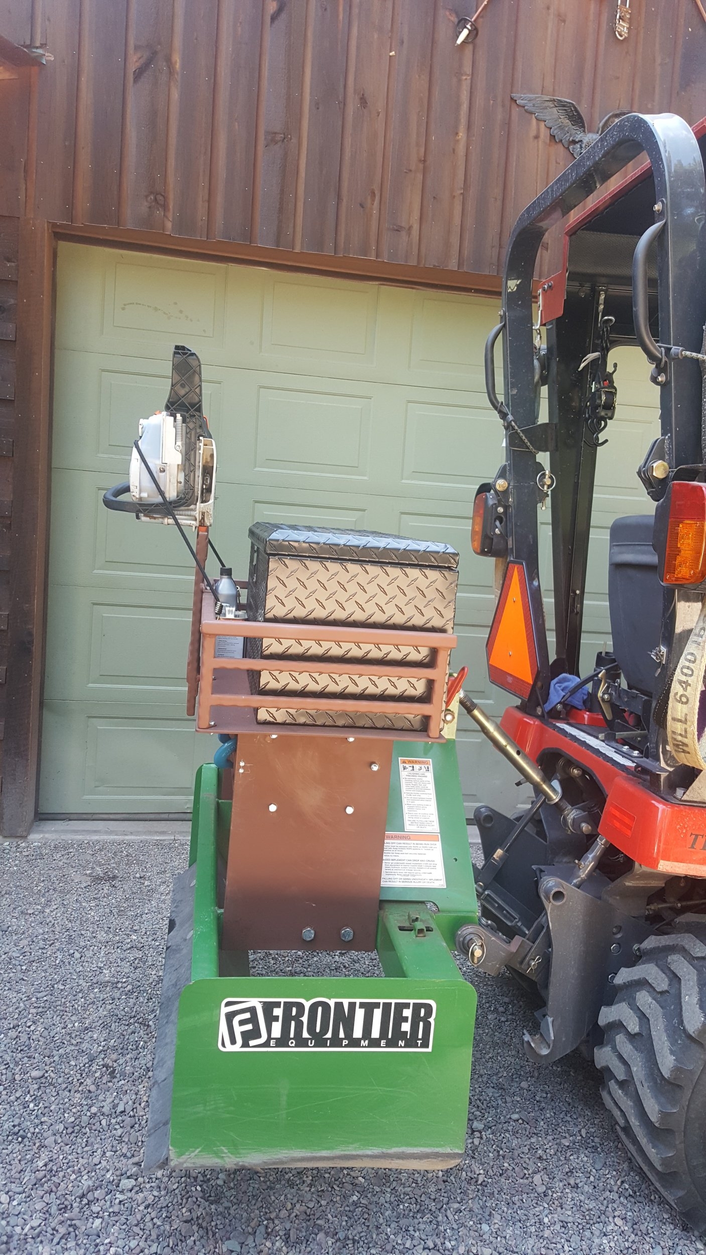

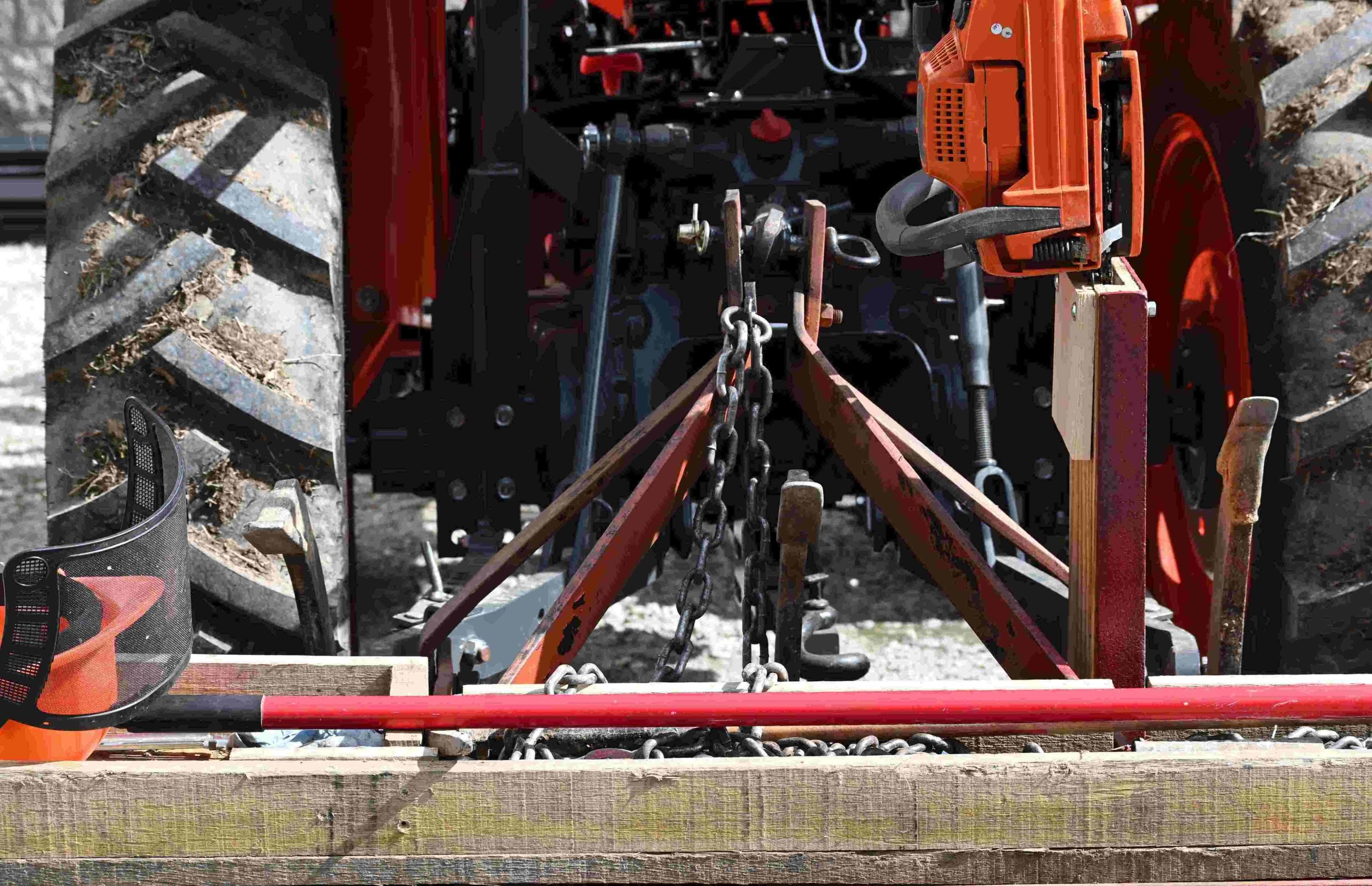

/ CHAIN SAW HOLDER? #6
Couldn't find a good place on the tractor so I made a mount for the box blade. The frame is metal, but has wood to protect the blade. Also made a wooden insert for the box blade to carry chains and other tools when cutting trees.
The search tool will often find useful information. Very valuable tool.

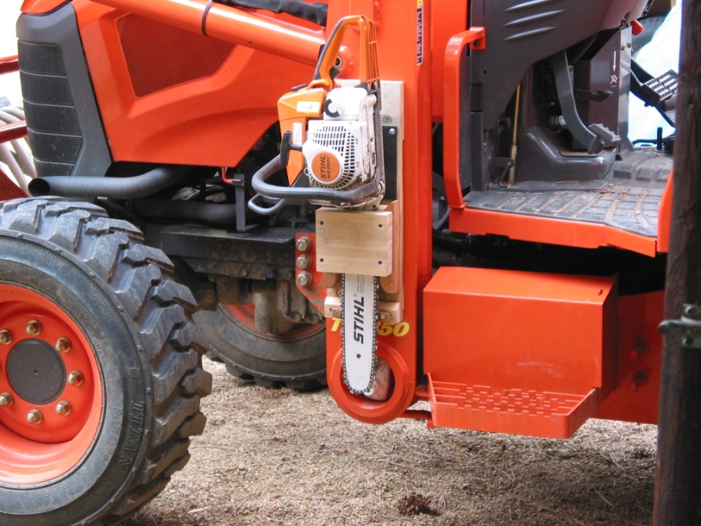

/ CHAIN SAW HOLDER? #8
Here's a chainsaw mount I'm looking at. It was designed to be installed on a motorcycle, but they've adapted this one for a side by side. It appears to be an aluminum body with rubber/ plastic stop pads. As it comes, the scabbard will take a 16" bar, but additionally, you can order a 20" scabbard. This one comes with a right-angle mounting bar that could easily be adapted to a ROPS or crossbar installation.
Enduro Engineering- Chainsaw Mount

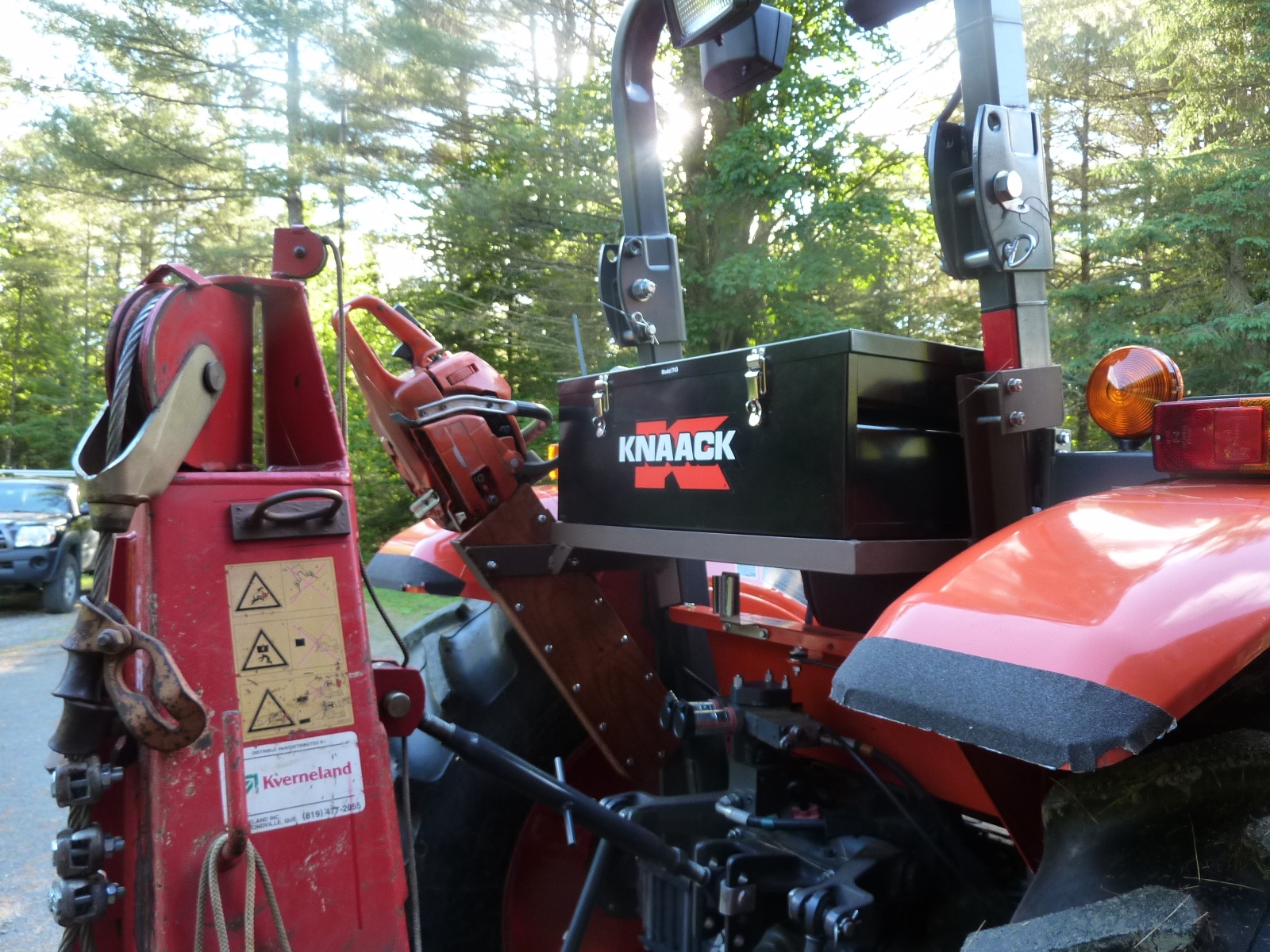

/ CHAIN SAW HOLDER? #11

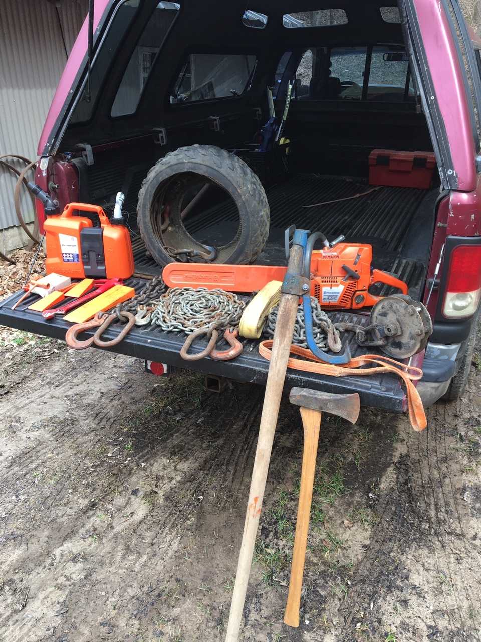

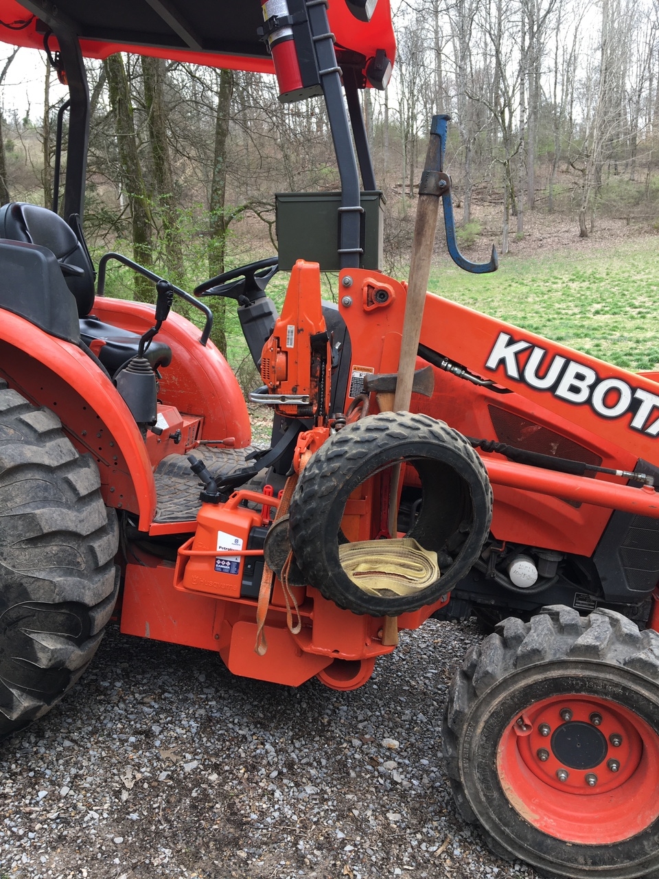

^storage is absolutely worth mentioning. For me it's never just the chainsaw, but it's also carrying gas, oil, sharpener, chain, gloves, and helmet with face shield and ear protection.
Smokeydog made a chainsaw carrier to fit the bottom of the FEL mount that also will carry his fuel and chains.
