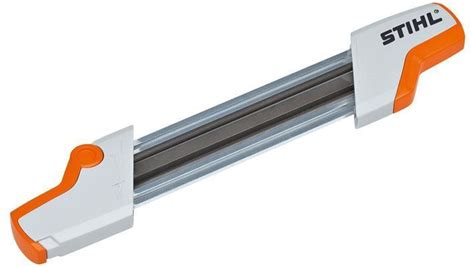

I like the file system for Stihl saws. Some where about 30 or 40 dollars. Has file to sharpen the teeth, file the drag and keep you on angle. For me simple and works very good. I have tried the Dremel type tool and the Harbor Freight grinder sharper and other than the Stihl the best I had was a tool with round file that keep the angle fixed.
