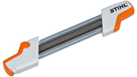

I tried special Stihl file. Continue to use the Dremel with round stones. Bought a new set of 3. Got at Lowes.
