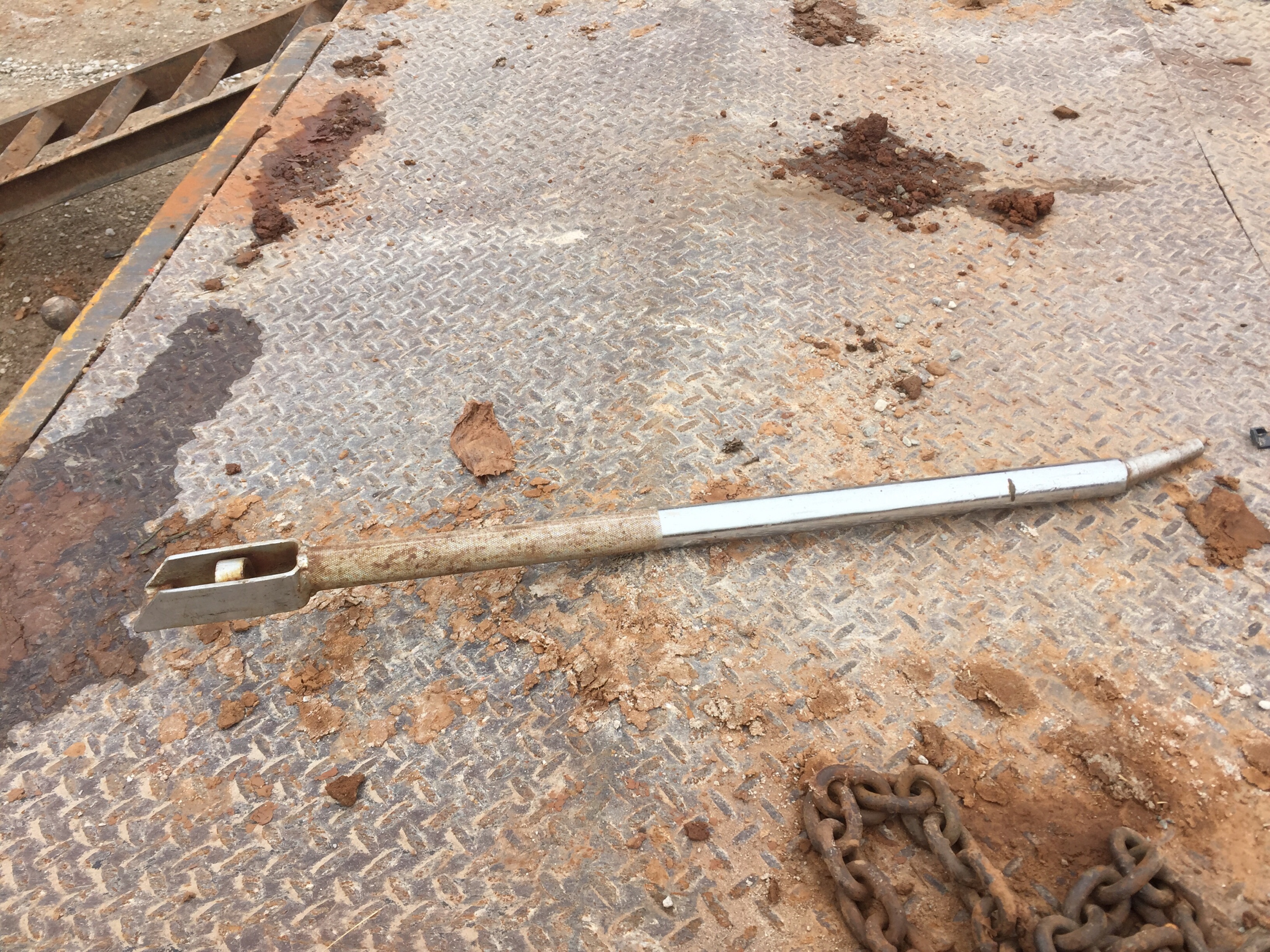

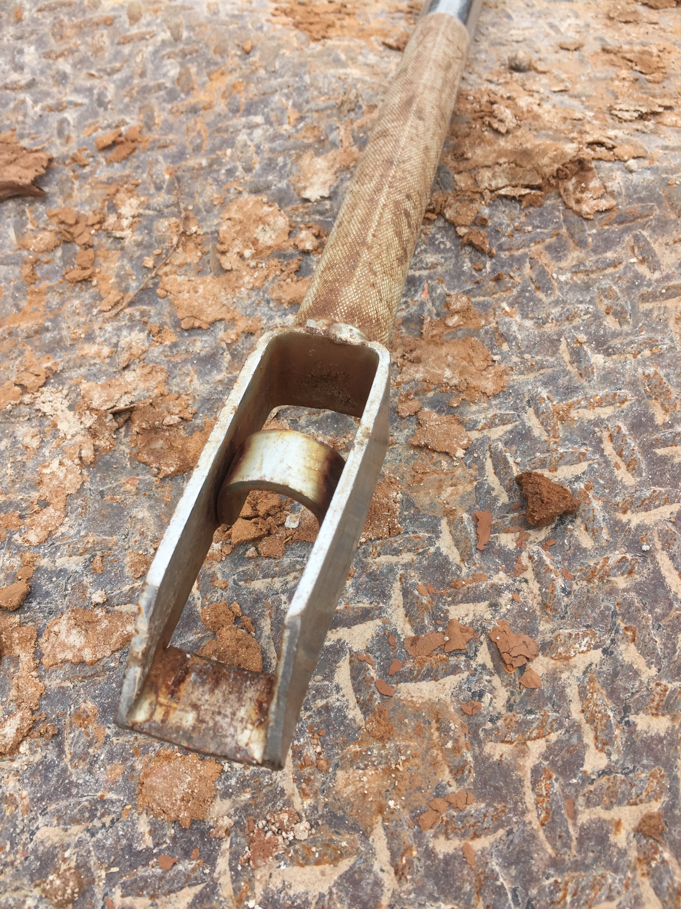

I keep noticing people talking about using pipe or such to extend the handles of chain binders. This works ok for tightening the binders but are very dangerous or just unusable for undoing the binders. Using your hand to undo them is fine most of the time if great care is taken to not grip the handle of the binder. Instead making sure to only use the palm of your hand. Binders can come under great strain due to movement of the load and at times when they come open it is with amazing force. Easy to get hurt. I learned about and started using a bar made to be used on binders and on large strap turn buckles. The small end is used to tighten and loosen the large strap rachets on the side of trailors. This bar is so much safer to undo binders. It allows the handle of the chain binder to swing free from the extender and also allows you to stand back a bit from the load in case it tries to shift and hit you when opening the binder. Post and pipe is really bad about this, lumber at times.
   / Chained Tractor down for first time. Assess and Critique please. #48
That's a nifty tool. I've seen the pointy end bars for tightening the ratchet straps but never the lever binder end. Did you purchase it or make it yourself? Does it have an official name? (for searching on the web)
   / Chained Tractor down for first time. Assess and Critique please. #49
Try
combination winch bar
