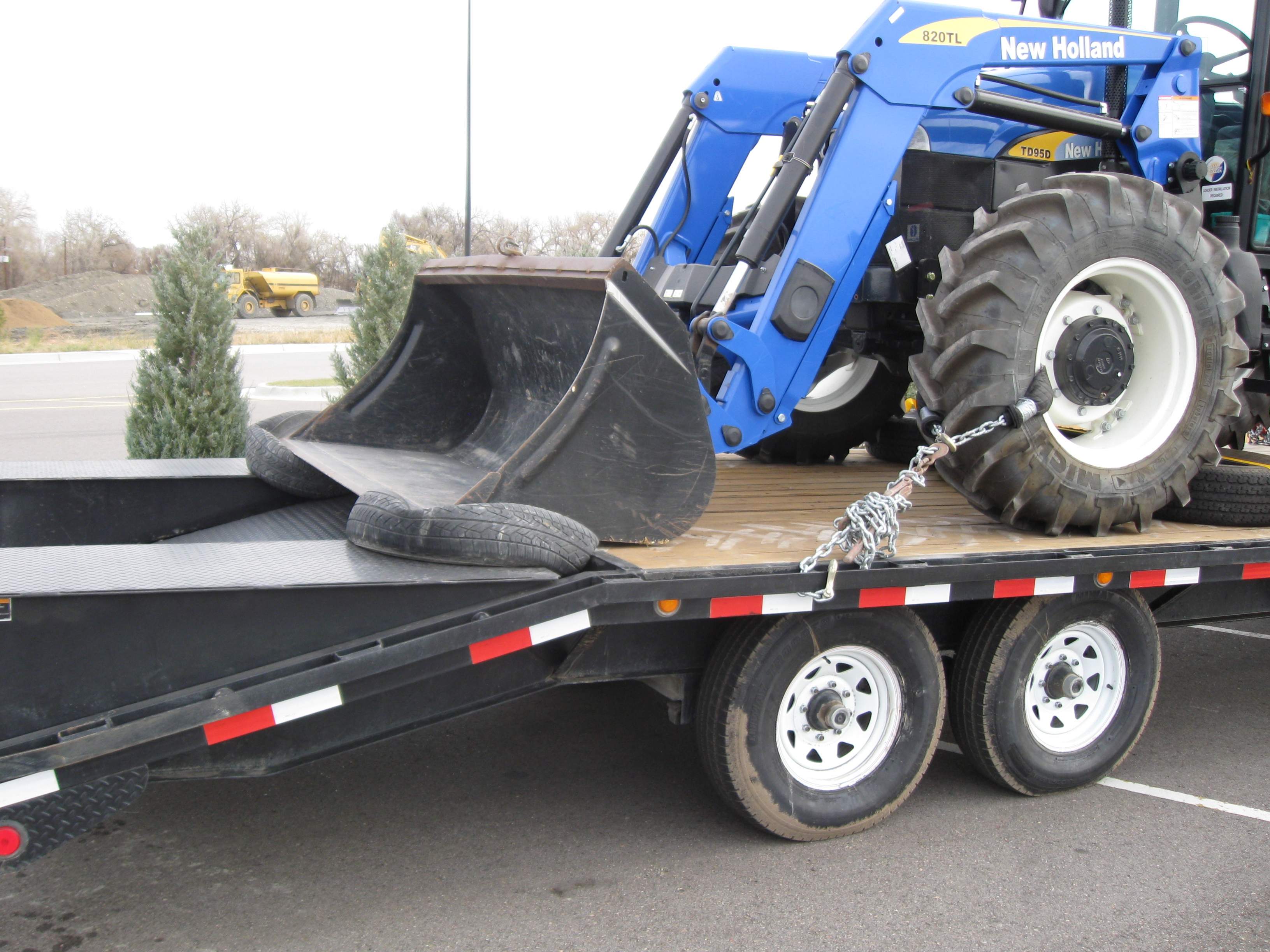

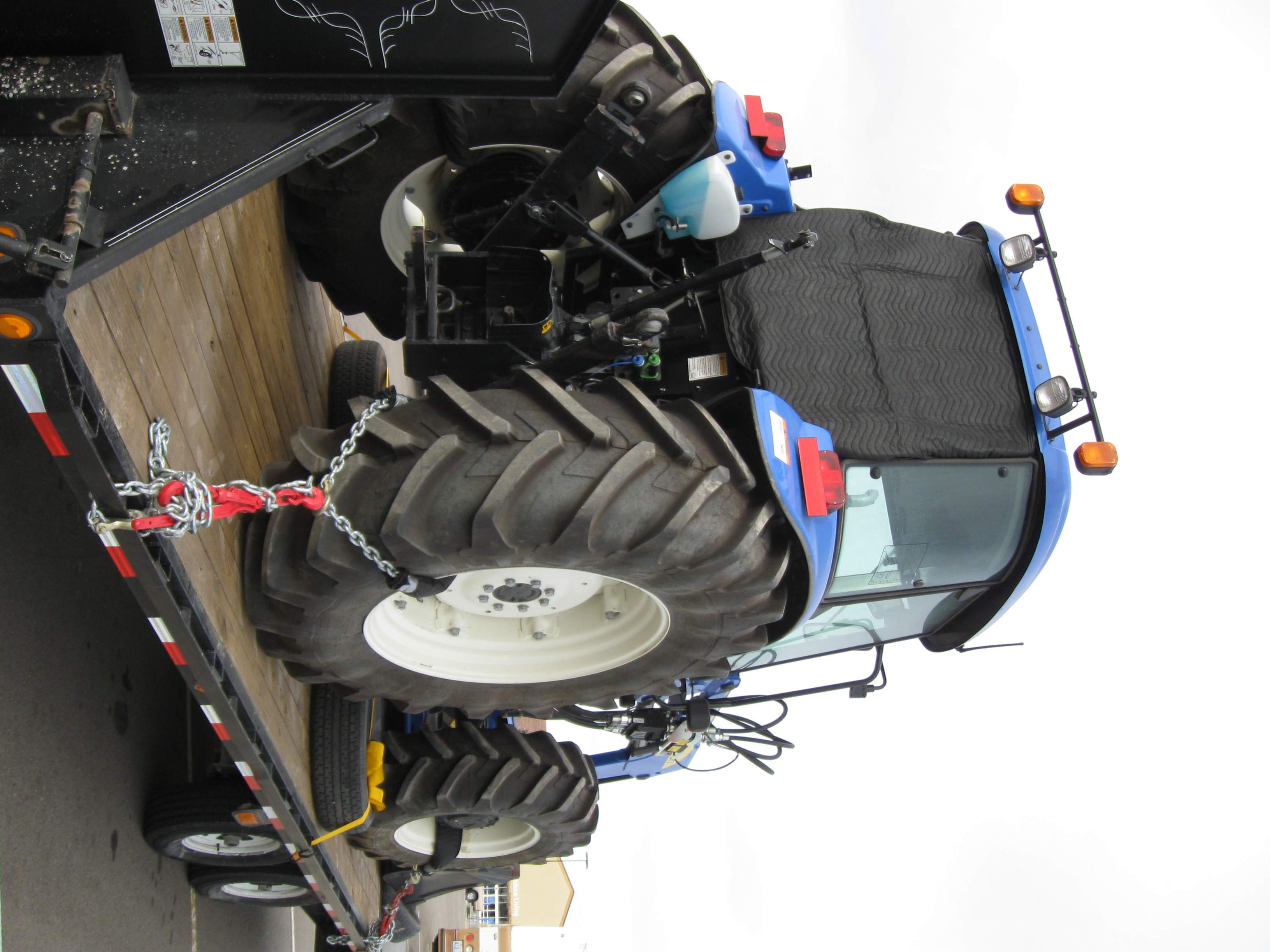

i work for a tree co in new england we use a asv rc 100 what ways do you guys chain down your machines
I hauled a NH TD95D with 820TL Loader from Hagerman, NM to St. Ignatius, MT through the first major snow storm of the winter in the NW. This is how I hooked it up. The tractor never moved even when I blew a tire on Raton Pass.
I used 3/8" x 14 ft chains on all four corners. I cut moving pads from HF to wrap aroud the chains so it wouldn't gouge the rims and wear the paint off. I used a couple of old tires under the bucket to elimate chaffing. I opened the rear window and placed a moving pad on the window and then closed the window on the pad trapped in the window frame to prevent glass breakage from flying stones. (The tractor was backed on to the trailer and the cg of the tractor was parked over the the point on the trailer that met the truck's rear axle load rating as best I could estimate them.) I also taped the exhaust over with duct tape to prevent the turbocompressor from windmilling without an oil supply to it's bearings.
The tractor came through with flying colors as I drove through freezing fog in Wyoming and below zero temperatures in Montana on glare ice covered highways that should have been closed. The driver (me) was sure glad to get home through all that bad weather.
