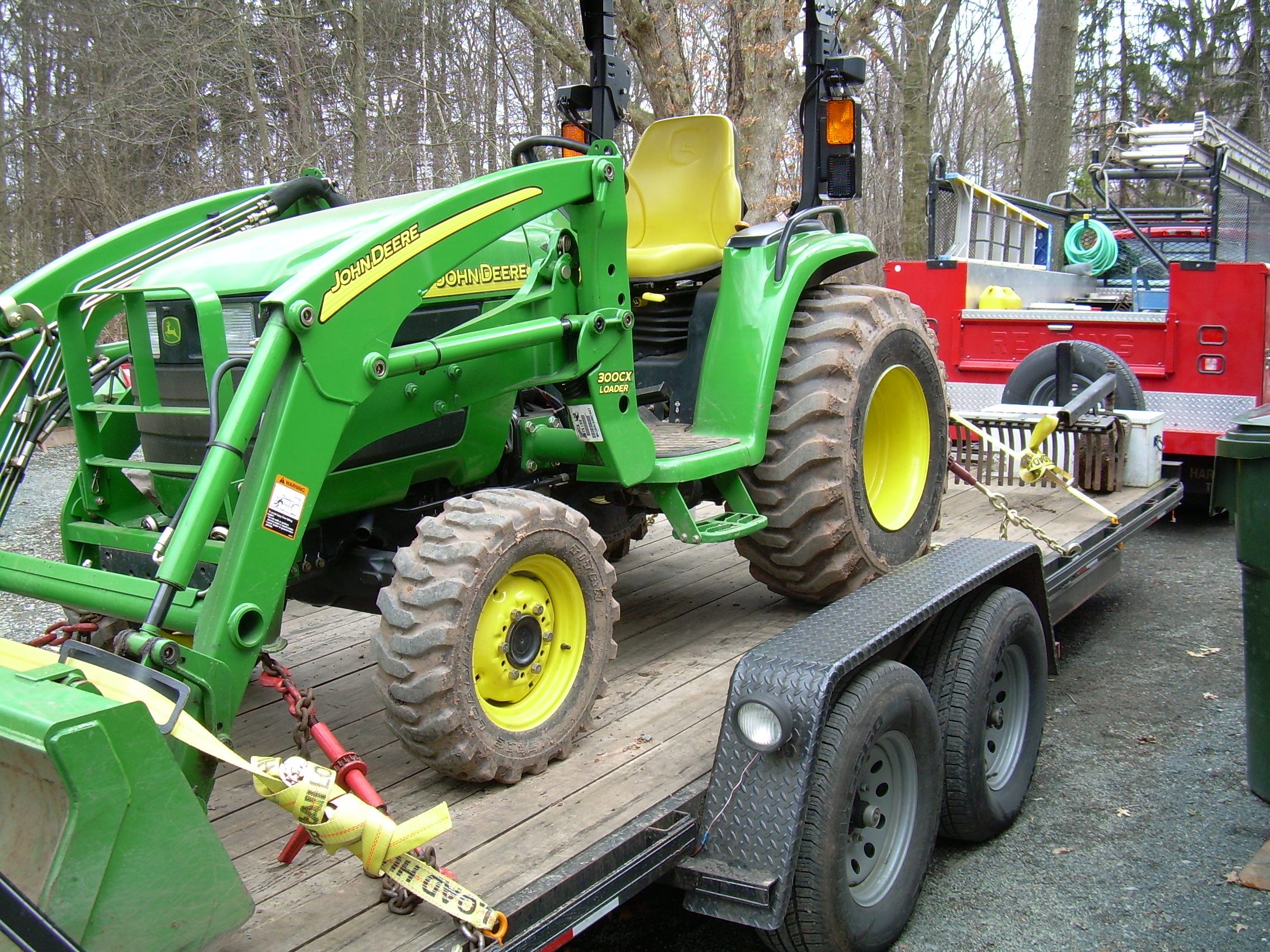

I use 4 point 3/8" grade 70 chain tie-down for my CUT. I use a strap for loader and anything that's on the 3pt.
I feel totally secure with this setup.
