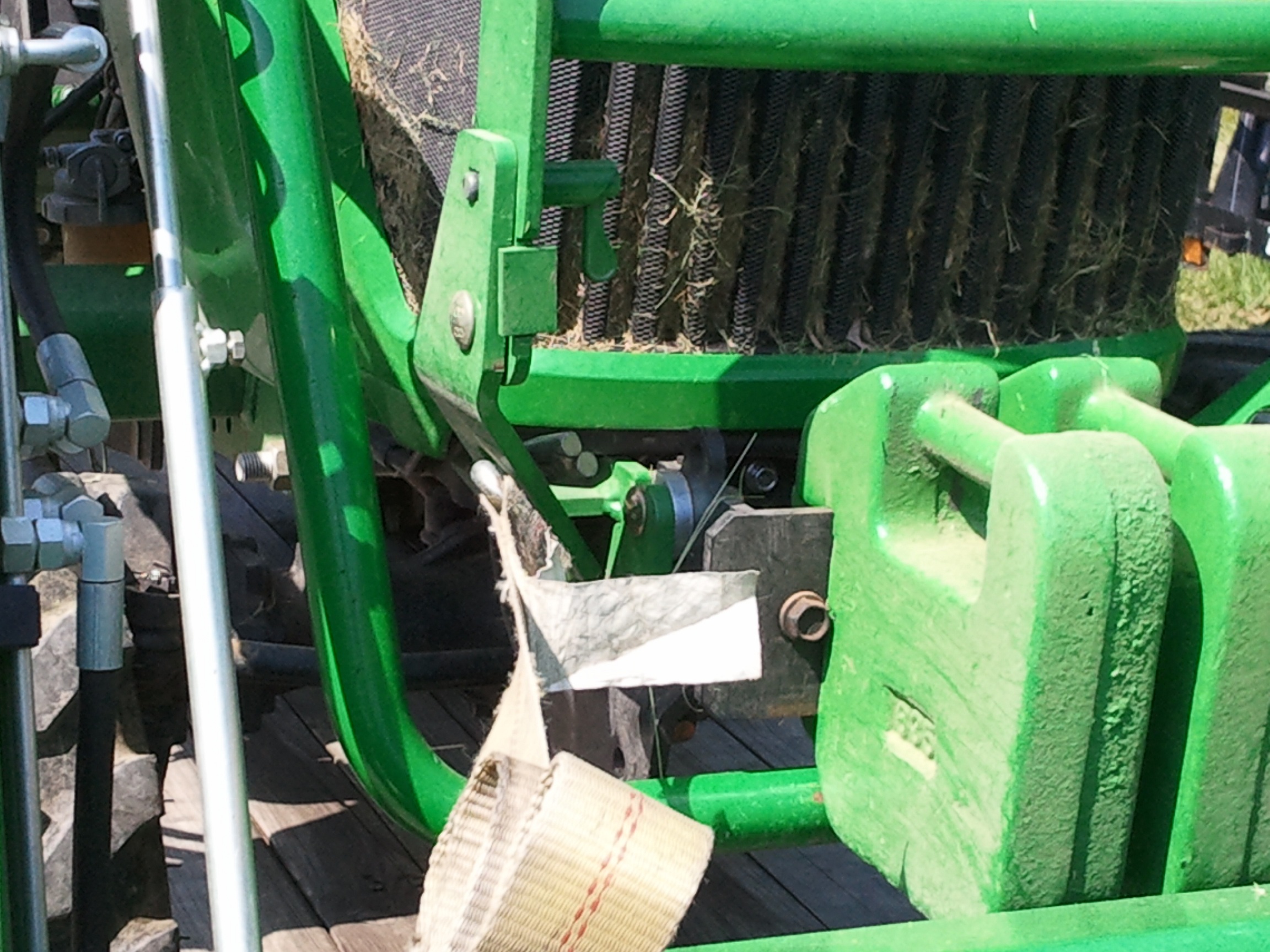

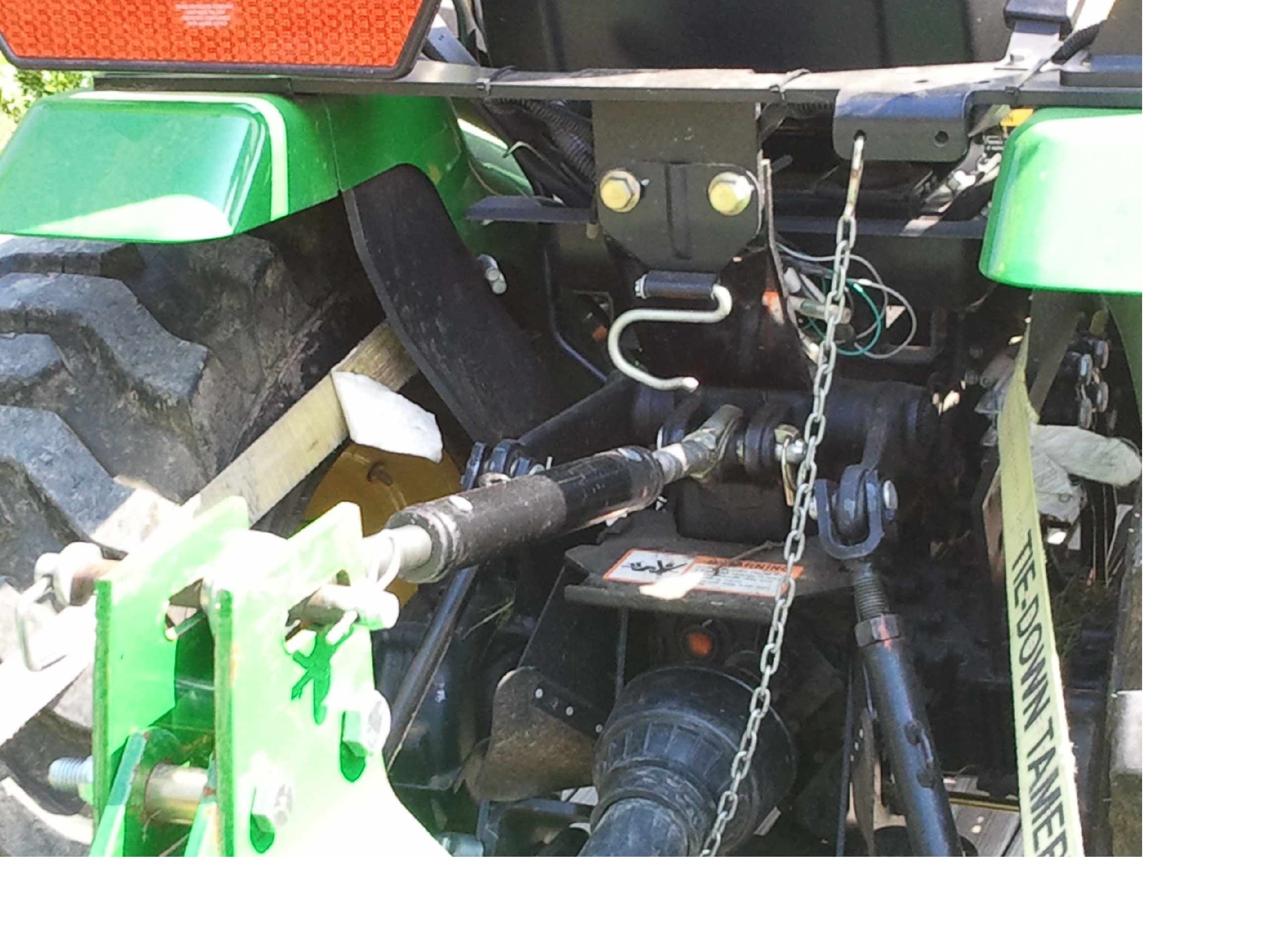

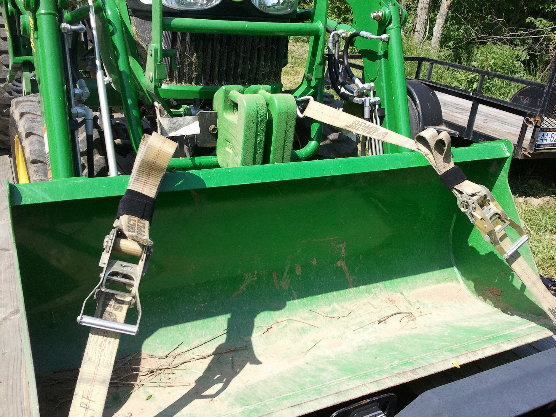

/ Chaining it down ? #8
I use the two holes on the brush guard in the front. And in the back the main supports in the back on each side there is just enough room to slip in a set of hooks on each side between the tire and tractor.
Oh, and I prefer straps, but cheap straps can have issues with stretching. I use a 10,000# break rated strap that has a 3000#+ working limit.
Also I recommend at least 4 tie down points in case of a failure with a tie down no matter what your state may say is legal/required. Chances are you don't have insurance that will cover replacement of the tractor in the event that it would fall of the trailer. Even if financed through JD I was told it would only cover the loan balance and your vehicle insurance is typically only liability.

Thanks again, megaboz and KennedyDiesel, for the details of the attachment points. Pictures ARE worth a thousand words :licking:
/ Chaining it down ? #11
I did notice on the rail in the rear there are two holes, might be able to utilize them to some degree to tie down. Maybe some kind of buckle or something, the only thing I don't like about hooking like that in the rear (like I did) is that I noticed because of my tractor position this time, they slid up some when I tighten the straps, still secure, just not the way I like.
Generally I back my tractor on, but having the brush hog on, my rear wheel hangs off a bit and I would rather have it hanging off then the bucket, plus for me is a weight/balance issue on the trailer. When it is loaded right, you don't notice it back there.
