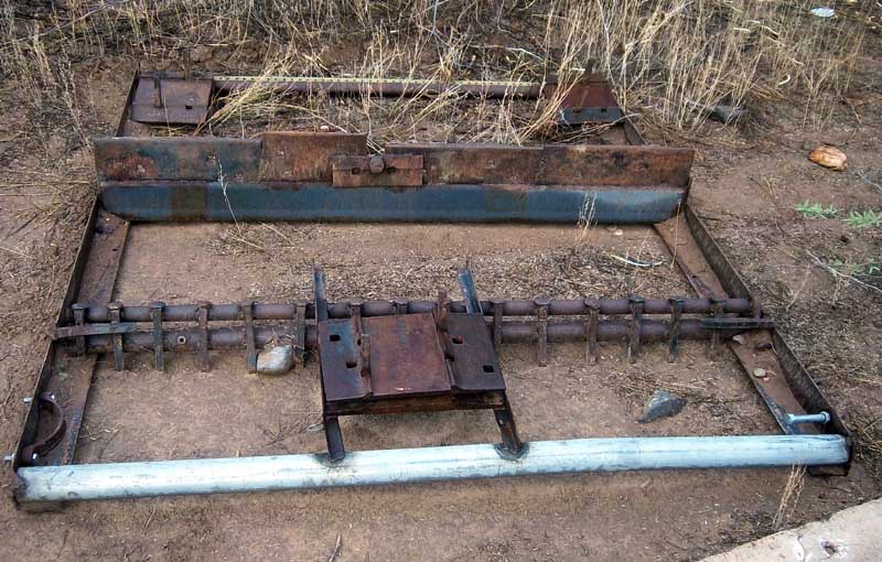

Pictured is my small drag / fluffer. The RR spikes go down about 2.5" and loosen the soil. They also pick up rock if its not too large or deep.
If set down on some chain link fence the spikes hold it in place, it leaves a nice finish and holds the rocks. Best to tow with the FEL so you can dump the rocks every now and then.
Simple & cheap to build. All material out of my Treasure pile.
