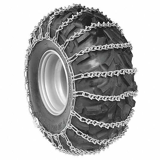

I found the thread with LouNY's description of the drive-on chain method: Mounting Tire Chains.
To recap his first post in that thread:
As I noted in post 37 of that thread, after 2 years of installing chains the hard way, I switched to driving them on, I can get my chains on in about 15 minutes a tire (and that includes dragging them out of storage and laying them out on the ground). If I put them on and off more regularly, I'm sure I could do it faster.
The one difference from Lou's method is, I tie to the center of one of the cross chains, rather than to the side chains. I find this works easier, since I can leave the string on, and it leaves the side chains free to make the connections. The string comes off after the chain connections are made.
On a friend's tractor with not much tread left, I run the string through one of the holes in the rim, instead of hooking it over the tread. I've not installed chains on large turf tires, but I suspect the string through the hole in the rim would be the way to go on that type of tire as well.
The rest of that thread is worth reading through: there are some other good tips and experiences mentioned.
