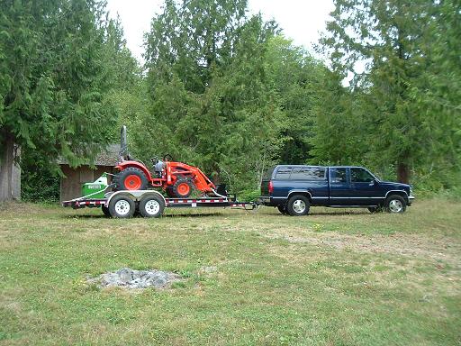

You don't mean my picture do you Thorndike? I thought it was pretty level and wouldn't change a thing.
I use a 10k rated WD hitch with 1000 lb spring bars, which by the way is not a sway bar. I really like the WD system.
   / Chains and binders #60
Your vehicle seems to be sitting like it sgould, must not have been yours, but they are on here, and the road. I've a WD system for my traveltrailer, wiht a sway bar also. I've never needed this system on my 12K flatbed, or my little 7K Haulmark tandem, 7X14, but I wouldn't consider not using it on the TT.
