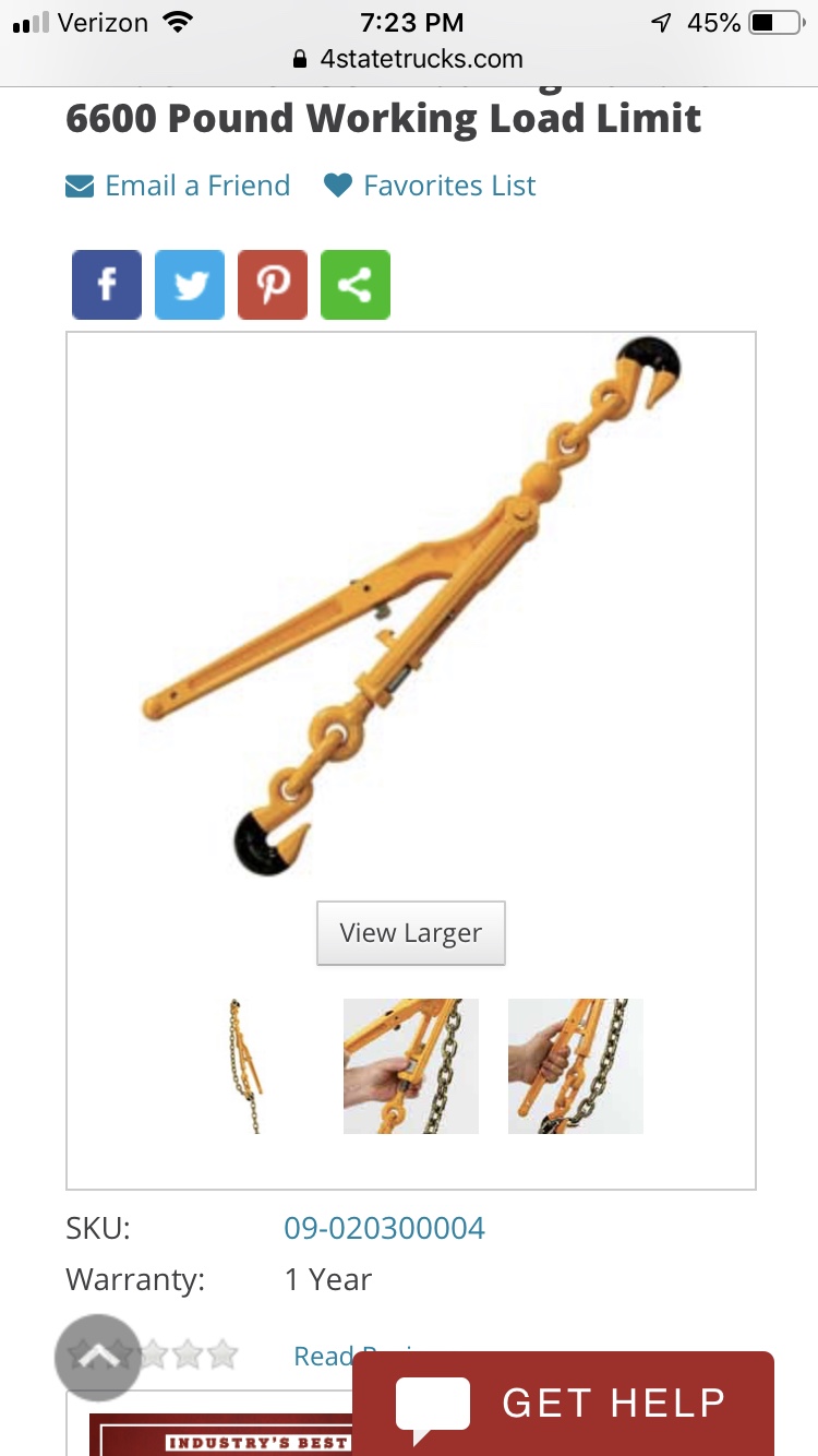

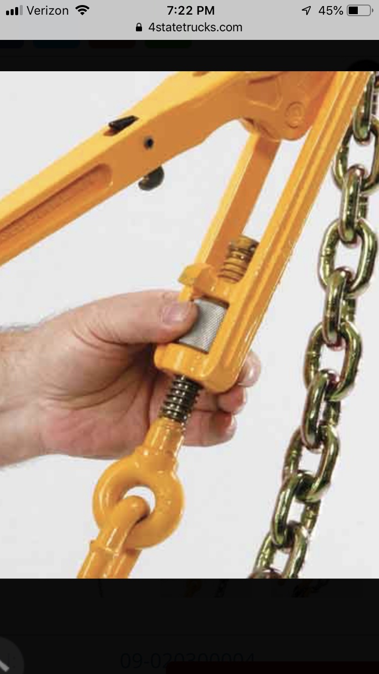

I saw these binders at a local parts store. I’ve never used them but I like the idea. The problem with lever binders is they hardly ever land just right and you end up having to hook them too tight and put a pipe on them. The problem is even worse with a tracked machine. With these you can fine adjust the length. IMG_8633.JPGIMG_8634.JPG

I just use the Ratchet Chain Binders safe, easy, fast if you use them all the time........
/ Chains & binders #68
They’re quite a bit slower than a lever binder and they don’t get along good with leaving them on the trailer.
/ Chains & binders #69
You grease the threads once in a while , Better then getting hit with a pipe in the face or launching the pipe in the air when it slips out of your hand , Been hauling flatbed trailers and equipment for over 30 years.....
