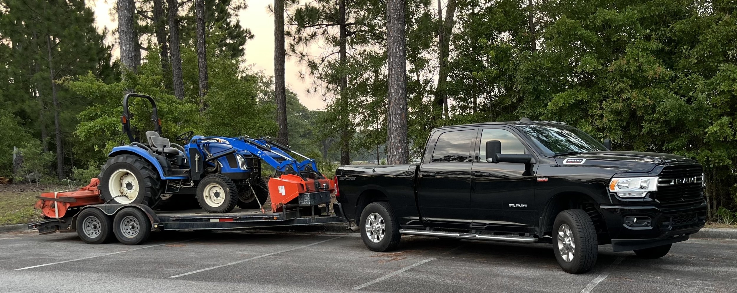

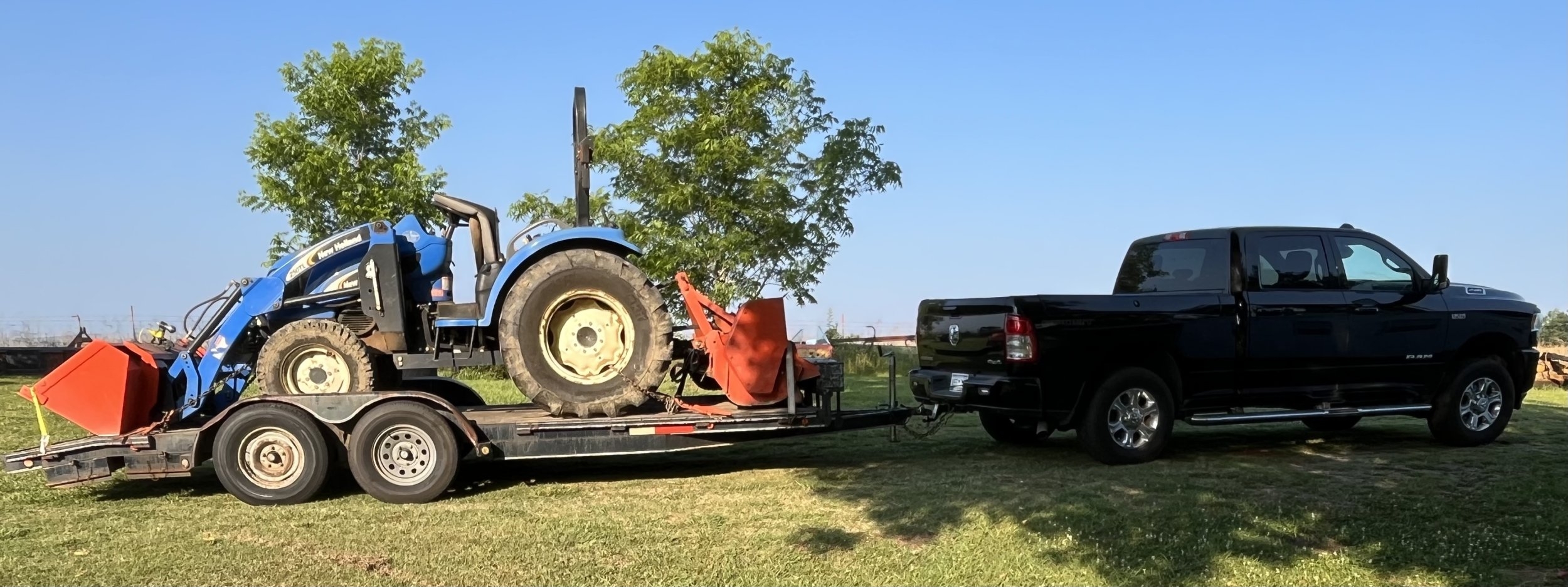

I use two chains but four chain binders to make four tie down points and I prefer 5/16” chains.
