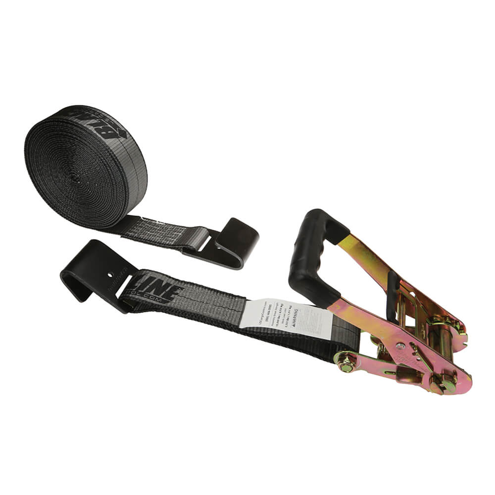

5400 WLL ratchet straps:
6670 WLL ratchet straps:
Not tie-down straps, but just to show that there are stronger straps than the commonly seen ones.
Straps to 76,000 WLL
Straps to 134,000 WLL
Heavy Equipment Recovery Straps | Machinery Recovery Straps | USCC
