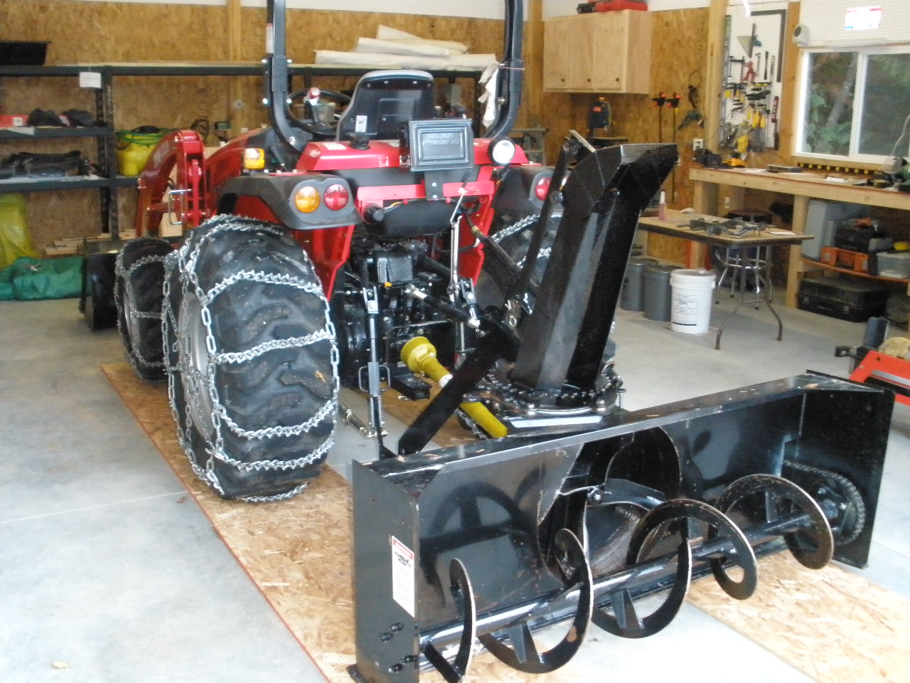

I have been using 4 link v-bars on all 4 tires since I bought my TYM 353 and love them. A little bumpy while riding but no slipping on packed snow or ice. They do eat up the shop floor hence the OSB to park on. I keep the tensioners on and the cross pieces have never slipped between the treads. Tirechains.com has been a pleasure to deal with.

kco, I have the same chains as you (that came with my machine), I haven't used them yet "because", they need to be modified, I have "5" links in between the "H" pattern making for a wide "H". And one link between each "H". I noticed on yours that you have "3" links between the "H" and one between the "H's", I'm thinking on reducing my "5" links to "3" like yours and possibly bumping up the "H" to that single link like you did in your mods. My question to you is, how do you find the ride now and do you leave your chains on all winter or just throw them on when needed.
The ride and traction are much better. Before the modification you could feel the chains slip and grab between the patterns. I bought a chain tool and it took a day or so to make the modifications. I install the chains in early December and leave them on until mid March.
If you decide to add patterns try to find a local supplier who builds chains and purchase bulk patterns. It was about 1/2 the price compared to ordering patterns from CanadianChains.ca. You will end up with a lot of spare cross hooks and side chain pieces when take the DUO patterns out of the bulk chain to add them to your existing chains. I used the spare pieces to make tensioners as shown in my earlier post in this thread. Here is a link to a thread about modifying the chains:
http://www.tractorbynet.com/forums/...-chains-planned-modifications.html?highlight=
I also prefer the pin coupler (rather than ordinary screw-type link or shackles) for closing the tail end of the chain to the start.
