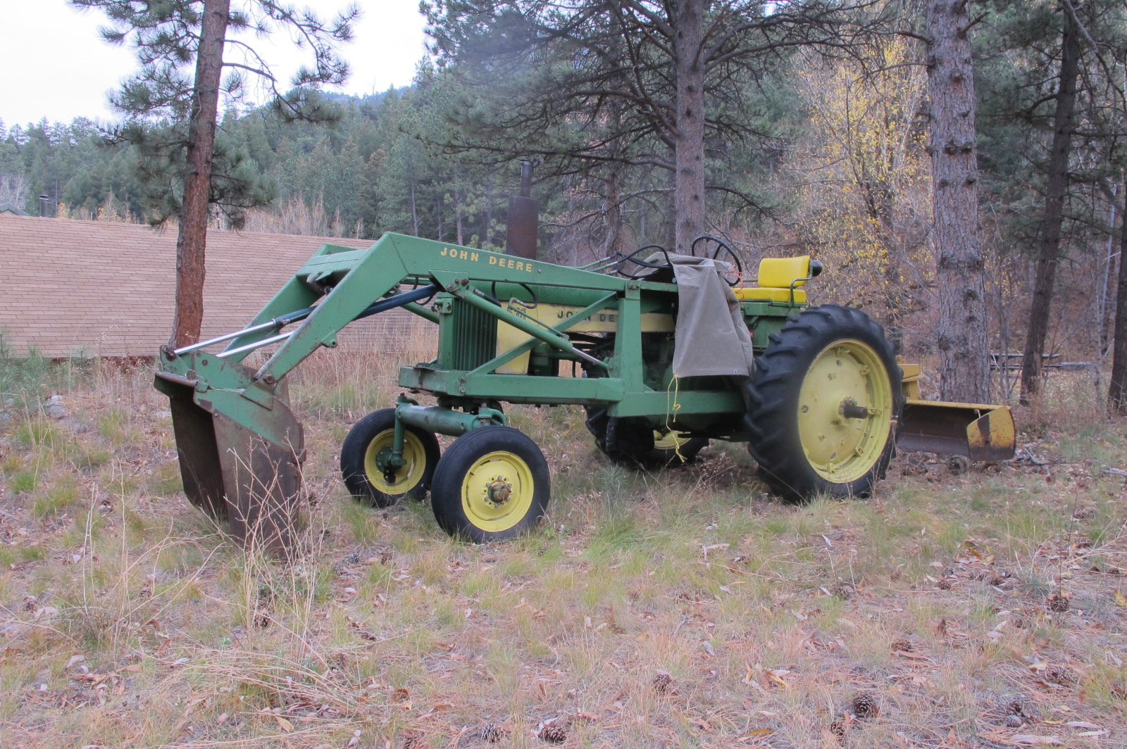

I don't know anything about your tractor other than it has 70 hp., but when I put a set of 15" chains on the front of our John Deere 530 they didn't seem to help much at all in the snow.

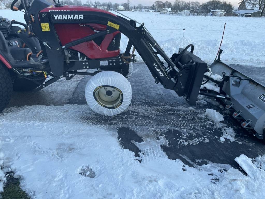

I have an issue with CUT (Y 424) when pushing snow in floating (blade is on FEL). Sometimes snow is so heavy tractor's front tires start to lift. I have no traction problem at rear (with turf tires BTW) but basically tractor becomes un-steerable (IDK can I use such word). I can just point and shoot straight
I cant use very aggressive chains as all my operations are on asphalt / concrete
So I have got "snow socks". For front axle only
Cant say it miraculous solution for all your problems. But it improves a lot
Big Q is about how long they will last. That I will say you in April
And another big "+" is - they could be put on / off in seconds, without tools, anything. Just push up front and put them on, literally like socks
OK when snow is very wet, that doesn't help much as front tires are in the air completely. Bot it allows to extend use of floating for a good while

I wouldn't use float then, obviously there is too much pressure on the FEL and it need to be lift up, unless you want to scrape the snow off then that's good but if you want to turn then you need to find that middle ground between blade ground contact and front wheel pressure / friction.
