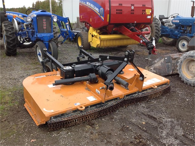

newer bushhogs uses something similar.

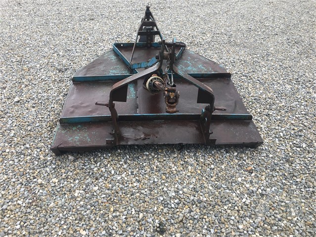

And still some cheap cutters have nothing and bend the straps like this one img (1).jpeg

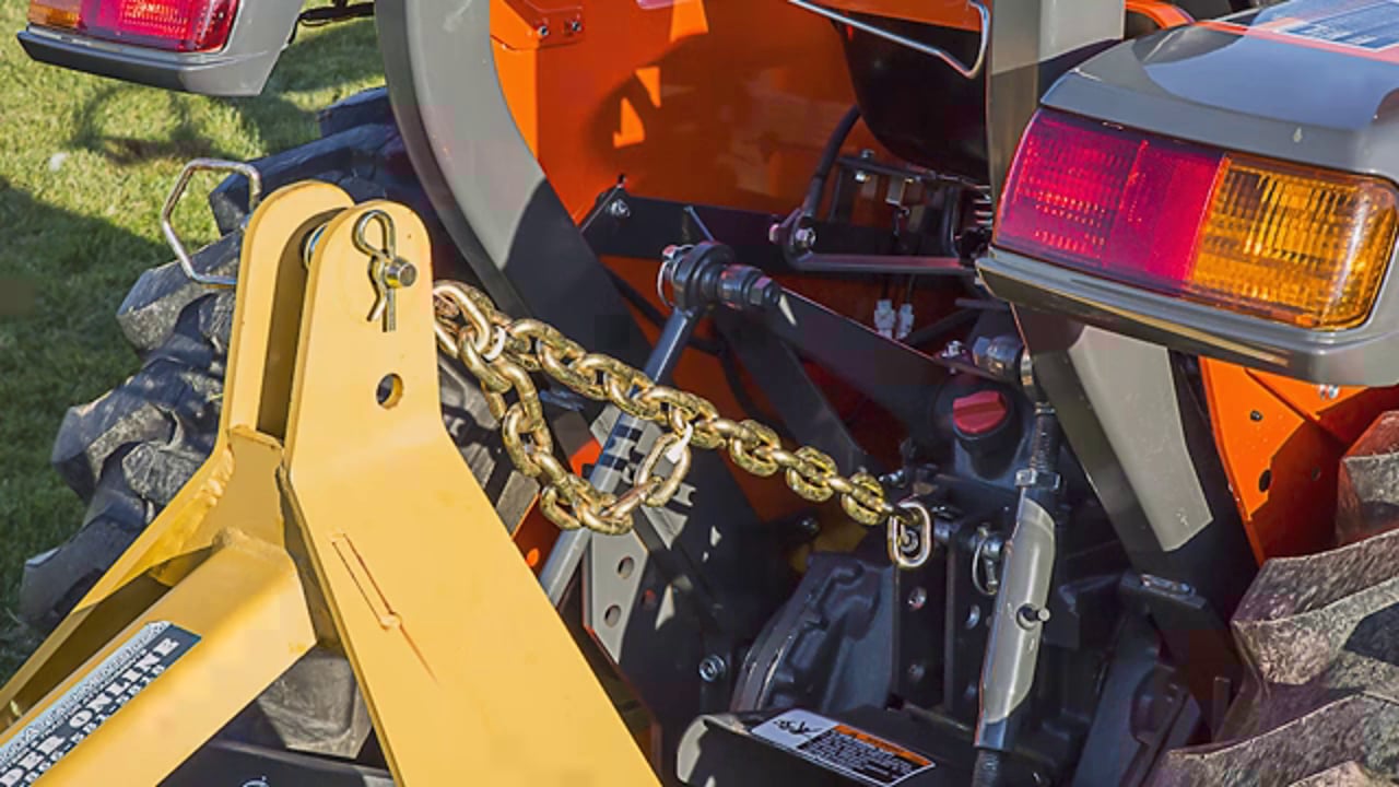

That second picture is the one people commonly just run a chain for a toplink. Because it is simple and easy to do.
If you replace the lower bolts with shoulder bolts, or a bolt and locknut that isnt torqued real tight, or a castle nut and cotter pin, etc.....that allows the cutter's a-frame to rotate. THEN you can remove the straps that are all bent up on the cutter and replace them with chain.
At the end of the day, there is more than one way to accomplish the same end goal. And I really wouldnt point to one being superior to the other. Just dont confuse a chain in place of the toplink as meaning modifying the cutter with chains to allow the a-frame to pivot. Two totally different things to attain the same end result

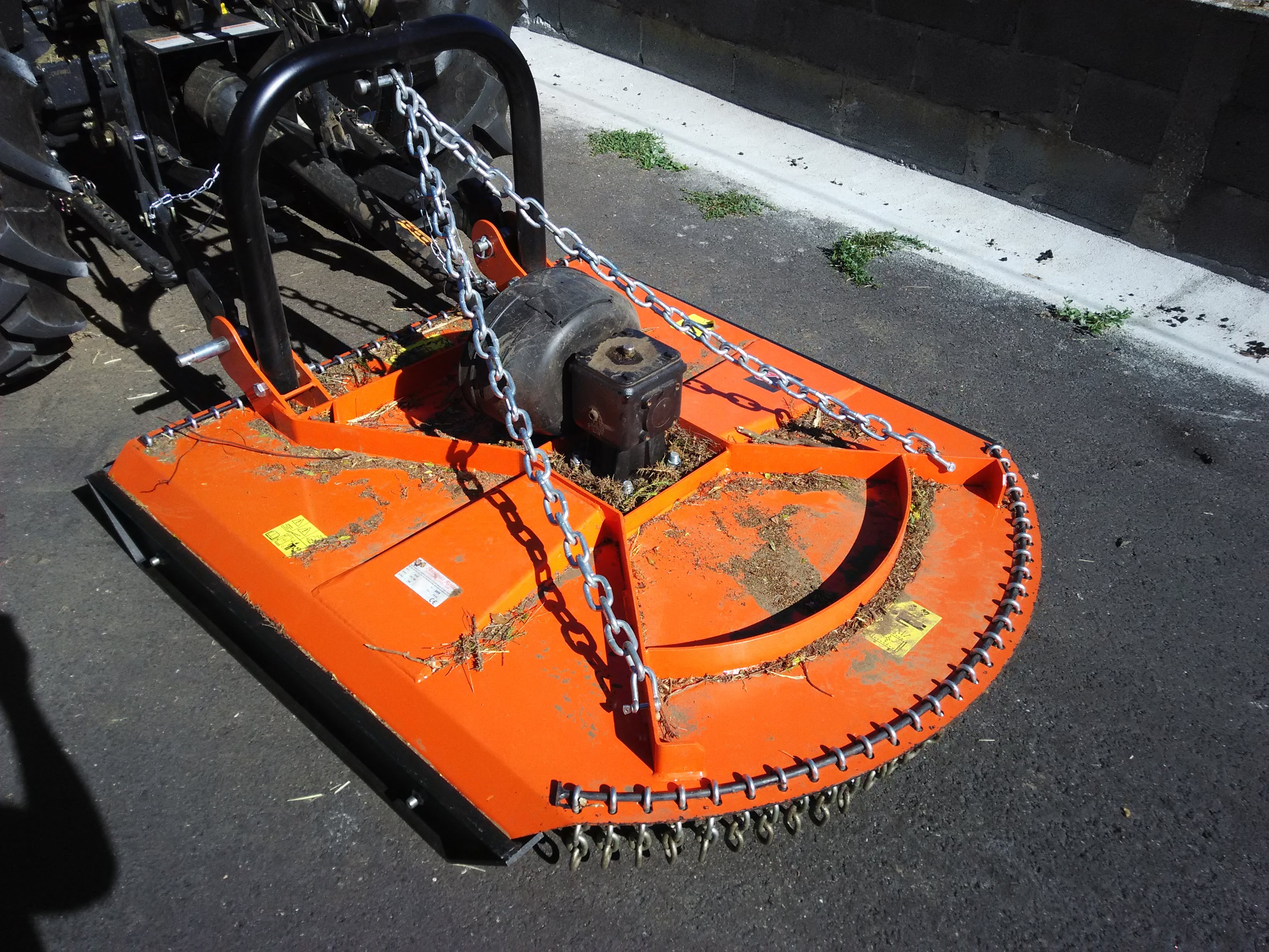

Chains on the top link frame to the rear of the mower or chain on the top link will do exactly the same floating effect... I've never said it was the same thing!

This WHOLE THREAD is about using a short piece of chain for a toplink.
And your FIRST POST IN THIS THREAD IS:

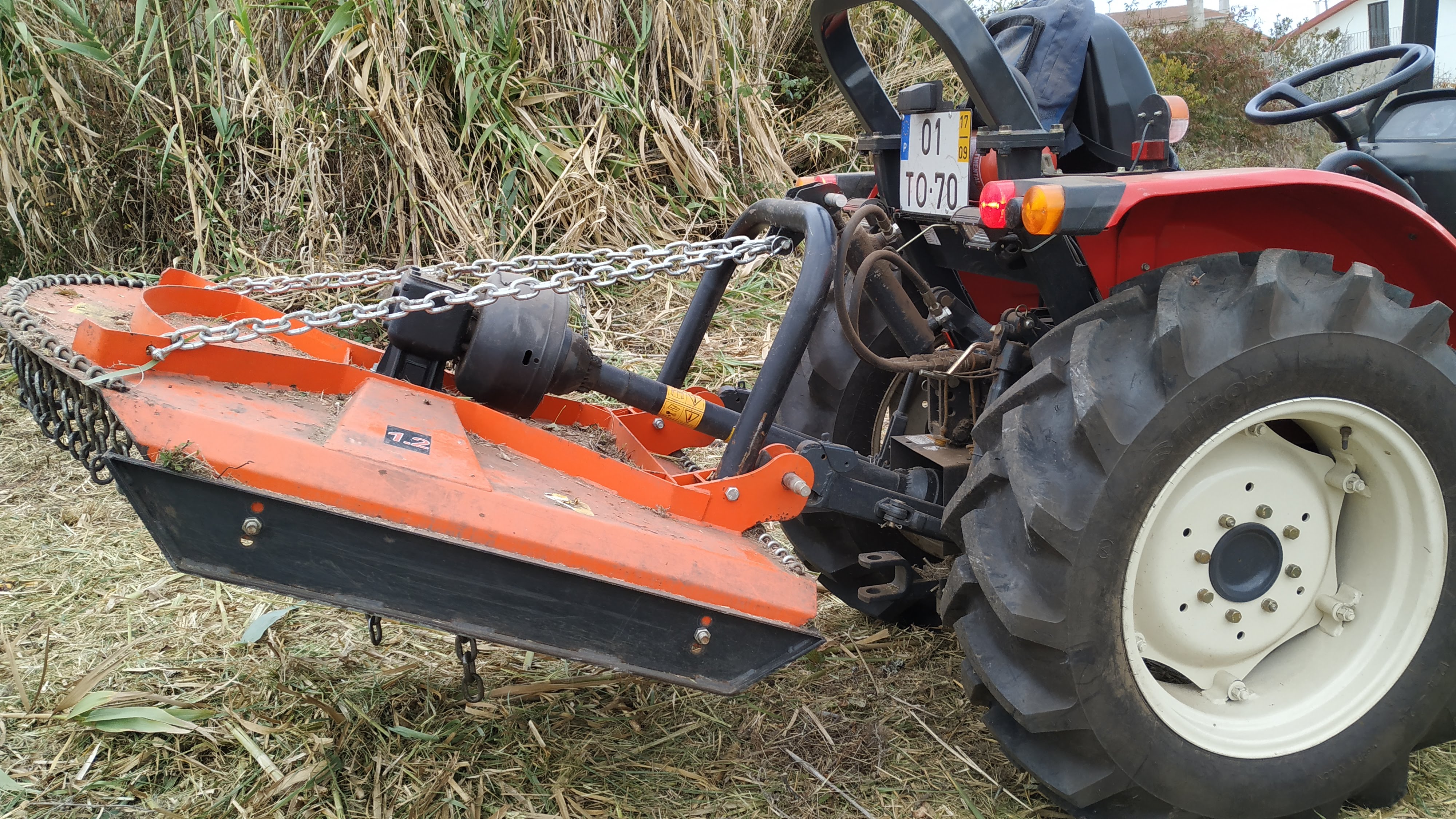

Very common everywhere else in the world. And also chains as cutting tool instead of blades.

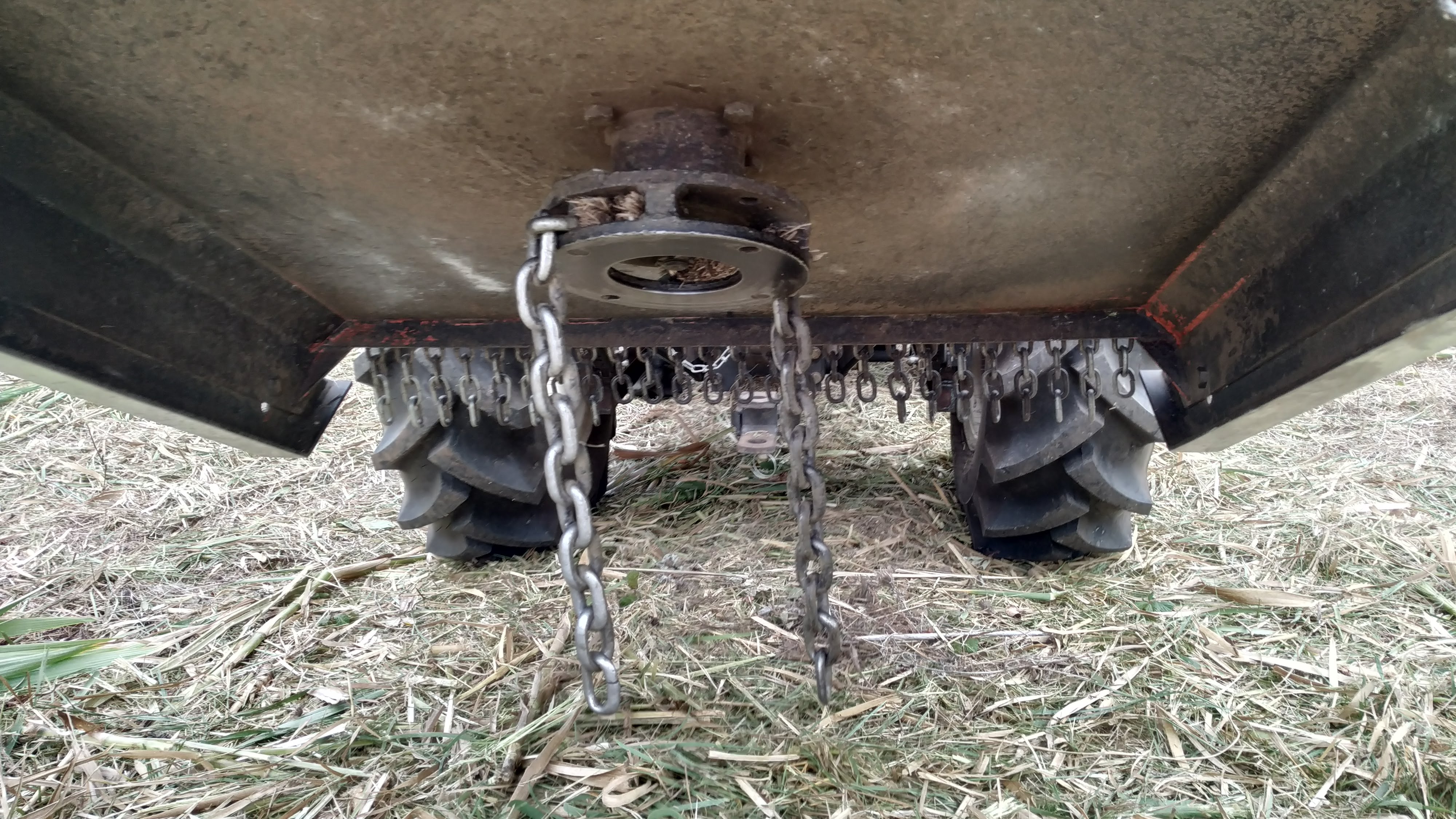

View attachment 644812View attachment 644813View attachment 644814
IS that not implying that the pictures you attached....stating its common elsewhere in the world.....is of a chain for a toplink?
To which....I simply replied that NONE of those are of a chain for a toplink. Then you got all butthurt because you were corrected. And have been trying to defend your position every since. Which I have no clue why I am wasting my time with you. Because I have explained several times already....that there is more than one way to accomplish the SAME THING. Yet you still seem h3llbent on trying to prove something to me? Let it go. You posted pictures of your cutter with a hydraulic toplink. I said that it aint no chain for a toplink. Whats the problem? What part of anything I have said is incorrect?

I read threads here on TBN about using a chain instead of a top link on a slasher, and thought it would be worth trying.
However when I looked at my slasher, I realized that it already was setup to achieve the same result (mine is set up as shown in the first link).
But the important part that I was missing was the need for a gauge wheel. Once I had installed a wheel, it was easy to get a consistent cut.
I now lower the slasher onto the wheel and then a little bit more so that the slasher is a little lower at the front and the chains are a little slack. This works well for me anyway.
