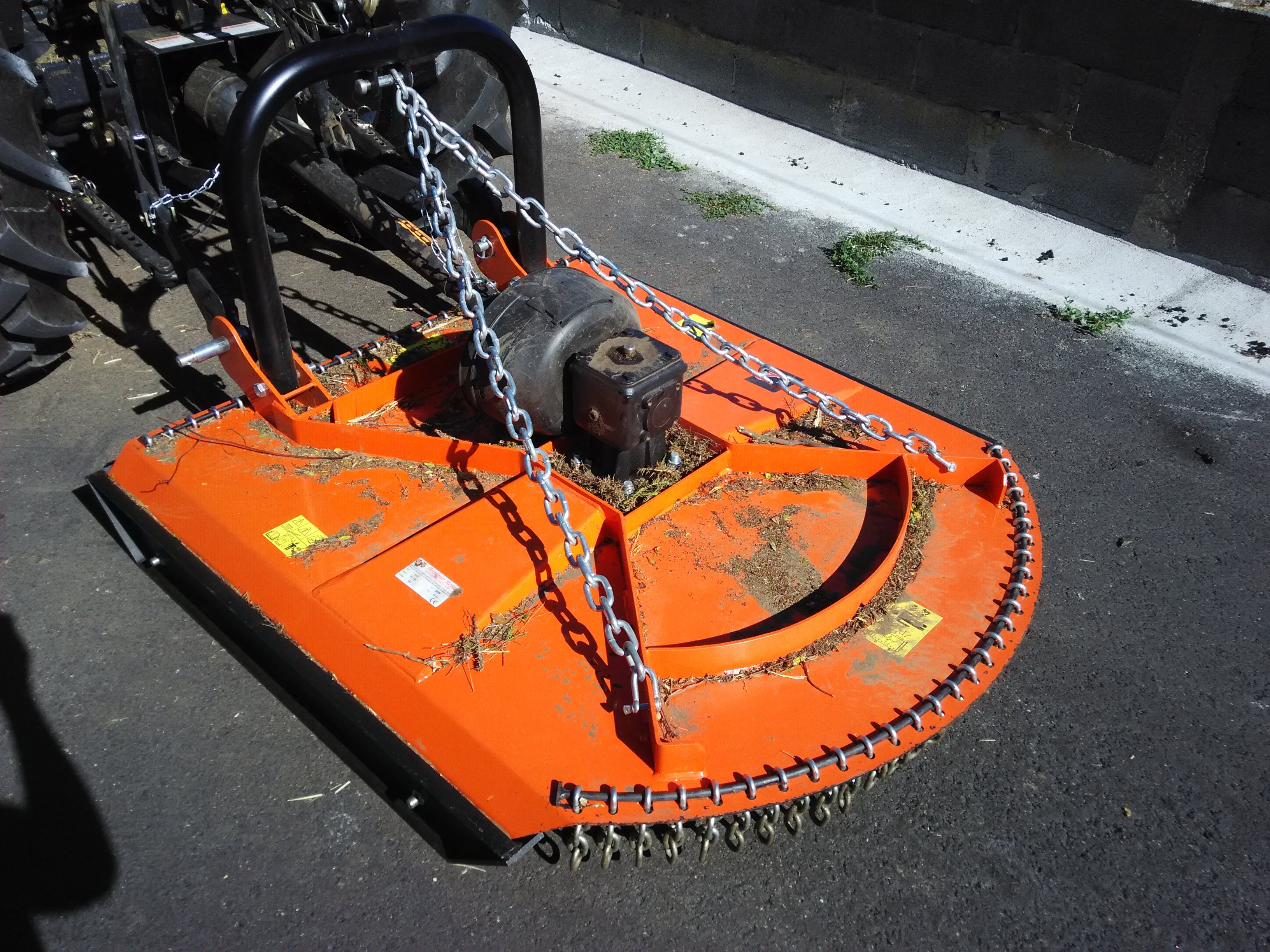

Chains seem to be standard equipment in Australia, where the implement is called "slasher."
https://duckduckgo.com/?q=tractor+slasher+&t=ffsb&atb=v169-1&iar=images&iax=images&ia=images
Bruce
M.K.Martin builds them. I've had one for over 15 years - works well.
MK Martin | Pulsar

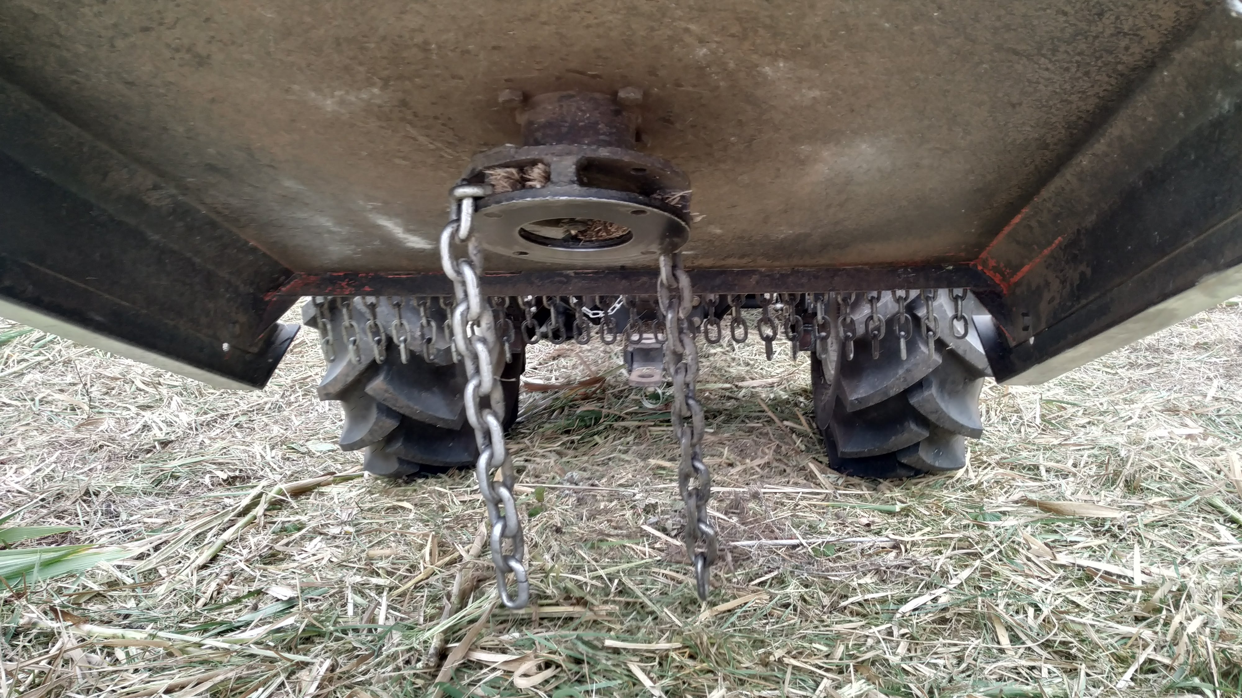

I read threads here on TBN about using a chain instead of a top link on a slasher, and thought it would be worth trying.
However when I looked at my slasher, I realized that it already was setup to achieve the same result (mine is set up as shown in the first link).
But the important part that I was missing was the need for a gauge wheel. Once I had installed a wheel, it was easy to get a consistent cut.
I now lower the slasher onto the wheel and then a little bit more so that the slasher is a little lower at the front and the chains are a little slack. This works well for me anyway.
