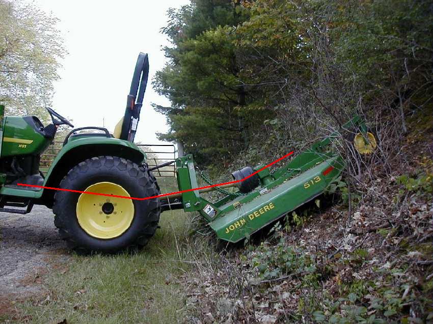

Can't remember which TBN member's this is:
attachment.php

i bet them u-joints love that angle.. :)

If you look at the PTO-shaft-to-gearbox angle & the PTO-to-PTO-shaft angle, neither seem all that extreme to me ... ?
attachment.php

If you look at the PTO-shaft-to-gearbox angle & the PTO-to-gearbox angle, neither seem all that extreme to me ... ?
attachment.php
Looks like a great way to save a set of lift arms. This method (chains) appears to be more forgiving...

THAT is exactally why I like the chains.
And I'll second that the driveline angle doesnt seem too extreme to me. The thing isnt a drive shaft. It is only spinning 540 RPM.
Look at the range of angles a PHD has to go through:confused2:
In a case like that picture, with the equipment on hand, I see no other way to cut that steep hillside. (maybe the OP doesnt have $3k to plop on a sickle). And cutting that hillside would be nearly impossible with a ridgid setup and a LOT harder on the 3PH and a-frame of the bushhog

I agree that constant use at those angles would result in increased wear and a shortened lifespan of the U-Joints, but I doubt these U-Joints see more then a few minutes of operation at that angle during mowing. The U-Joint life might be reduced, but I'd guess they'd still last for several mowing seasons before replacement becomes necessary.
Just my opinion...
BTW, the recommended maximum angle for U-Joints is about 15 degrees and the articles I read that in were discussing pick up trucks with lift kits.
