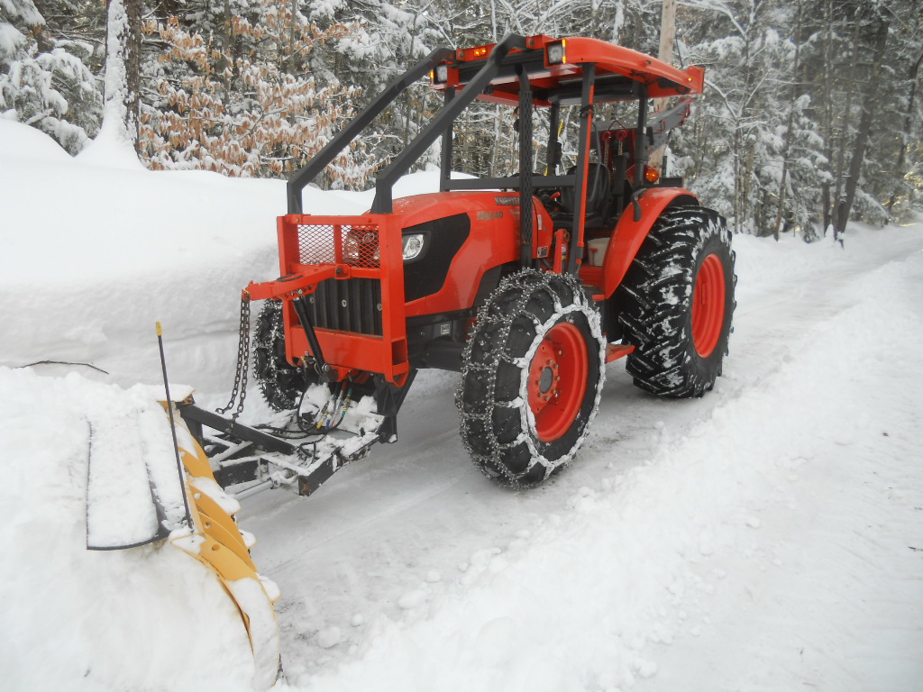

I have to think that any wive's tales about tire chains on the front being bad for the (driven) axle has to be from poor judgment or abuse by the user. Simply plowing snow that is fairly light as compared to digging and lifting a bucket of dirt in the dirt, that is as common of a task for a tractor. Similarly as with a properly ballasted 4wd tractor pulling a heavy set of plows. With a layer of packed snow or ice (on a driveway) that many of the northern state's accumulate early on in the winter season, with any type of hill or slope, chains are a big help, and with ALL tractor/machinery operation, there must be common (machine) sense applied.
I run these "ice chains" on the front and I swear their actually ice magnent's, with nothing on the rear's and have some pretty good hill's that I need to make the first pass, up hill.

Rustyiron, those are surely nice ugly looking chains.
