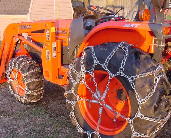

I have chains on both front and rear on my L3430. First winter 03/04 I didn't use chains, worked ok (I have a rear snowblower), but I did notice the front sliding a lot under certain snow conditions.
So I bought front chains from tirechains.com. Then I read on TBN about possible stress, etc. So I bought rear chains also. Most of the time when I snow blow I still use fwd. Still get some slippage even with chains, seems to be fine on the fwd.
I have photos.

Second Photo.
I am going to remove the overlapped links on the rear wheel chains. Rides kind of lumpy on the road. Don't notice it in snow.
Also I need chains for when the snow is deep (2 foot or more) out in the field.

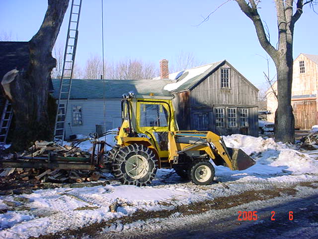

I have a Cub Cadet 7275 with a loader on it. I run turfs on the rear and industrials on the front. I have a set of double ladder chains for the rear. I too was told not to run chains on the front tires. The fornt ends of these small tractors are not built to take a lot of stress in the gearing. Look at the size of the front shaft. It's nothing more than a toy shaft. I would hope that is the weak point and not the gears in the axle housing. To me it's not worth it to find out if the chains will be better. I have more than enough traction with just the rear chains and industrials on the front. I also keep my grader blade on in the winter for weight and for scraping my driveway after it snows.
