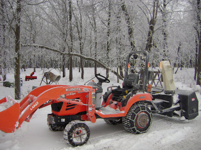

In a word "YES".

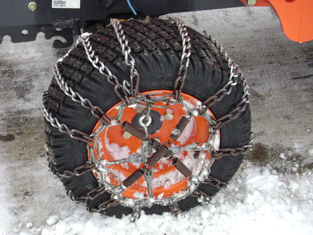

Does anyone make chains that will fit without cutting the cross links?
/ Chains up front #18
It's too bad Kubota won't give a yes or no on the front chains. My friend has a MF the same size as my bx. He asked MF last year about front chains. They told him it would be fine.
Yes Allis does market these chains for the rear wheels on their little ten horse garden tractors. Thats what I used on the front of my bx, the width was just fine and all I had to do was remove one section of side chain which included the one section of cross link to shorten it down. Perfect fit with two link spacing. The chains that I put on where well over twenty five years old and still showed very little wear unlike the four link Chinese chains that I have on the rear and I bought last fall.
