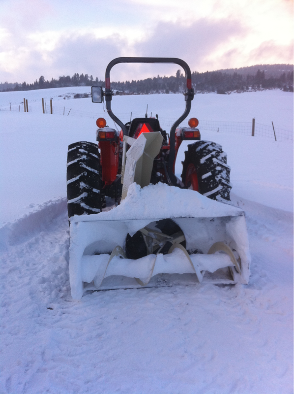

I would 2nd the comments about chains on pavement: this is a bad idea. You will tear up the driveway in short order.
The solution is a blower.
I use to have trouble without chains and a blade, but now that I have a blower I never use chains. And my drive is 15 degrees and 1000 ft long and it takes about 20 min to cleanup without chains.
Also this is an above average snow area. My front yard currently is buried in ~4 ft of snow, and 2 to 3 ft is common.

Agree with GotSnow. 7 years with blower and I have no need for chains in Minnesota. If I begin to slip I put into 4WD. It's cold and 2-3 feet of snow.
