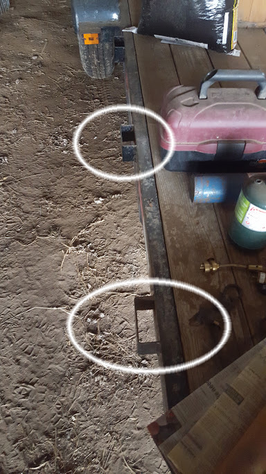

I have a 5,000 lb tractor (actually 3,000 + Loader + Rear Attachment) when fully loaded. My trailer has dual axle 7,000 lb capacity. My question concerns the tie downs on the trailer. I have attached a photo showing what's available to attach the chains. Are these adequate and designed for securing such a heavy load?
/ Chains VS Straps #24
Your side pockets look pretty thin and appear to be homemade. They look like 1/16" thick pockets that may hold 2x4 wood. The stake pockets on my trailer are 1/4" thick. and are designed to be used as a tie down point for my chains. Pics can be deceiving but if yours are only 1/16" thick they are not strong enough to secure a tractor. Tightening a ratchet binder would bend them easily.
/ Chains VS Straps #25
I wouldn't trust those. Can you weld? I would buy some d rings and weld them on to attach to.
/ Chains VS Straps #26
I'd use those with chains in a pinch. But I would run the chains across ALL THE WAY UNDER the trailer so the pockets were only a guide. And I would have to make sure it didn't interfere with anything under the trailer.
/ Chains VS Straps #27
I agree, they look thin.
As for your trailer its probably got 3.5K axles for a 7K load. That includes the trailers weight so it's more like a 5.5K payload once you deduct the trailers weight.
Chris
/ Chains VS Straps #28
Thanks all for your objective responses. I will measure the thickness. I do not trailer my tractor very often -- a few times to the dealer for work and to another property once in a while. Both short distances. They haven't deformed when I ratchet everything down but I have always been skeptical of these securements. I also drive like an old lady when pulling my trailer!!:laughing:
/ Chains VS Straps #29
I like newbury's idea in a pinch. Throw a long chain under the trailer and pull each end through those pockets and hook each end to the tractor. Not ideal but would be better than the pocket alone.
/ Chains VS Straps #30
I would only make a WAG but I would think they are 1/8 inch or a bit larger but in any event lighter than what I would feel comfortable in using unless it was a light load. I would rather have to heavy and not need it than too light and regret it.
