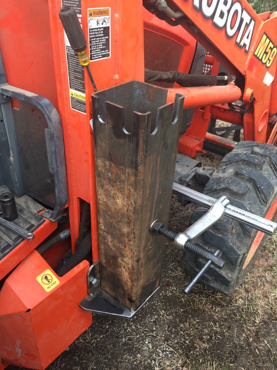

Gleaned lots of good ideas from this site. Building what hopefully works for me given skills and materials around most farm shops. Going to document as it evolves. Comments welcome.
Plan is to attach a steel tube to the loader upright. 6x6x26.5” drop from scrapyard. Chain hook and drain holes cut.
0.5” plate cut and notched for bottom.

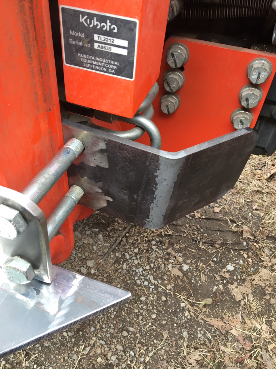

3/8” plates cut to sandwich around the loader upright. The inner plate cut long and going to bend to make a bash/skid plate for some lower hydraulic lines.
Progress so far. Will update as it goes.

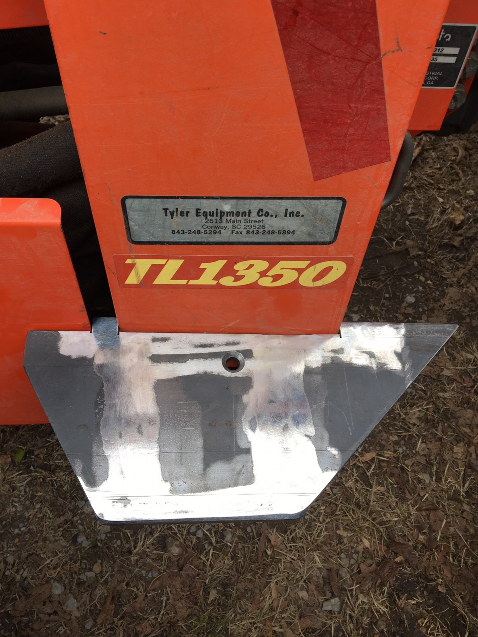

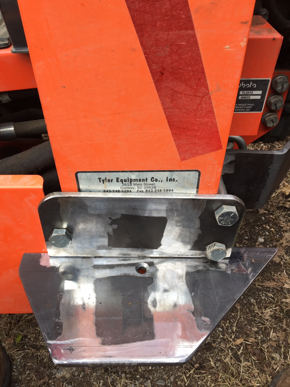

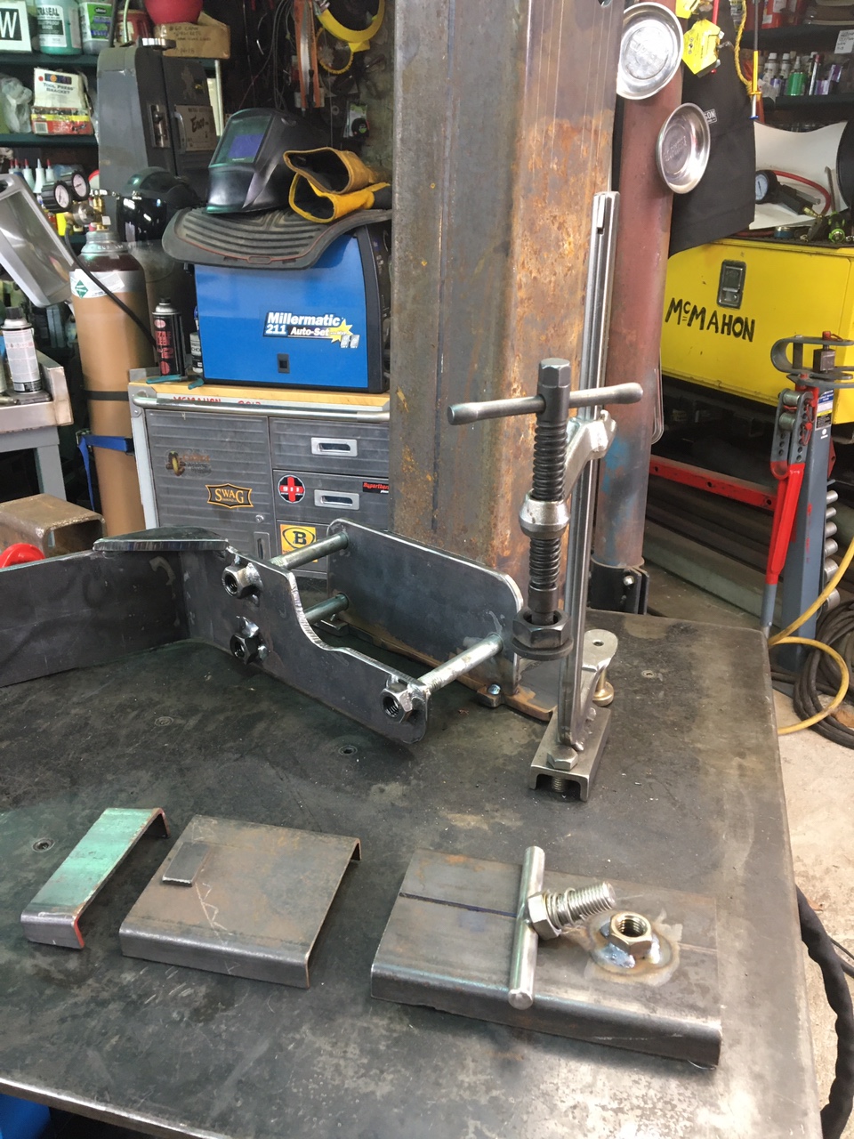

Time spent fitting the lower mounting parts. Usually I would weld instead of using bolts. With all the hydraulic lines and maybe needing access later making the attachment bolt on and removable. 3/4” bolts, notching and heavy plates for when trees or stumps might challenge the attachment.
Bottom plate. Notched to loader upright.
The back plate took some cutting and notching to clear a hydraulic mounting valve block on the back side of the loader upright. Then I was getting fancy and welded the nuts to the plate because of limited space for wrench. Senior moment...welded the nuts on the wrong side! Two steps forward, one step back.

Aah - now I see what you mean by bash plate to protect hydraulic lines. Good idea. If that is the drain hole and it were mine I would need it bigger. There is no end to the debris that ends up in the bottom of a vertical tube exposed to the elements. You might need to get a screw driver or pick to get up in there to loosen it and you want the stuff to come out the bottom hole maybe. We also have ice. Just something to think about.

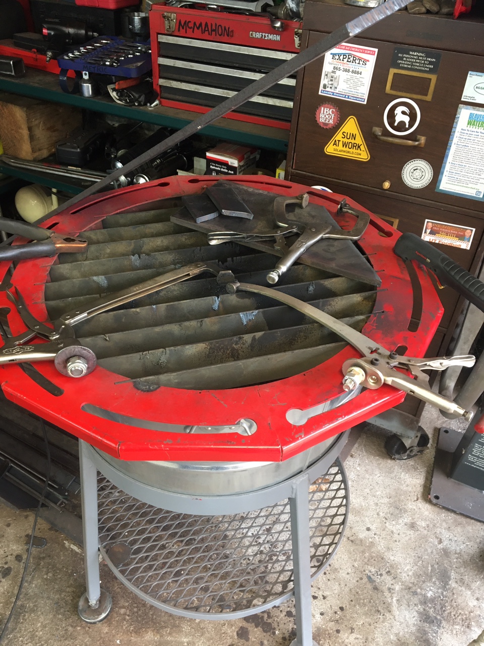

The 6” tube has three 1” half circle drain holes where it will be welded to the base plate. The pneumatic radiator cleaning wand hopefully can blow out stuff that collects inside.
Making another back plate. Hope the nuts get welded on the right side this time. Made the bash plate 4” longer.

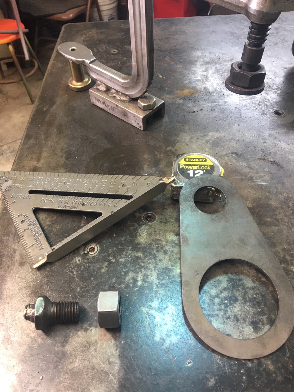

Several of the tools used.
Tapered bolt to clamp and center nut on hole for welding. Modified speed square for plasma drag cutter. 911 MotorSports hole template for plasma cutting holes. The 3/4” bolt holes are plasma cut.
They make this wash tub plasma cutting topper too. Makes cutting and shop cleaner.

Had a little time to test fit and adjusting parts for best fit and function. Taking time to think before final welding. The bash plate to help protect the front hydraulic lines worked out. Might weld a plate, fin, to the bottom plate to better protect lower sheet metal guard? It’s about a 6.5” drop.

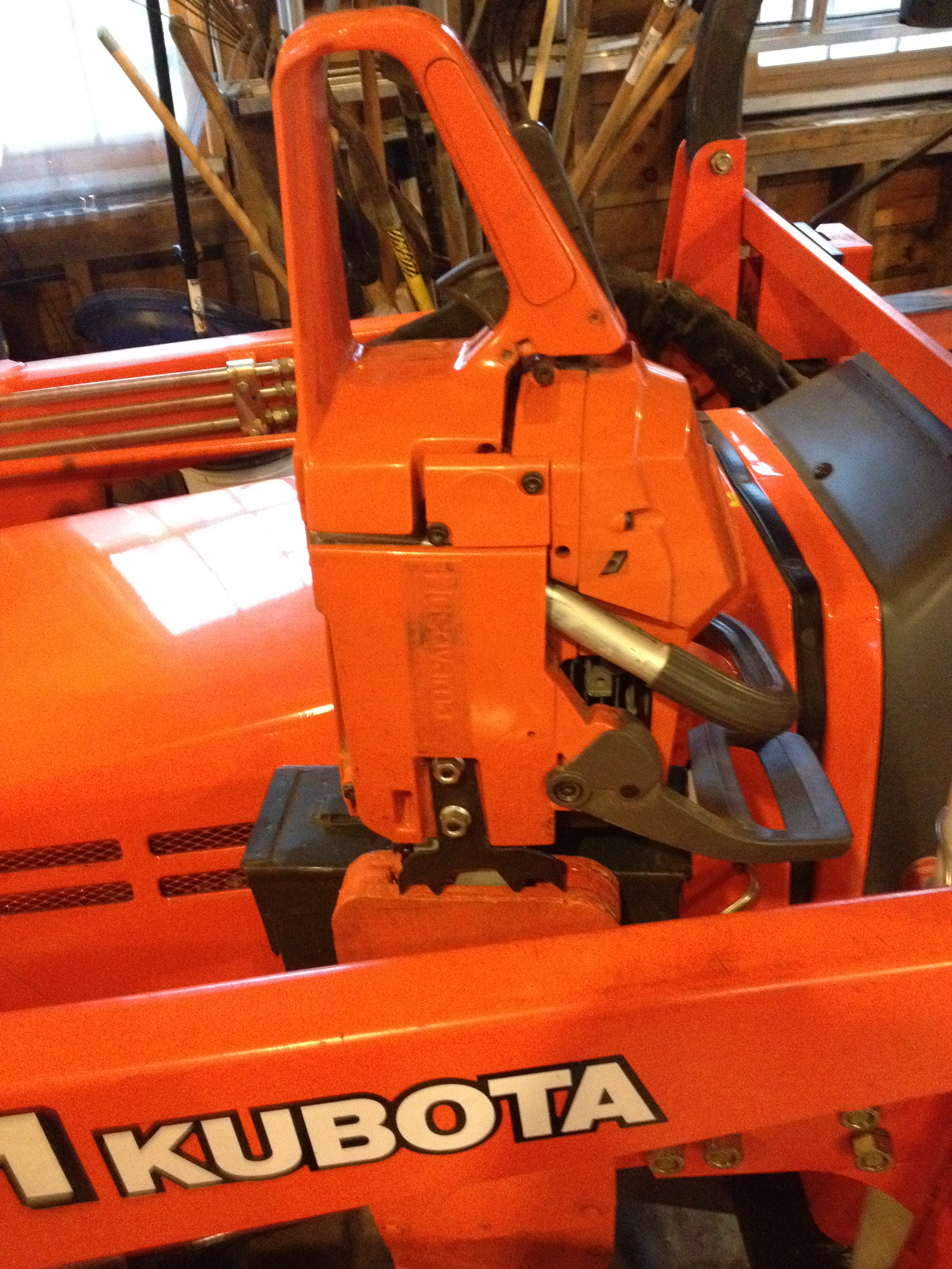

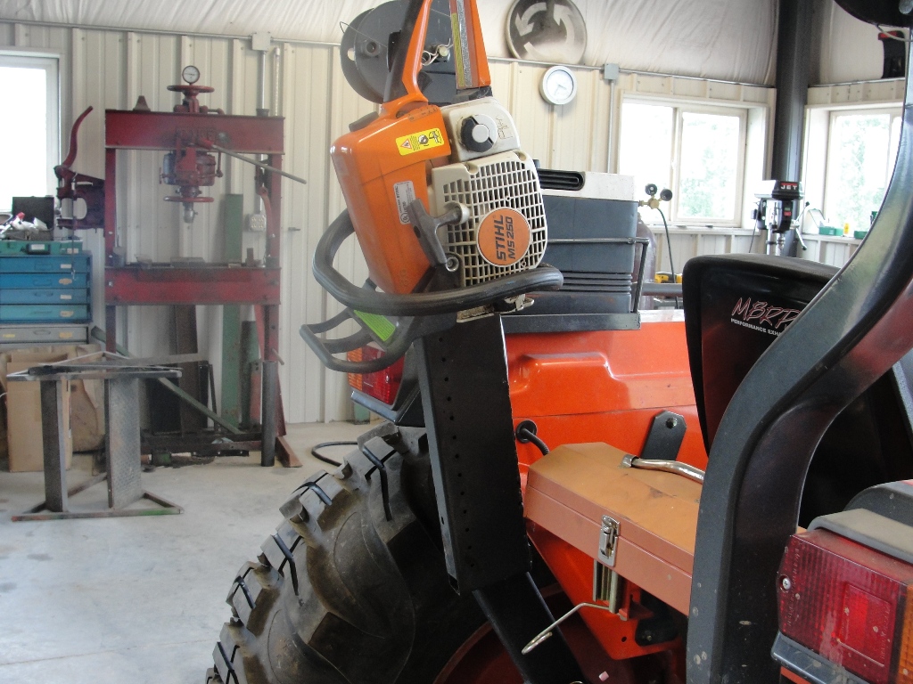

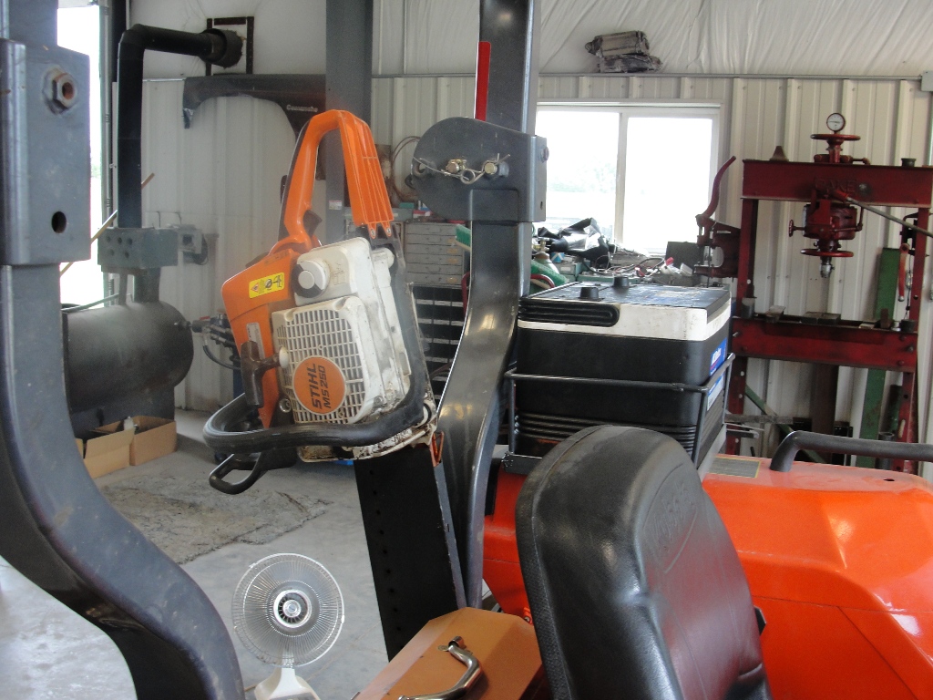

Diesel Crawler - You mean like this cobbled together setup on my B21 - it works though!

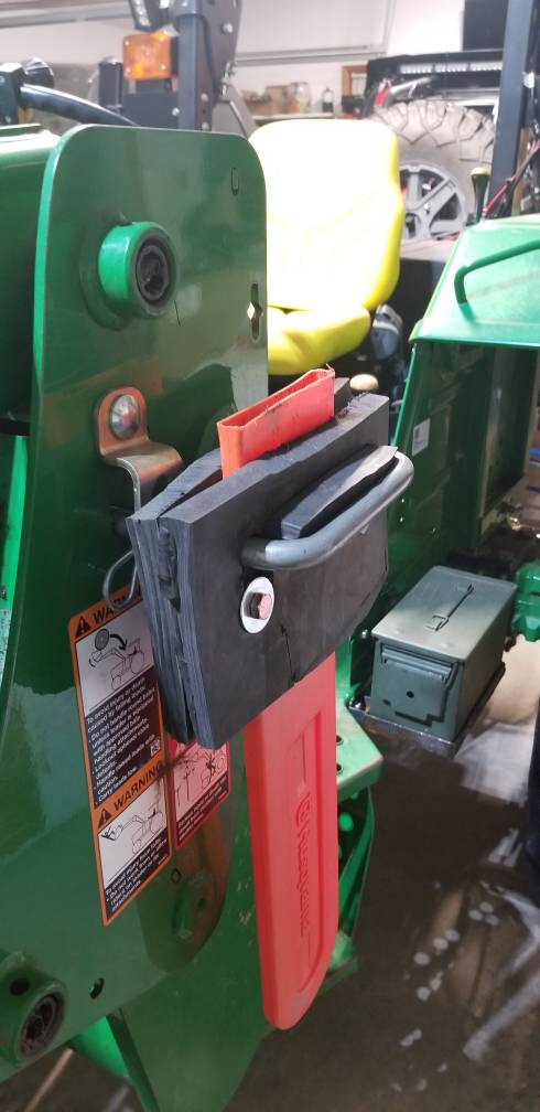

I wanted a chainsaw holder for a "new-to-me" trailer I bought last year,,
I decided rubber would work better than other materials,, the best part, it was done in 30 minutes,,,
The holder fits any of my saws, even the Stihl 660,,,
/ Chainsaw and chain holder #13
Yours is high class...you even painted the plywood! Mine, made out of plywood, and exposed to weather because the tractor hasn't been parked inside the barn in 2 1/2 years due to a truck project taking up inside space, is looking quite sad.

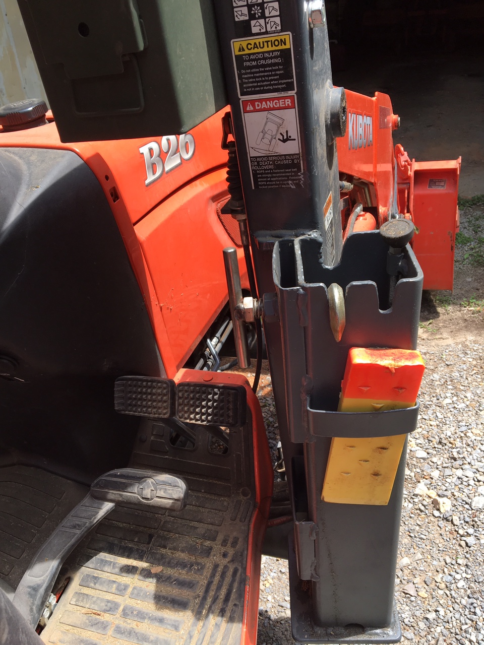

#15
With our farm the use of tractor, chainsaw and chain together very often thus the need to safely carry.
First gen saw/chain holder with Kubota B26. 5x5” steel tube, 1/2” bottom welded to loader upright. Note alignment of tube to loader frame for clearance issues. Can clamp saw up to access chains. Has worked very well for a small tractor. Took less time to fabricate, but each tractor is different.
