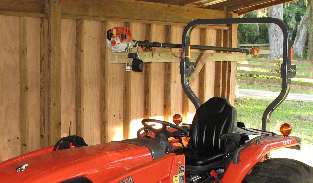

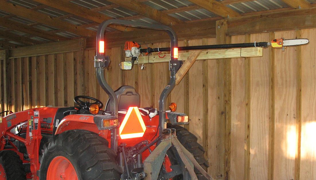

Here's mine, not painted yet:
attachment.php
attachment.php
